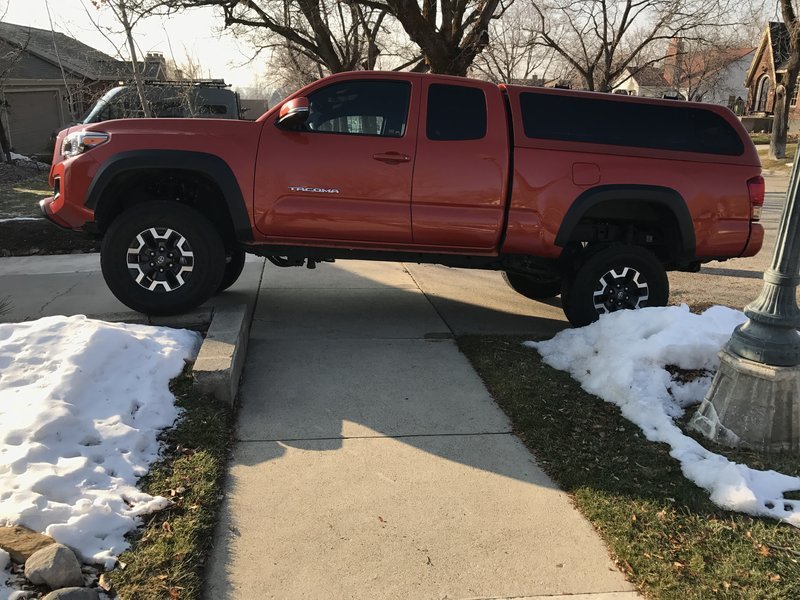

    24 Off Road long bed Premium Taco.
    OME 888 nitro front, SPC upper arms,B110 rear shocks, Timberen bump stops, extended brake hoses, U bolt flip, sway bar delete, Dakar HD leaf pack with extra leaf, Snug top HD shell, MobTown Skid plate, cooper Maxx 255-85-16 4:88 Nitro gears,Spider trax 1.5 spacers, AirBedz, debadge, Pro grill.
    I have the 888 on my 2016 access cab.the 888 are 10mm higher which netted me 3inches of lift in the front.
    They pretty much max out the OME soft ride shock fully extended. They were harsh for the first 2000 miles. If I had some more weight on them they would be better. I got the OME rear full leaf pack too. In my opinion I have about a 1/4 inch bro lean with my shell on. This takes weight off the front which makes the spring rate too high. I plan to get some longer rear shocks and the OME special add a leaf for their spring packs, and longer rear brake lines to remedy this. But It already skipped leg day so 285 tires and wider rims first..

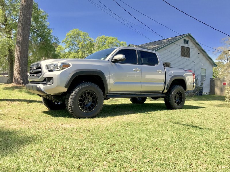

    Louisiana
    3rd gen 5100s with 888 coils. Perfect setup and amazing ride like everyone has said.

    Started with 3.25 lift it front and settled to a little more that 2.75. I wanted to maintain the stock ride in the rear so I used a 2" block in the rear. Ride is awesome the back is an inch higher than front.
