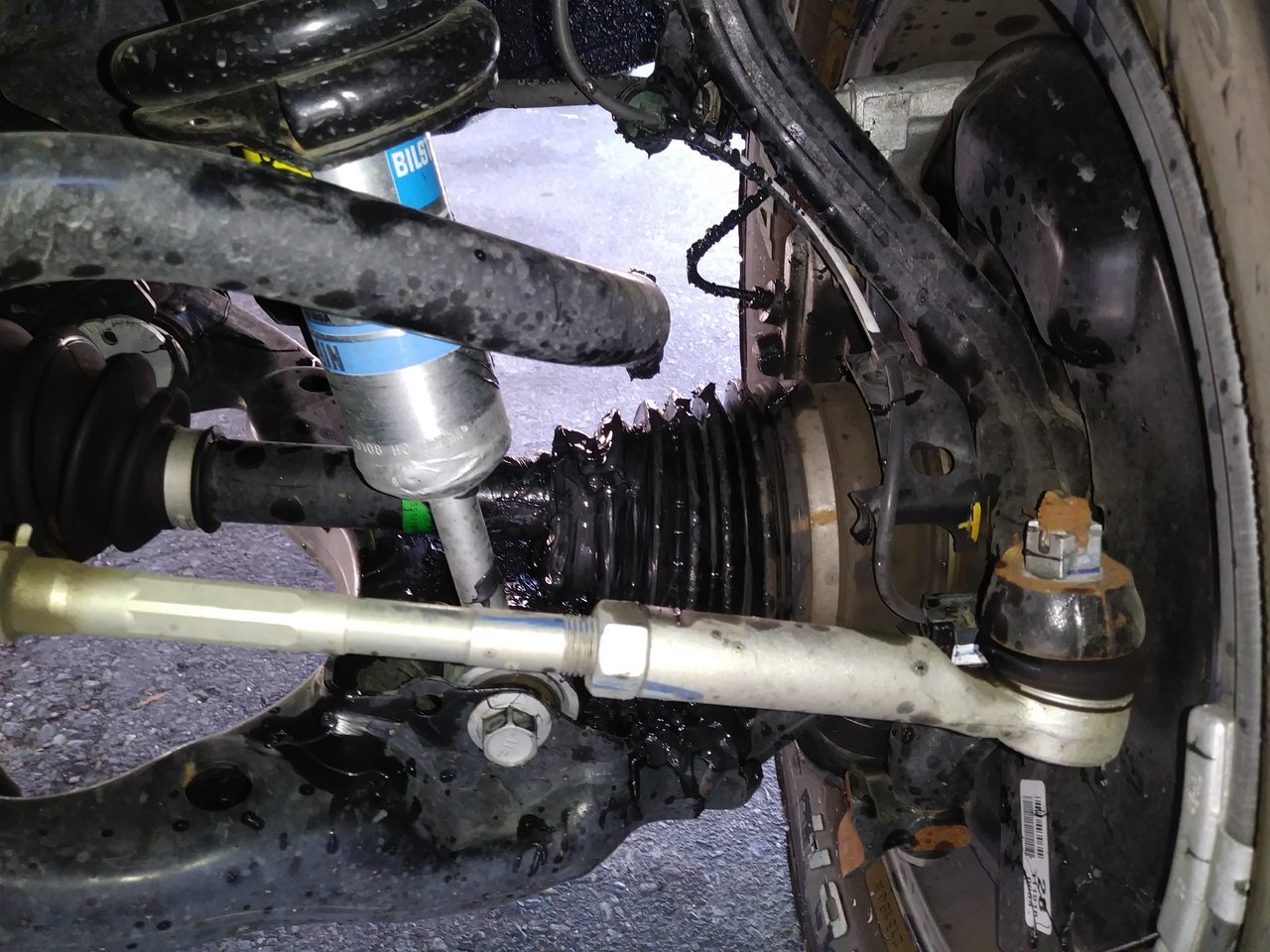

    Toyota new guy here......I am assuming it is not supposed to look like that with grease everywhere?

    Looks like the sway bar links dug into the cv boots.
    Either completely remove it or hook it up.

    DON'T do this .. it will put u at 24+ " up front. Looks amazing but the cv axles cannot last like this. After 10k miles my boots are wearing grooves in the fins and the boot is sure to fail any day. And this is zero off road 100% hwy. After replacing these boots the 1/4 top spacers have to go.
    Got these cv axles looking like a Polaris four wheeler axles...lol
    I miss my manual locking hubs on my 99.

    Would the diff drop help with this issue?

    Well what helps this situation then? As I thought 3" was max for our trucks without excessive wear

    The diff drop seems to " rotate" the diff and not really drop it at all.
    2016 taco sits 21" hub to fender.
    2015> sits 20" hub to fender.
    Both trucks have 24.5" of droop or useable down travel. Meaning if u rest at 24" u only have .5" of down travel left. [Pogo stick]
    23.5" is max for comfort and longevity. U want atleast 1" of droop.
