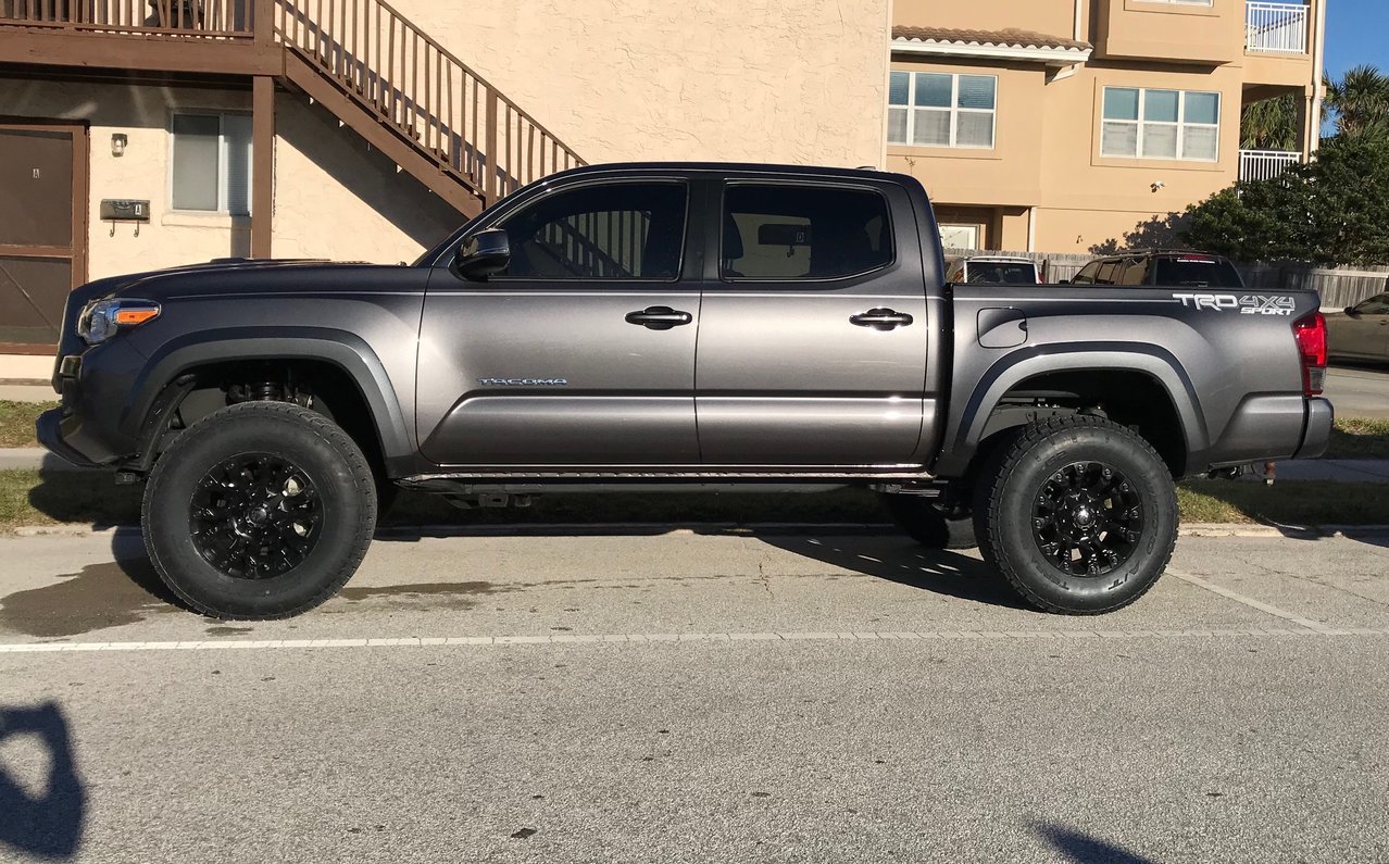

    But.. how... it can’t be. No trimming or CMC? Lol
    So majority of the members here will say you need to trim or CMC. What’s your secret?
    One of the members told me having a “0 offset rim” won’t cause any rubbing and no need to chop.
    This member also had 5100s with 17 inch wheels on 285 and zero offset.
    I might be going this route if that’s the case. I don’t mind the trimming but CMC is what I don’t want to do.

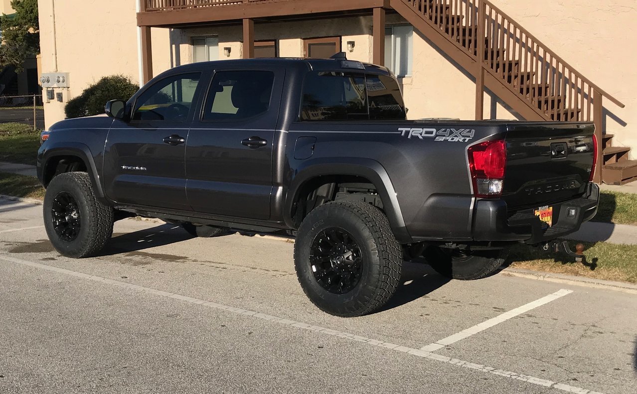

    Good looking truck. I'm about to do a similiar setup. Did you have much settling after it was finished?

    I did have some settling unfortunately; I plan on moving the 5100s to the .85 to try to correct the slight rubbing at full lock.

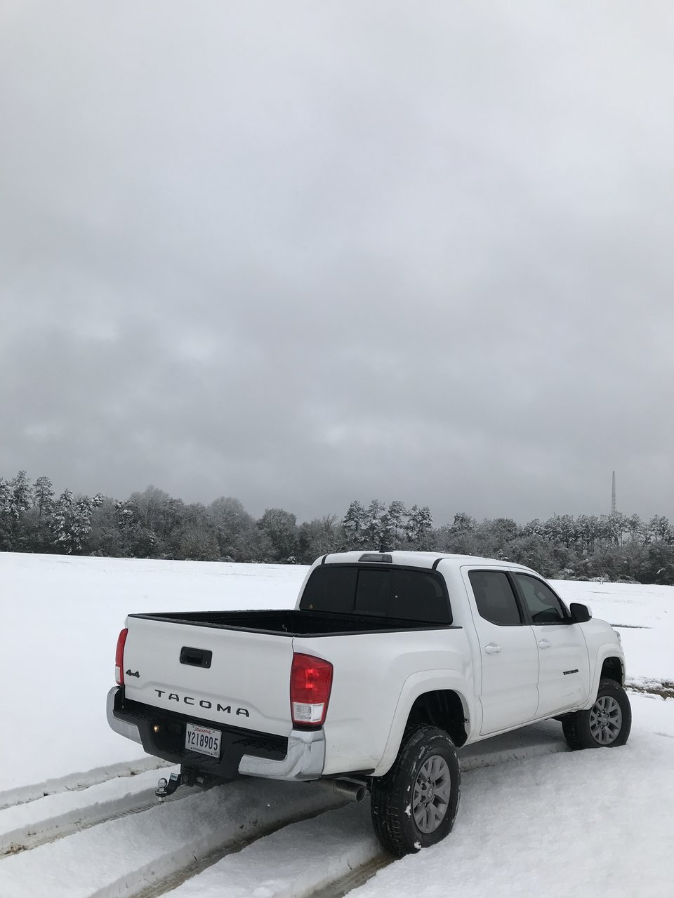

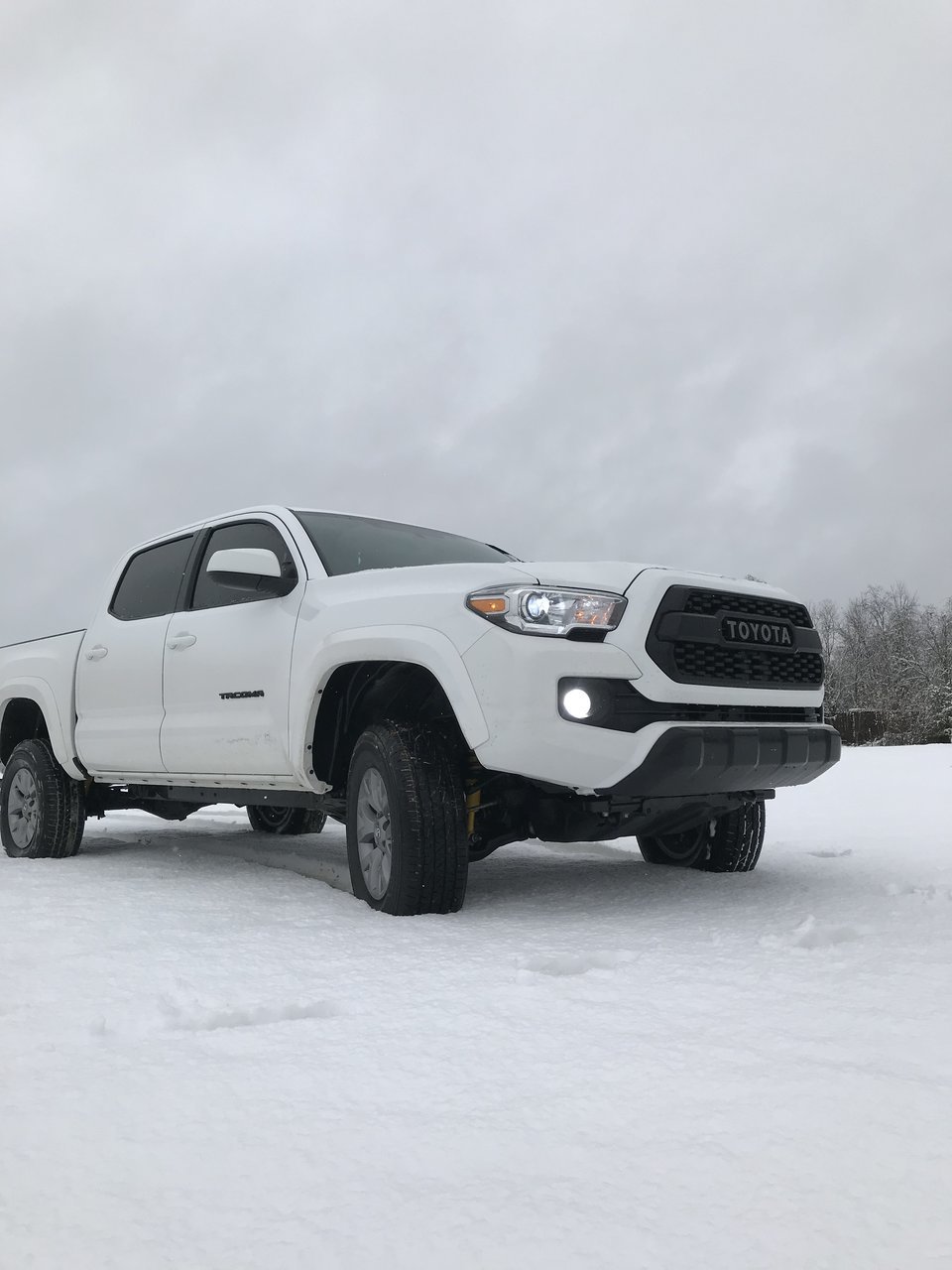

    I got the full OME kit stock load. 2887 coils on the OME nitro shock, full leaf pack and stock UCA’s, Rides great and am very pleased with this setup! Waiting for settling for rims and tires. I have about 1.5’’ rake and I’d like about a .5’’ rake (closer to a level lift) would putting a spacer on front struts be best option or with the OME 2888 coils give me about 1’’ without having to add a spacer? HELP!
    Btw I live in Louisiana and this is only the second time I’ve experienced snow in my life to I had to get pics lol
