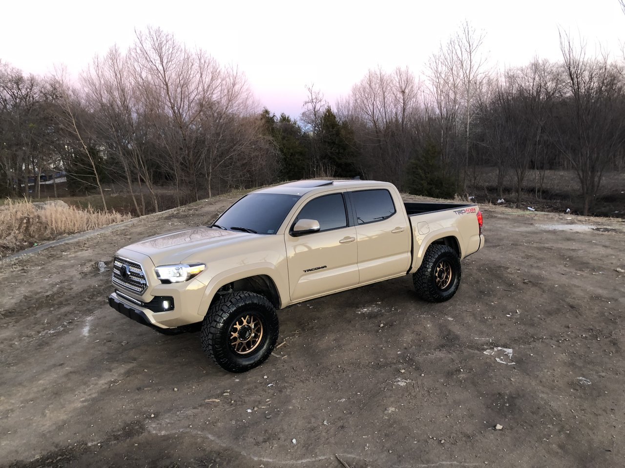

    I’ve got OME 888s with 5100s at 0

    That is a NICE ride.... Congrats!..….

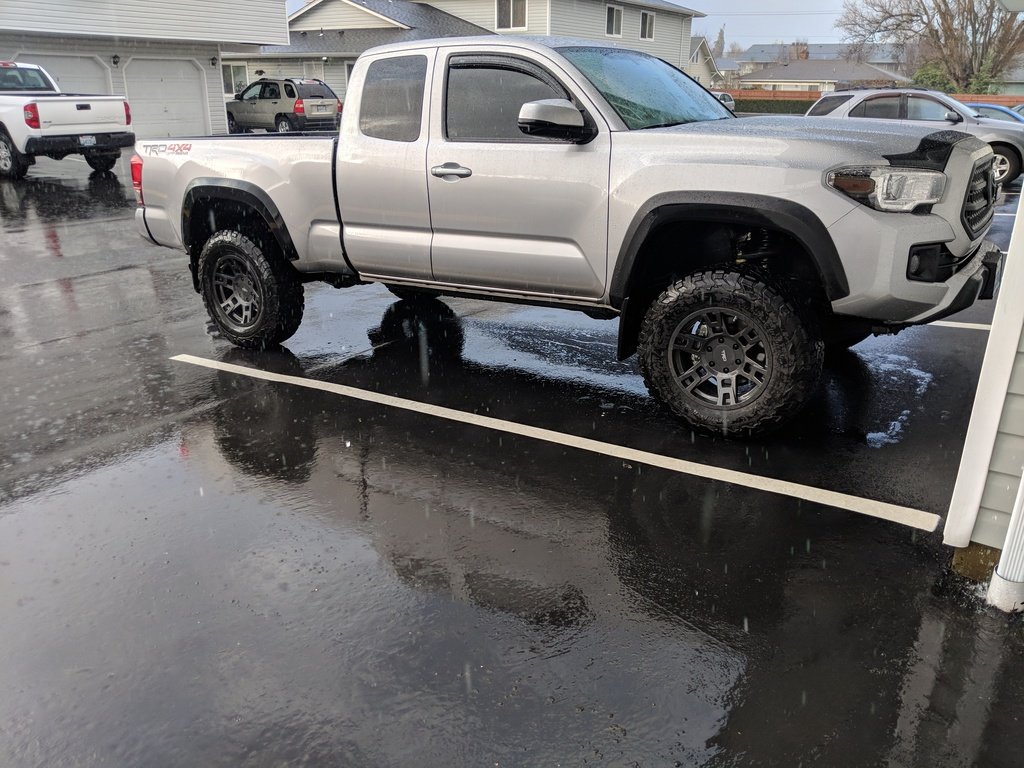

    Intstalled 888's today....I was running the 887's with stock uca's for the last 9,000 miles .it was manageable but I was never really happy. Today with the new coils , SPC upper control arms were installed and holy crap it is so much better . I see all the time that new uca's are not needed and maybe it's true , but these made a huge improvement . Installed the ECGS bushing as well.....

    Did you notice a change in ride quality, or just overall driveability?

    when i first drove it today i noticed the truck was confidently soaking up all the bumps. not a huge difference in height over the 887's...the driveability is more what i was hoping for and i got it
