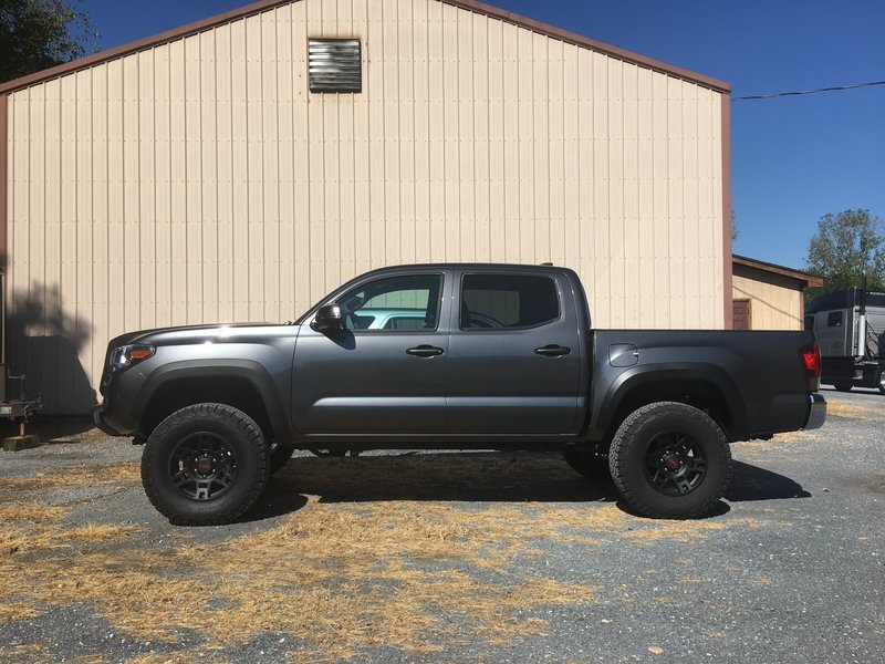

    888's bilsteins set to 0, rides good

    Is the truck level? Might just be me but it seems like the front is slightly higher...which is what I worry about if I go with the 888s will the rear Dakar be high enough?

    It sits pretty level, still barely higher in the back. I used hs 3 leaf aal. Eventually will switch out for dakars. I would like it to be a little more raked...

    Yep might have been that picture. I plan on putting Dakars so if anything and it is slightly higher in the back I'll be cool with that

    Can I ask what your hub to fender measurement is after the coil settled???

    Center of hub to fender is 24 3/8 on passenger side and 24 1/8 on driver side

    Factory ucas?
    Might have missed it, tire size?
    Rubbing?
    Looks great!
