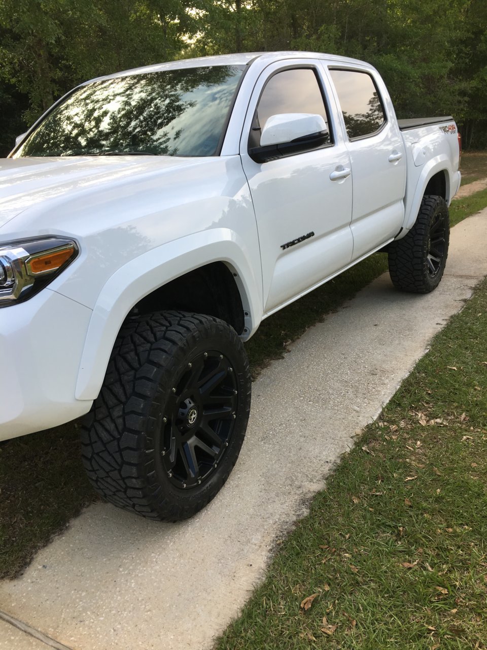

    CE9E63D8-F60E-4B8A-B0EF-5C624C7F4A76.jpg Thanks to @CarolinaBlue for his pics and info on lift! I have a 2017 Tacoma Trd Sport 4x4 with full OME kit 888 coil’s (going with SSO bumper and smittybilt winch) 1/4 inch top plate spacer SPC light racing UCA’s and medium duty Dakar leaf packs with 90021 soft ride struts! Special thanks to Marie @HeadStrong Off-Road and fast shipping. Still don’t no how they put most of all lift in one box with that much packing paper. After taking everything out of the box then couldn’t get box shut with just the packing paper! Sits perfect and rides amazing.

    Side pic?

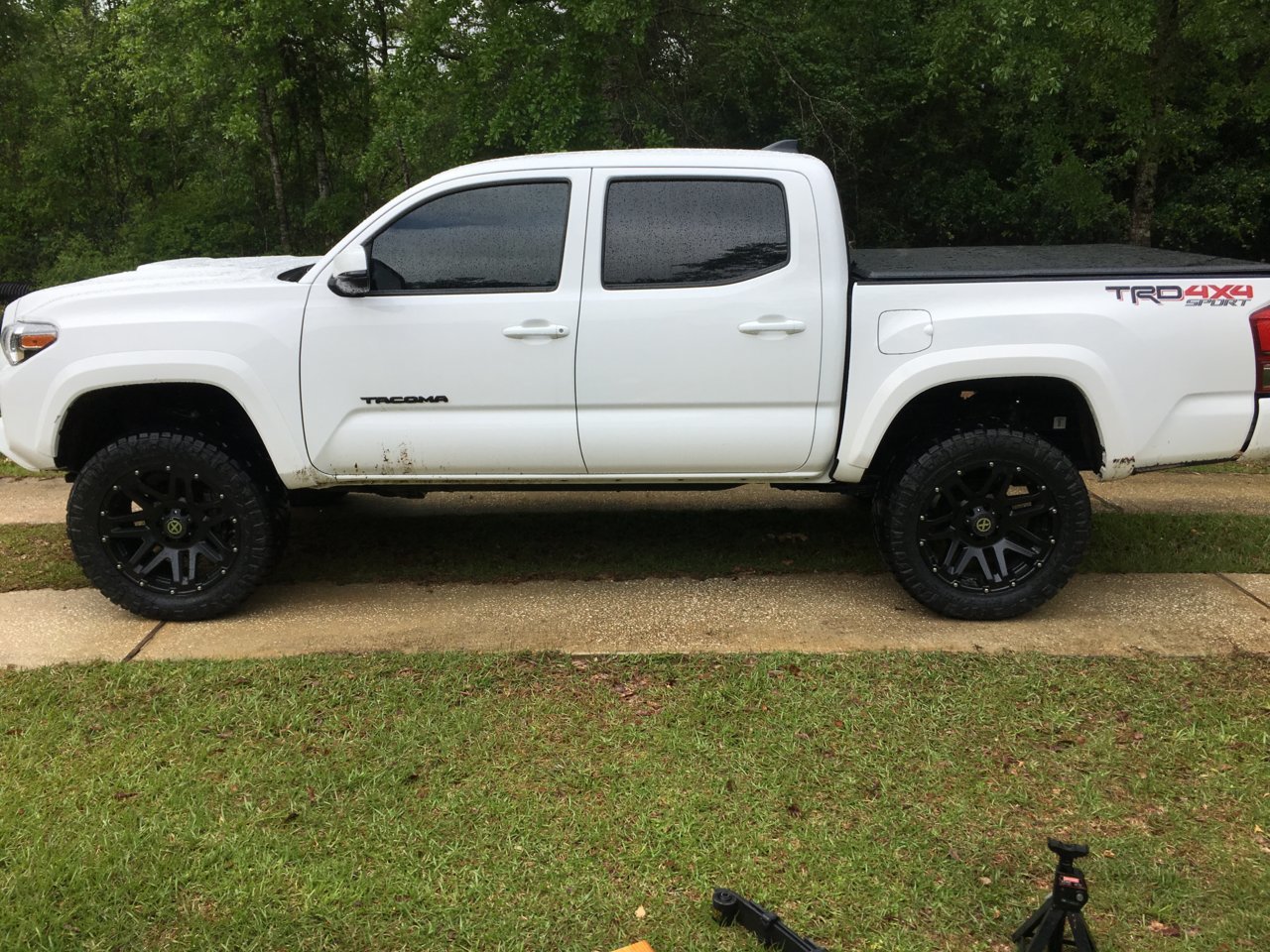

    49B7BAF3-8B47-4295-839C-8160563E4B1A.jpg @Slyman009 here is a side pic! Let me know if you need anything else!

    Thanks. Is the front sitting higher than the back or is it just the angle of the picture? so you put 1/4 spacers on both sides and used the trim packer for driver side lean?

    @Slyman009 no just pic and driveway! My measurements before rims and tires meaning after lift and on stock rims and tires were from ground to bottom edge of fender flare was front drvr side 37 7/8, front pass side 38, back drvr side 38 1/4, and back pass side 38 1/2. Mesurements before lift was driver front 34 7/8, pass front 34 7/8, driver back 35 3/8, pass back 35 7/8. Thats measuring from concrete to fender flare in middle of tire and rim. No measurements after alignment with stock rims and tires. I have the measurements from after new rims and tires also but that is just what the rims and tires added to lift.

    Sorry didnt answer second part of your question. One coil pack comes with spacer mounted on the pack. Then I installed 1/4 spacer on top of both coil packs. I did that because of SSO bumper and wench im installing later on.
