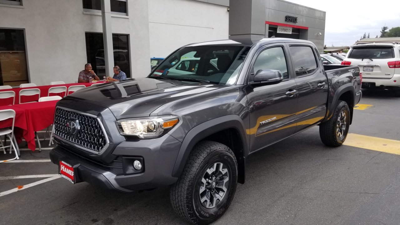

    I`ll be installing these coils shortly with 5100's all around on 0 setting with dakars (medium) and icon tubular uca delta joints. My dad still owns a frame and suspension shop so if there are any questions i can do my best. Just got my '18 off road dbl cab this month.20180526_120456.jpg

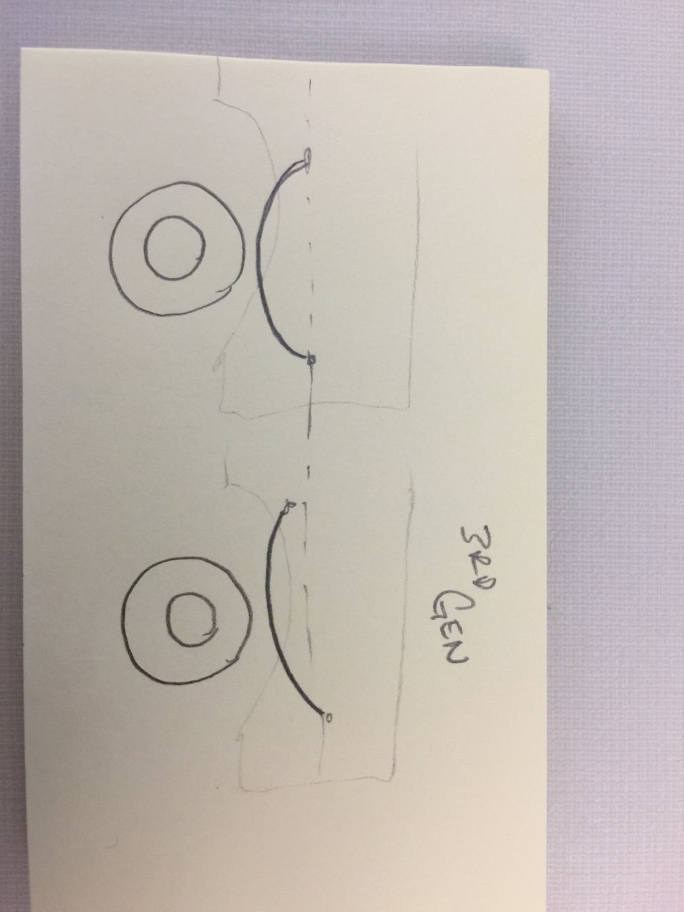

    Has anyone noticed on the 3rd gens that the lead pack tilts forward slightly instead of sitting under the truck as a level “U” shape?
