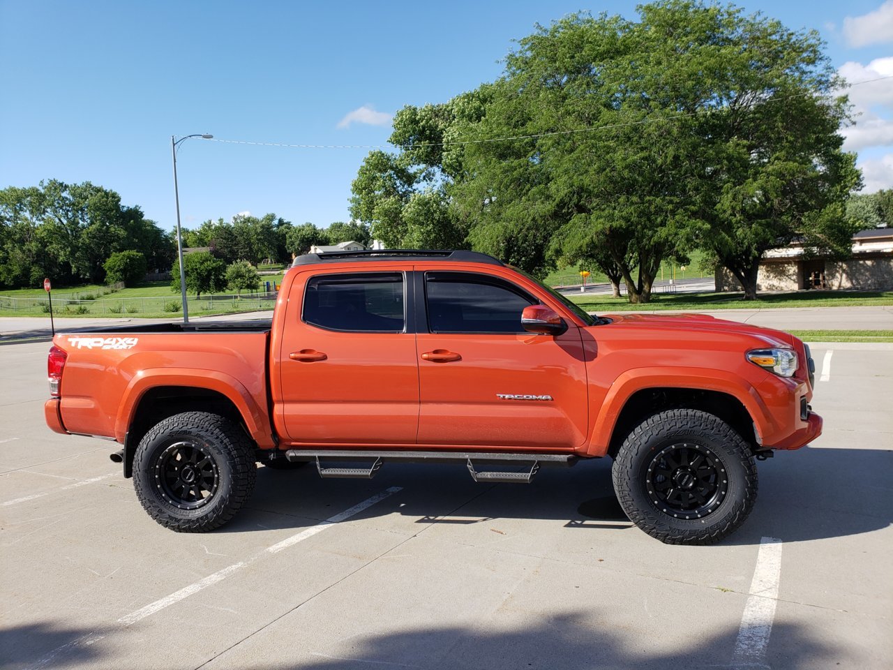

    Hello maybe I can get some help here just installed 5100s all around w/888s, 95r dakars, and Icon UCAs as the truck sits it is a 1 1/2 inch higher in the back. Any chance this will settle down a bit I know the front will and that make me nervous that this rake will worsen. How would the 5100s ride on one notch up? Open to any opinions or options. Pic for attention!!!!!20180625_175025.jpg

    IMO that looks perfect. A little rake but not over the top. Assuming you use your truck as such from time to time it won’t have a saggy ass. If it really bothers you, I would personally just put a couple sand bags in the back when you are unloaded. But I don’t understand why everyone wants their trucks to be perfectly level either.

    I think it'll settle in nice, i run 887s with 5100s and the dakar HD pack, I am at 1.5-1.75'' rake, I have about 5-6000 miles on the lift, I am switching to the 888s to fix the rake a bit but still have some.

    That looks good!
