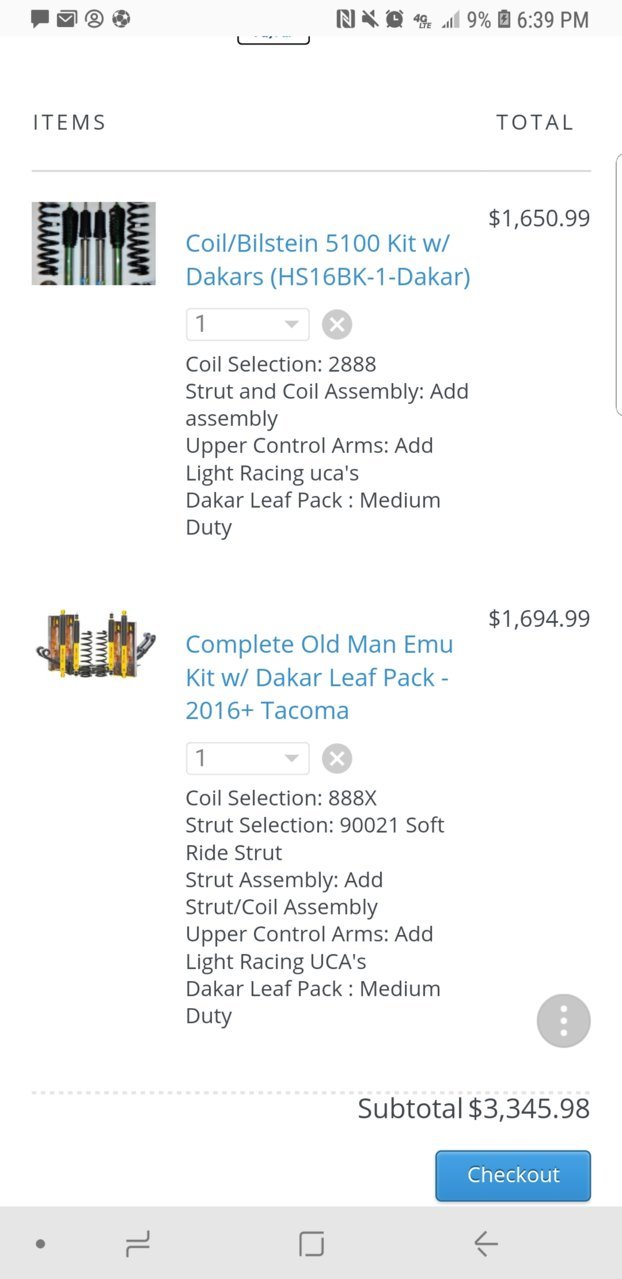

    Need help If someone could help me choose?

    personally don't think you could go wrong with either one . I have been told that the OME kit yields a little more lift in the front .

    Would I be good to clear 275/70/18 on either?

    18 MGM Tacoma
    Also will I get close to 3 with either? Getting the UCA so I can make it out. With 5100s you leave it at .85 though right?

    I'm new to a lot of this and could use some help. Have an mgm 18 off road and ordering lift this week. After talking on here and researching I think I decided against the 4 or 6in RC.
    Now its between OME or Bilstein.
    Daily driver, no crazy off roading. Light trails, hunting, trips to the mountains etc.
    Going to do 275-75-18 ridgegrapplers
    Matte black fuel vapors 18x9
    Just need help on lift. Which one or anyone that can speak on either?
    Also, tires should fit, correct?

    What size tires? I want to do the ridgegrapplers and 18x9 vapors on this lift or either the 5100

    Would one setup require extended brake lines and one doesn't?

    If you get the bilstein B110 rear shocks the kit comes with extended break lines from headstrong , the OME don't need them . Just a heads up I just received my dakars from headstrong and they explicitly say they ship raw and un packaged but that being said they were absolutely shit kicked . Paint on both sides of dakars were completely scraped off also scratches/ gouges to metal on sides and bushing eyelets. They need to change how these are shipped. Maybe some cardboard and bubble wrap ?
