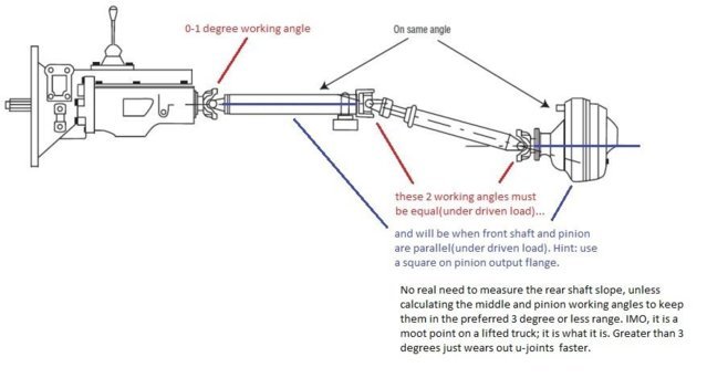

    CB drop changes angle on the u joint from transfer case which ultimately doesent "need" to change. Using correct shim will fix the vibrations without changing that geometry

    IMG_0133.jpg this image helps, some still use CB drop to fine tune minimal vibrations that could still be present. But with a proper shim that amount will be very small (mm) not a (3/8" or 1/2") amount

    Technically the CB drop is not needed. To get proper operating angles the CB drop should only come into play if shims don't get your operating angles within 0.6 degrees of each other. For OME lift kits and Dakars, 3 degree shims are ideal. My operating angles without the CB drop are 0.2 degrees off from each other.
    However, if you DO NOT have the ECGS clamshell bushing installed that replaces the shitty needle bearing in the driver CV then you should get that installed BEFORE anything (it is a must) otherwise it will be like herding cats trying to figure out why the vibe isn't going away...trust me, been there done that.
