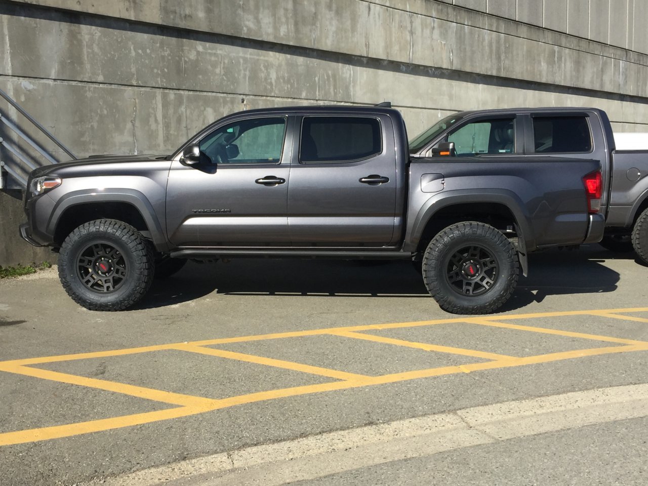

    Can i see a pic of how it sits with the set up?
  12. Mar 5, 2019 at 2:22 PM
    #572
    T1089
    T1089 Well-Known Member
    Dec 19, 2017
    #238922
    133
    Tristan
    B.C. Canada
    2017 Tacoma TRD Sport 6MT
    -Bilstein 5100's EXT + 886 OME coils -Bilstein 7100 14"SB shocks -Camburg Uni ball UCA's -BAMF leaf hanger & shackle -BAMF shock relocation kit -Dakar HD leafs -U-bolt flip kit/super bumps -TRD PRO SEMA rims + 255/80/17 Ridge Grapplers -Cali Raised Led 32" hidden light bar & switch panel - Backflip tonneau -Demello tube sliders -Mobtown skid -TRD Pro grill -Custom bed rack -OVT 2.0 SFOB Tune -2WD Low mod -Kicker CS Speakers
    2-1/4” front and about 2-3/4 rear
    33” tires
