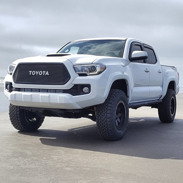

    It's got a cop motor, a 440-cubic-inch plant. It's got cop tires, cop suspension, cop shocks. It's a model made before catalytic converters so it'll run good on regular gas.
    200+lb bumber and winch def needs 886s right? someone on here recommended 888s at .85 on 5100s, but they are only 3 mm taller and much softer...

    7GR
    7GR Well-Known Member
    Apr 20, 2015
    #153565
    394
    GSJ15W

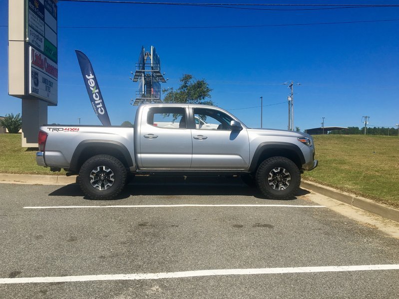

    k-dub Member
    Jun 29, 2016
    #190866
    20
    Virginia
    2017 Grey DC TRD OR
    Lr uca's and 34x10.50r17 KO2's
  4. Sep 29, 2016 at 4:33 AM
    #44
    Wdhigh
    Wdhigh Well-Known Member
    Sep 2, 2016
    #196268
    93
    Ridgeville, SC
    2021 Trd OR dcsb
    Nice!
    Rubbing? Anything special to fit the tires? Diff drop needed?
    Looks great!
  5. Sep 29, 2016 at 6:17 AM
    #45
    k-dub
    k-dub Member
    Jun 29, 2016
    #190866
    20
    Virginia
    2017 Grey DC TRD OR
    No rubbing and no diff drop

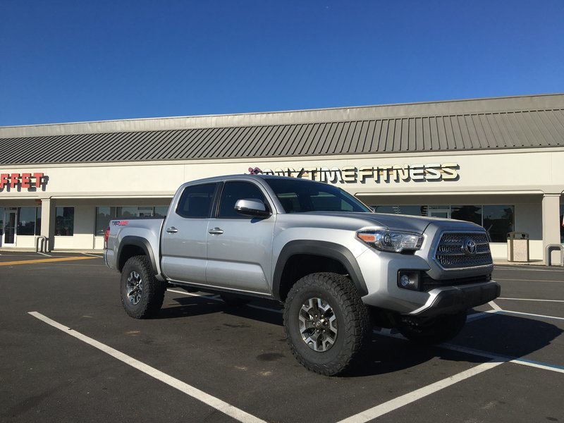

    885 coils, drivers side spring packer, OME 90021 shocks, ttfs .5" block. 285/75r16 K02

    Have you measured this? Curious if the front is higher than the rear with 885s and the .5" spacer.

    All of the Toyotas
    I haven't measured it since they settled like in this pic. Before it settled it was 1" higher in the front. If I had to guess I would say it's within a .25-.50 higher in the front.

    OME suspension and 285/70R17 BFG KO2s
    Excellent looking truck! What are these specs again? OME 885 coils on OME 90021 struts with the .5" Toytec Top plate spacer and the driver side spring packer? Nothing added to the rear suspension at all? Thanks in advance!

    Derek
    All of the Toyotas
    OME 90021 front shocks
    OME 885 springs
    OME spring packer on drivers side (probably could have used two it still leans a .25 or so)
    OME rear shocks
    TTFS .5" rear blocks
    884 springs would give you a slight rake in the rear or you could go with a 1" rear block with 885 coils if you don't want it completely level. 1" rear blocks require longer u bolts. To make it even more confusing you could also remove the oem plate (around .2") that's under the leaf springs when adding the .5" block which would probably be close to level with the 884!springs. I did a lot of research before lifting my truck the nose will be about 1" higher in the front until the 885 springs settle. I thought I messed up at first but it turned out nice.

    2017 DCSB 4x4 in Silver Sky
    It looks great, seriously.....and I'm picky. I already have 885/90021 coilovers :) which is why I'm asking. I'll have to get the top plate spacer removed and a 1" block from Toytec. Too bad they don't offer a longer U-Bolt flip kit for the rear leafs. This kit almost makes those 33" BFGs look little!! I'll go with white letters out so we don't get our trucks mixed up ;)
