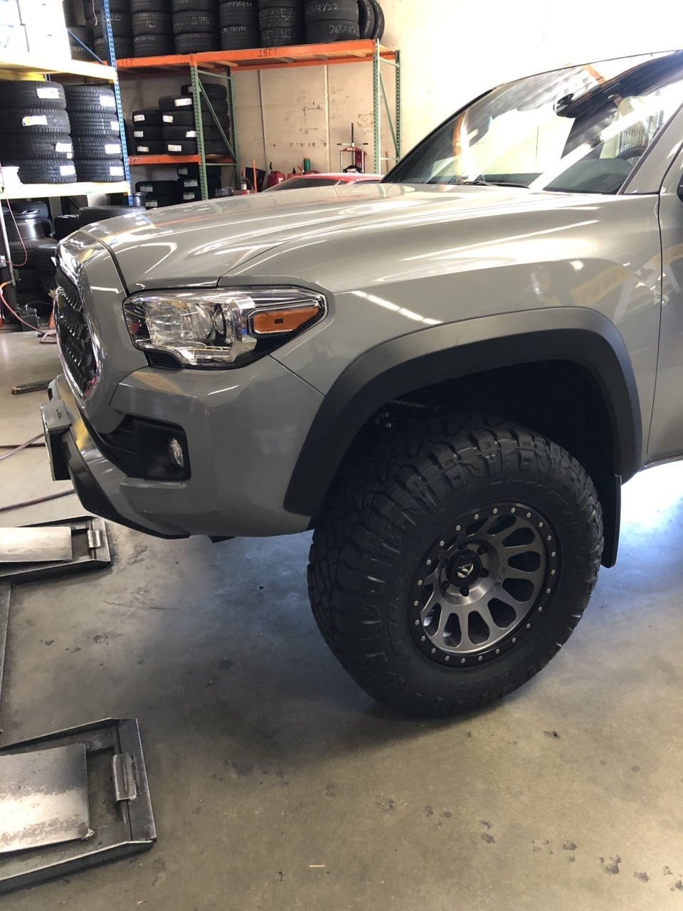

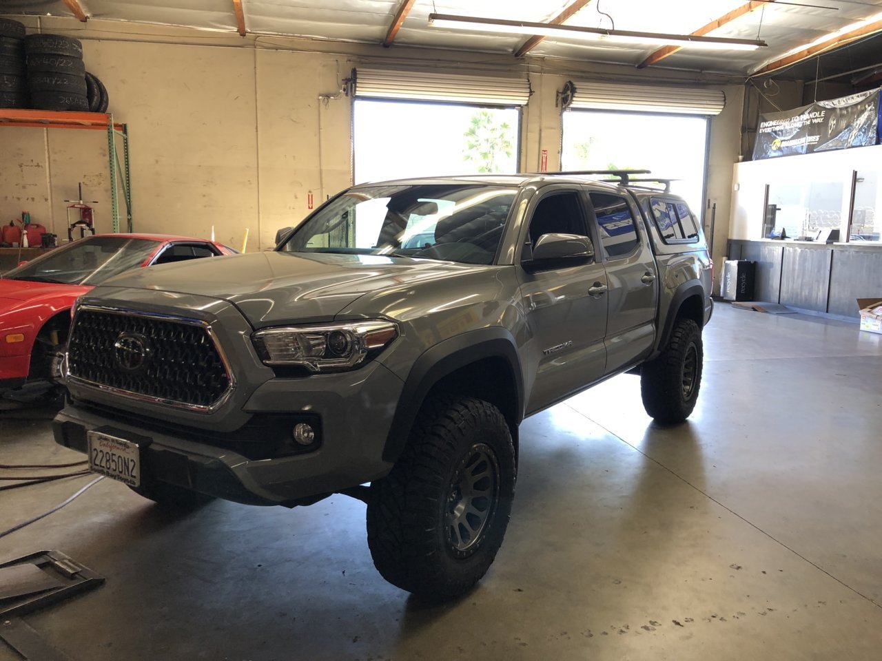

    I’m happy with how the truck rides. It does sit low in the front. I’m at about 23” front and 24” rear. I had my CMC done today which helped with the rubbing for sure. My wheels are Fuels with -12 offset. I’m debating if I want to add spacers to bring the front up. I’ll post a side pic later if anyone is interested.
