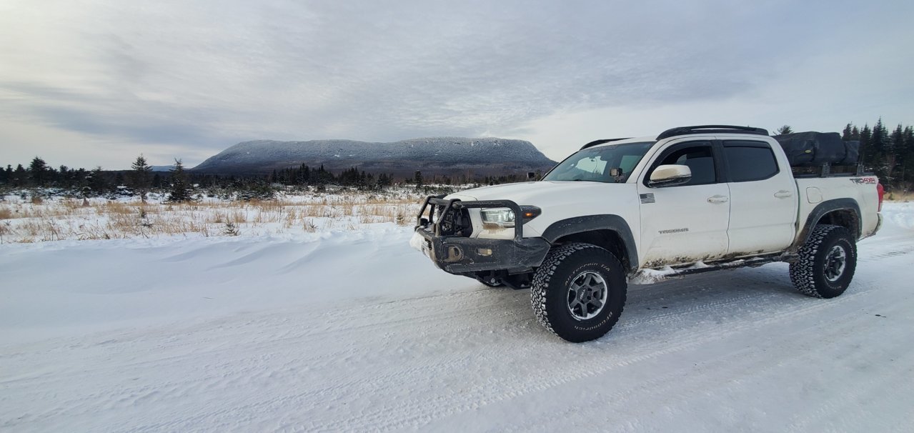

    I installed the OME nitrochargers all around and 888’s and aal in the rear. The rear is a solid 2 inches of lift. The 888’s have settled to about a inch. Seems pretty low. Little less than a inch. So significant rake. I have sliders, front bumper guard and rear (avid off road). Weird that it settled to a inch. But from all I have read they are built for the weight of third gen. Anyone running 886? Thinking of giving that try. Not looking for 3” will be totally content at solid 2 and minimizing so much rake. Anyone experienced this? Advice ?

    What tire size and lift in the rear? Looks great
