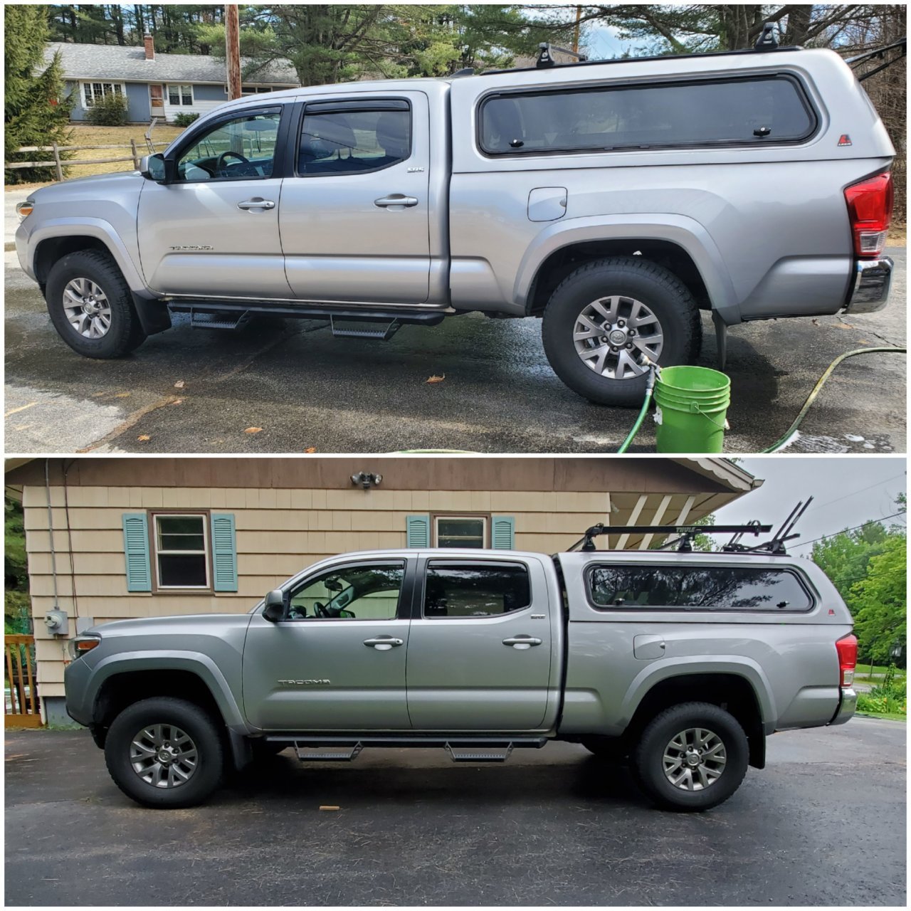

    Not apples to apples pictures but pre & post 5100s on 888s & single AAL w/ overload left in. The initial gains are:
    RF: 2 ⅓"
    RR: 2 ⅔"
    LF: 2 ⅔"
    LR: 3"
    Have only driven ~1-1.5k on it thus far but initial reaction is positive. I'm not wheeling, just needed to get off the bump stops in the rear but wanted to keep a relatively level stance. Yes, spacers would have been cheaper but the additional front travel is appreciated.
    Will update ride heights after ~5k

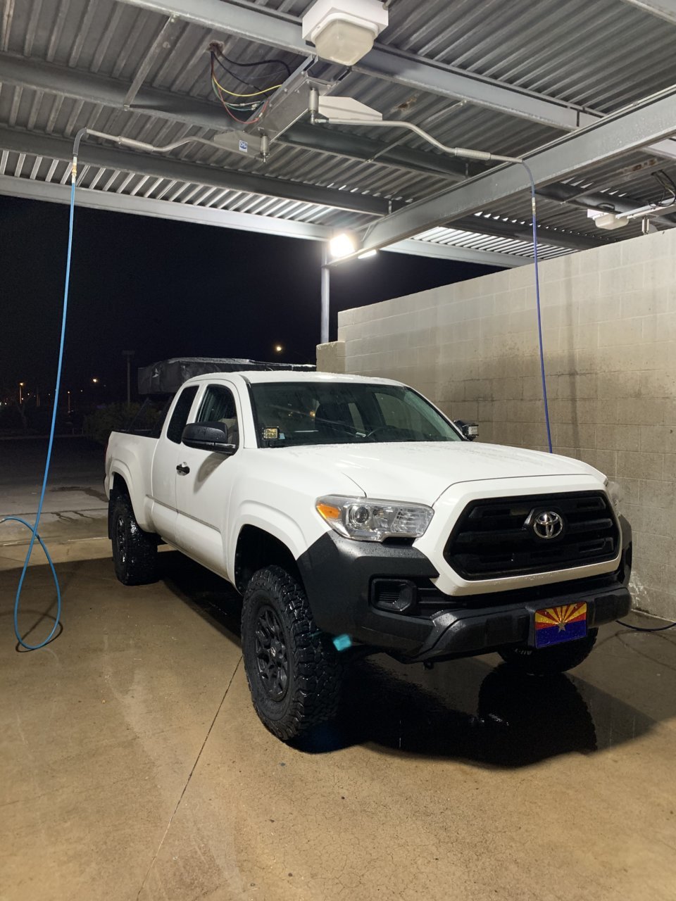

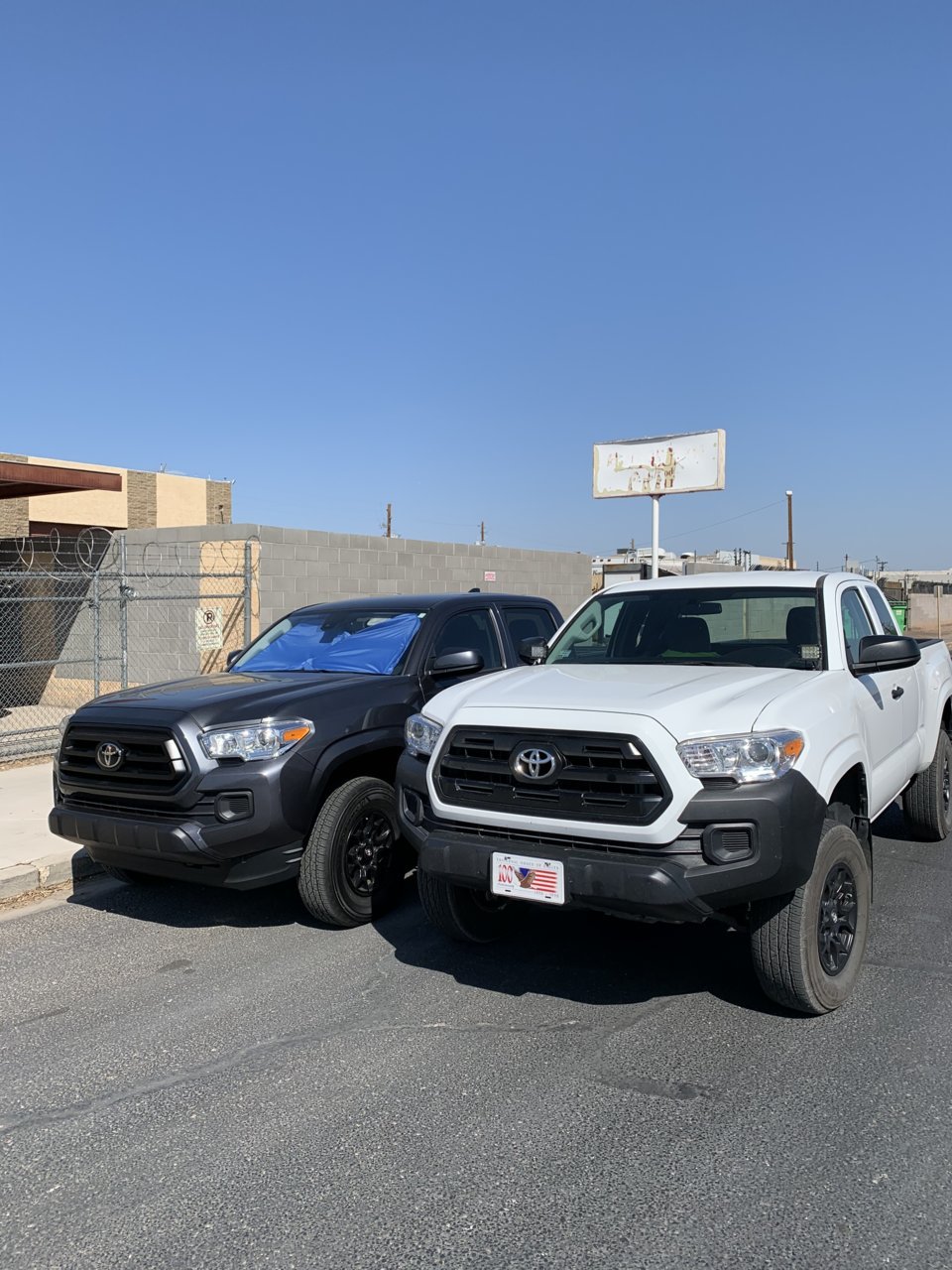

    2017 SR 4x4
    I’m running 888 5100 & Deaver aal. My buddy is stock sr5 4x4 for comparison. Also we’re both on 245/75/16

    Same setup from above finally swapped out the 245/75 for 265/75
