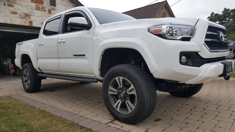

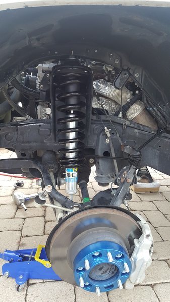

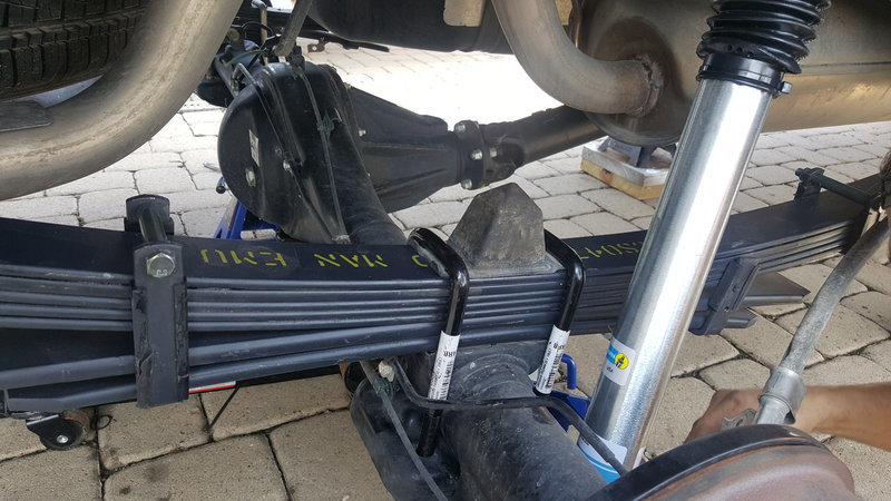

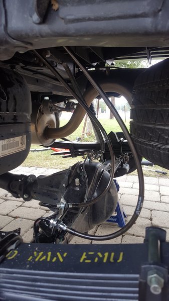

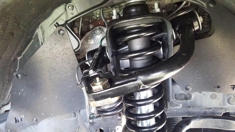

    OME 888's with Bilstein 5100's (set 0) Light Racing/SPC UCA's OME Dakar Leafs w/ Bilstein B110's Fuel Beast 17x9 (4.5" BS /-12mm) 285/70 R17 Nitto Ridge Grapplers
    OME 888's with Billy 5100's set to 0 and Light Racing/SPC UCA's. Dakar leaf's in rear. Right after install it was sitting at 3.5's of lift in front and 3" in rear.
    Fender to center Hub: 24".5 (rear) 24.00" (front)
    I have a set of 17x9 Fuel's that I plan to install tomorrow with some 33x12.5's.
    Finished Lift:
    OME888 Coils with Bill5100's set to 0:
    OME Dakar Pack with B110's
    Light Racing/SPC UCA's:
    Extended Rear brake lines:
    Before Lift:

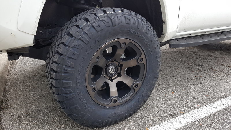

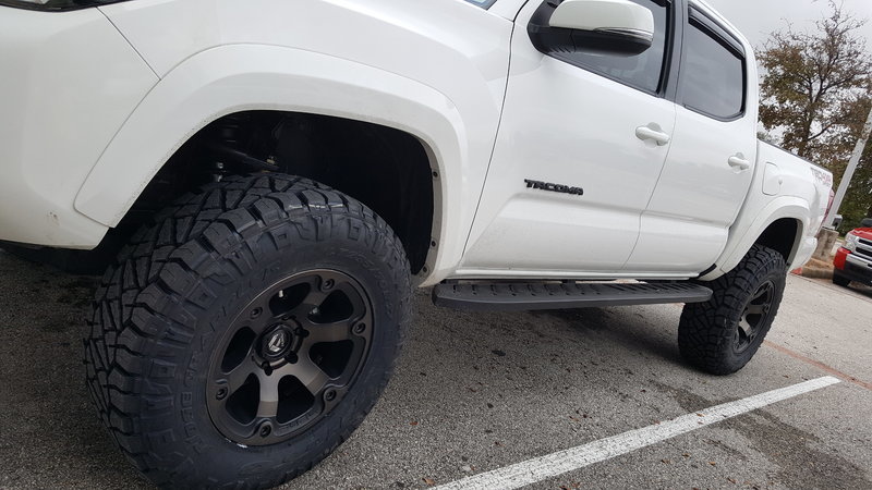

    Got my new shoes today!!
    17x9 Fuel Beasts (4.5" BS / 12mm offset)
    285/70r17 Nitto Ridge Grapplers
    Tried running the 33x12.5's but I was rubbing pretty good on the Cab mount. Until i decide to start cutting my new truck, the 285's are staying!
    Enjoy!
