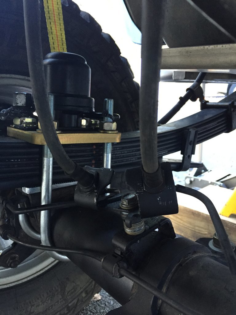

    Here's a better pic of the stacked washers.

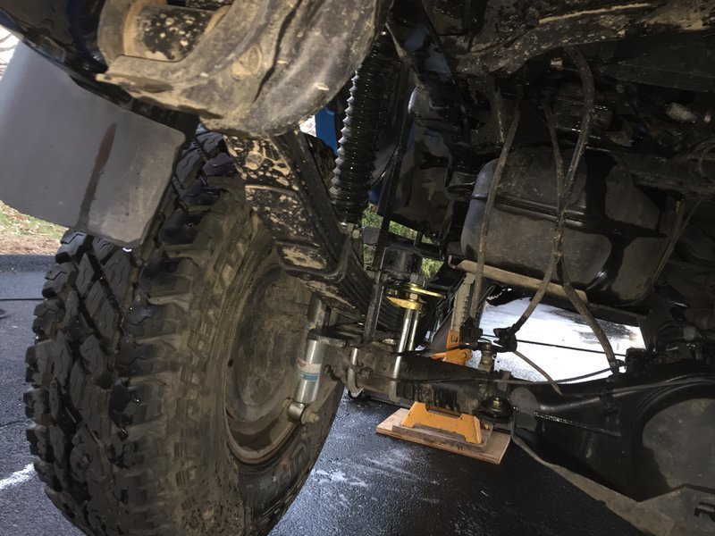

    I was thinking more about this. Is it possible the bilsteins allow more travel than the ome and that's why your lines were maxed out?
  3. Aug 14, 2017 at 6:36 AM
    #203
    Subway4X4
    Subway4X4 Shameless Copy Cat
    Nov 10, 2015
    #169260
    11,653
    Lloyd
    NY/NJ
    05 Speedway Blue DCSB OR TRD
    Everything TW members recommend
    Not sure about OME's. The rear Bilstein B110's have a max extension of 27.28" and the Dakar's with 29XL AALs took full advantage of that 27" at full droop. So yes, the OEM brake lines were maxed out by just a hair. The stacked washers on the brake line bracket was temporary. I felt a lot more comfortable when I added the extended brake lines.

    Yep that's gotta be it. The OME are only 23.5"

    Thx for the info. What did you do to get more slack for the brake cable?

    Grabbed it and bent it downward. Not sure if that helped. The brake cable still looks taut at full droop.

    The OME shocks should be the limiting factor for down travel and so longer brake lines should not be needed. The OME shocks were speced out (extended length) this way to prevent from having to change them and is why they are not included in the OME kits. As for the e-brake (someone already mentioned this), they can be pulled forward some more to prevent them from being too tight at droop. I had to pull mine on my Taco and even with tons of droop I'm still good.

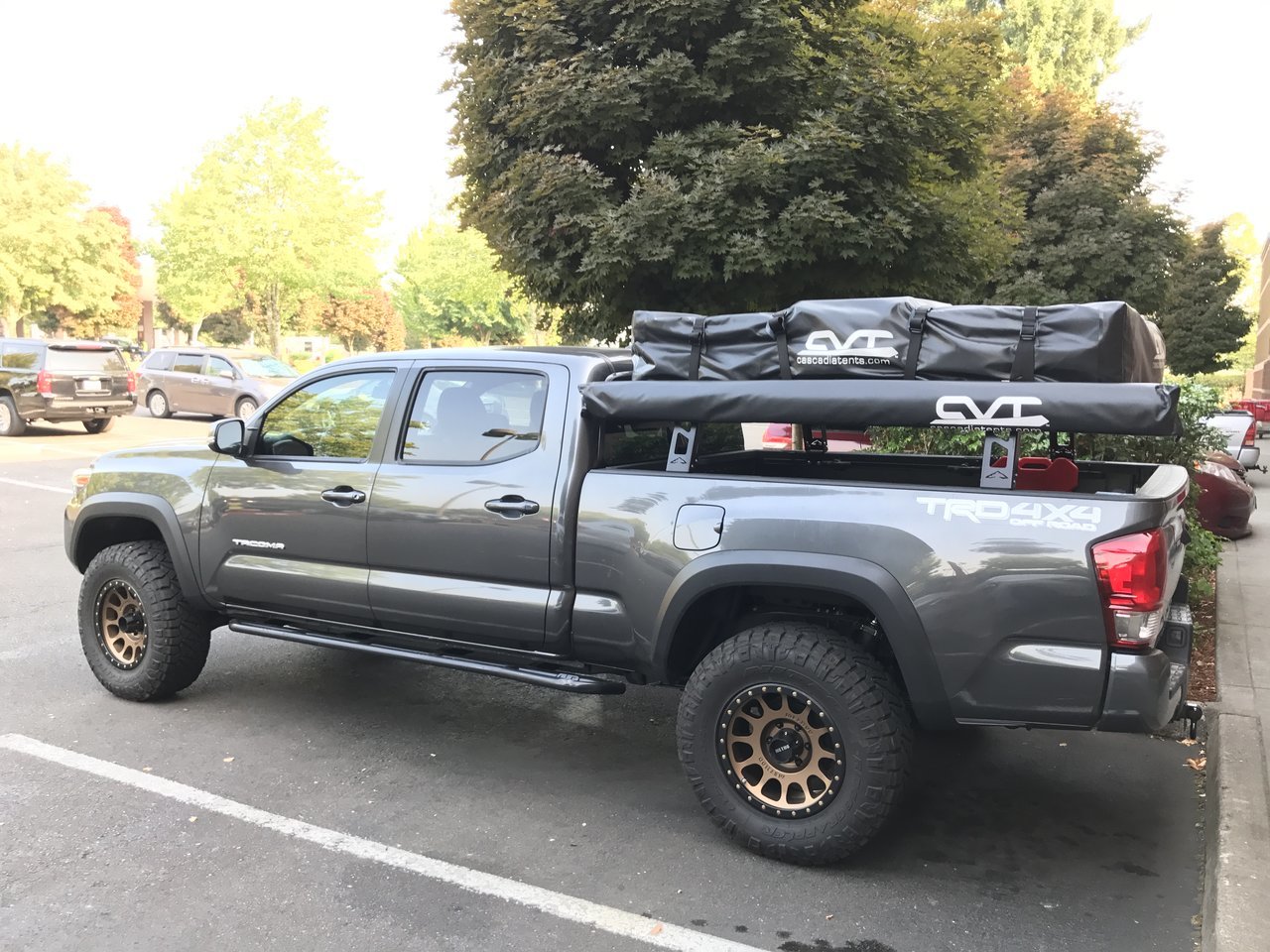

  17. Aug 17, 2017 at 6:15 PM
    #217
    crazysccrmd
    crazysccrmd Well-Known Member
    Mar 17, 2016
    #181592
    9,250
    Alaska
    Aprilia Tuareg 660
    The EL095Rs do not provide the 2.75" as advertised once you add any weight to the truck. I just installed mine and they measure at 23.25" driver's side and 23.75" passenger side which is only 1.25-1.75" higher than a stock 2nd gen. I have about 200lbs over the bed with my RTT and probably another 125lbs between the fridge in the backseat and crap on the roof rack.
    FStewart17[QUOTED] and PNWTacoma like this.
  18. Aug 17, 2017 at 6:20 PM
    #218
    Lord Helmet
    Lord Helmet Prepare To Attack
    Aug 30, 2012
    #85875
    39,166
    Nick
    '24 X3 M40i
    They are advertised as true. I have the 95Rs and it is at that height BEFORE you add weight. They even tell you it's for no weight added. If you're worried about lift height you should've gotten the 96Rs... they are designed for weight up to 600 lbs.
  19. Aug 17, 2017 at 6:42 PM
    #219
    crazysccrmd
    Mar 17, 2016
    #181592
    9,250
    Alaska
    Aprilia Tuareg 660
    They are advertised as 2.75" from no load to GVWR. With that rating I assumed that they would sag with some weight but not to this extent. It's not a deal breaker but I was hoping they'd sag to yield about a 2" lift. I might end up buying the AAL to put on in summer months when I have the RTT mounted and remove the AAL during the winter when it's too cold to camp and the RTT is in the garage.
    FStewart17 and PNWTacoma like this.
