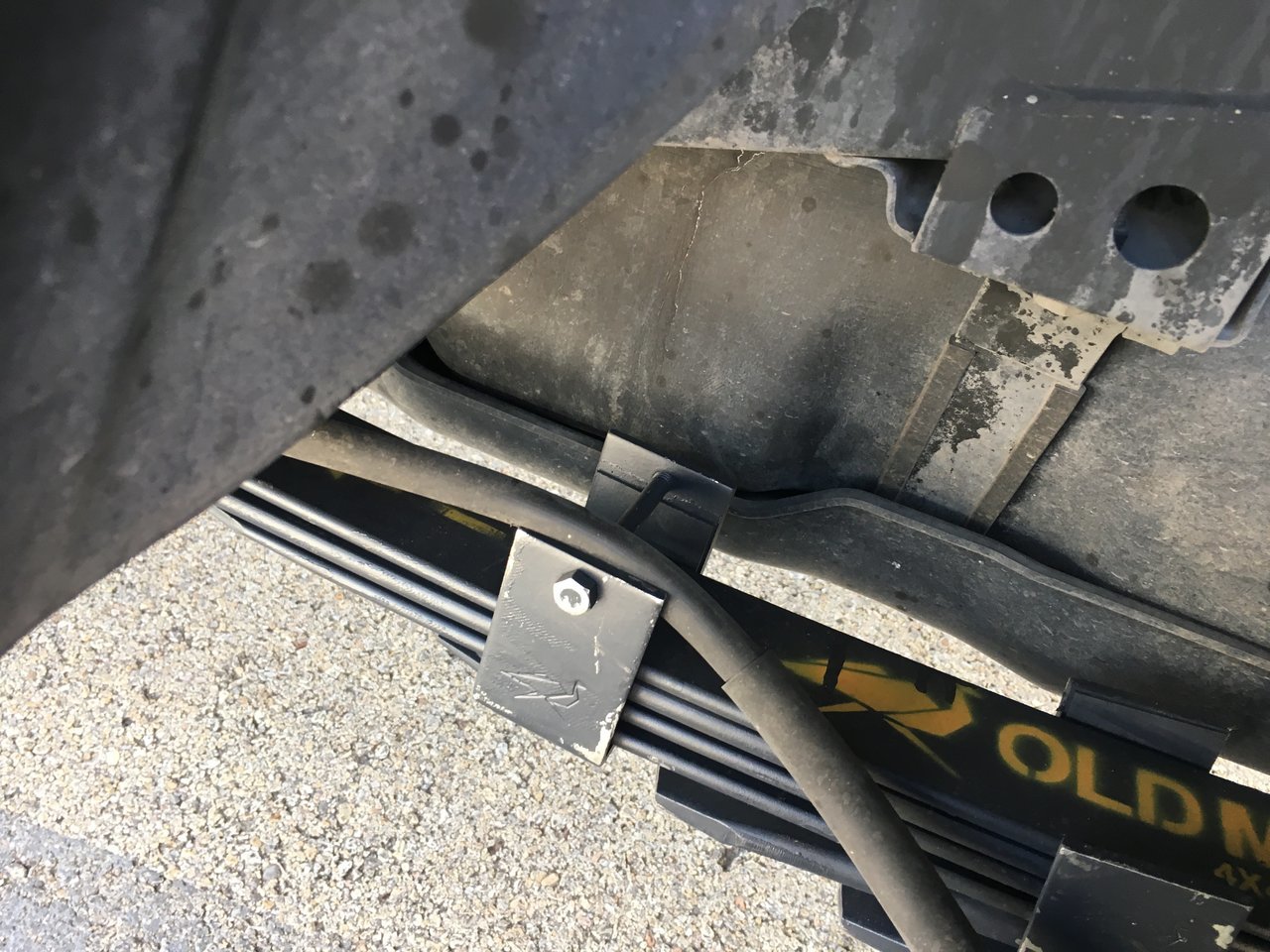

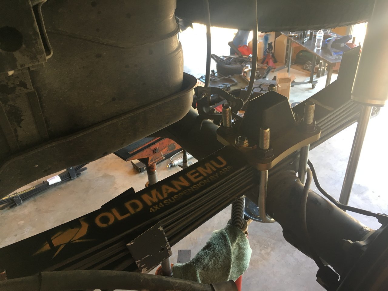

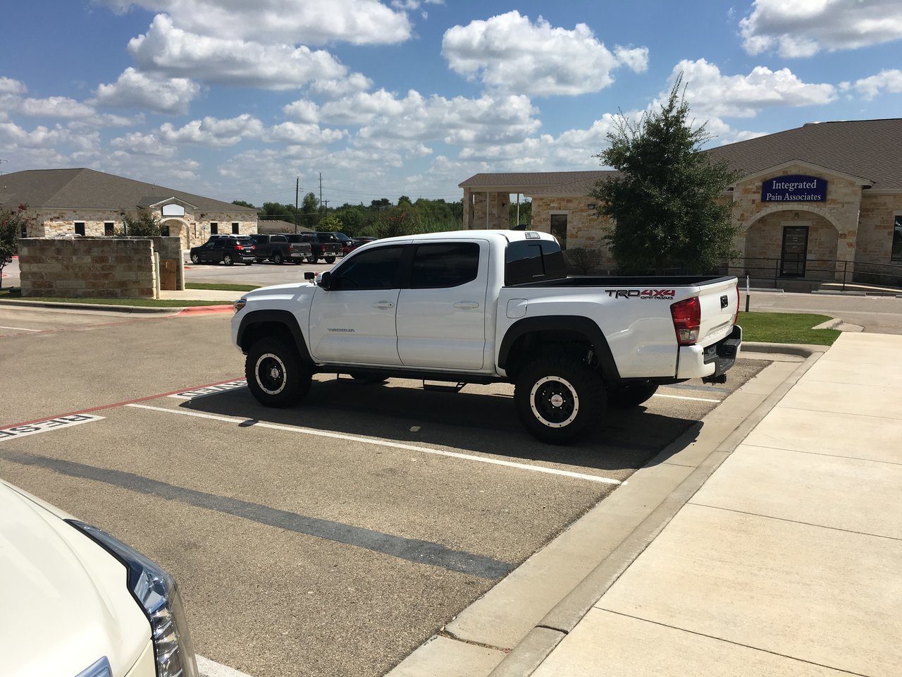

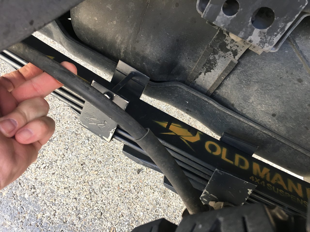

    Love this new leaf pack on my 17 OR. It rides so much better than the Icon AAL. Wish I had gone with the Dakars the first time. Only issues are installed OME drive carrier spacer kit and still have vibs 20-25. Also e-brake line is hanging on leaf pack. Will rig something to fix this.

    Just bend the bracket for the e-brake line so it points away from the spring pack... I've bent mine in all sorts of directions to get it just right with no binding.

    Looks like you did the EL095R pack. What's your hub to fender measurement after it settle a little bit?

    Truck looks great :thumbsup:

    I bent the brackets this morning on both sides and that did the trick. Thanks!

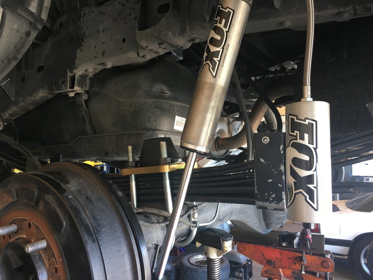

    Are you planning to put some taller bumpstops on soon? Right now you're going to bottom out your shocks before the bumpstops hit, and if the bumps were to hit you'd probably hit all four ubolts on the frame also.

    Excellent observation and thank you for that. I haven't cut the ubolts yet but am planning on doing it this weekend. I will look into the bump stops further. Again, thanks.

    Thank you! Yes I'll consider getting these. Just when I think I've done enough research pre-install and I've got everything I need, I run into things like this. No biggie though. I'll just get bigger bump stops. I'm going to measure the shock travel and the bump stop to frame distance and make sure the ones I have won't work. Will follow up.
