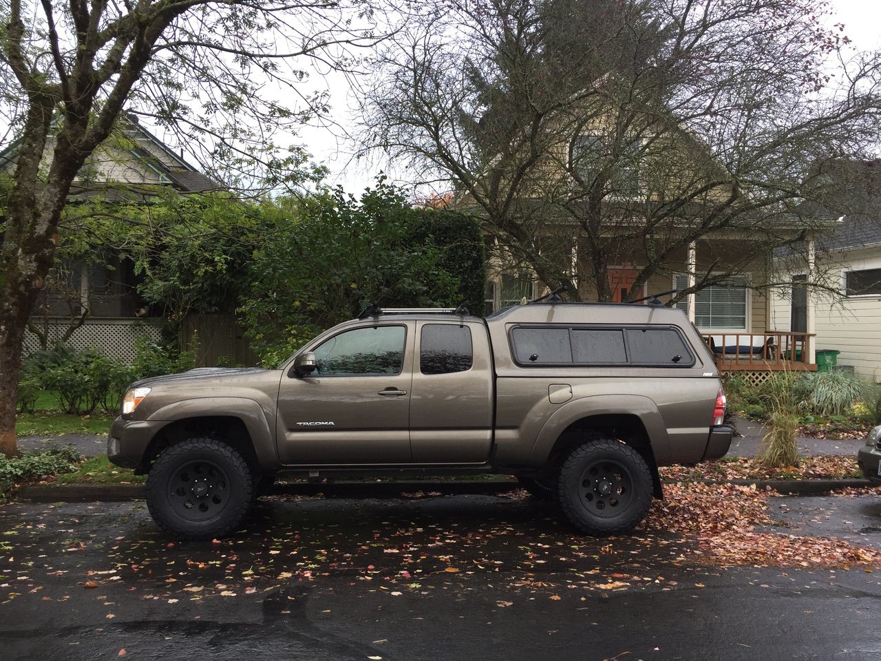

    uncle_joe
    uncle_joe Member
    Oct 19, 2017
    #233443
    14
    2015 TRD Sport Acess Cab Pyrite Mica
    Old Man Emu 3” Dakar leaf set + 1 leaf Pro comp wheels BFG K02 275/70/17 A.R.E. MX cap Tekonsha p3 brake controller
    Yes. I have a platform and drawer build out. Weight is prob around 200 lb extra with no gear.
