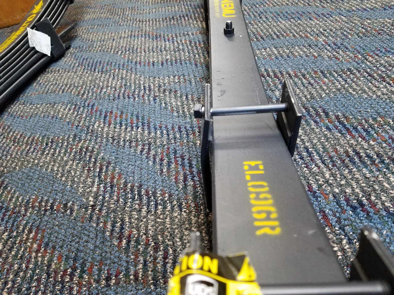

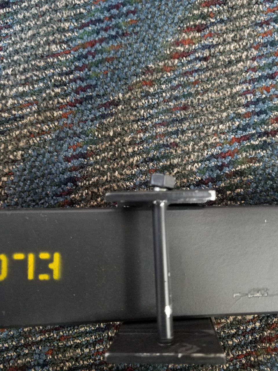

    Received my 96 pack last week. Damn these thing really take a beating during shipping. I'm not too concerned about the paint, but one of the retainers and bolt were bent upon delivery. Is this something I should be concerned about?20171115_083055.jpg 20171115_084213.jpg

    Wow....I'd have that bolt and retainer replaced. That took some doing.....

    Yea, they really do take a beating getting to you. If this was mine I would bend the tab on the retainer back straight and replace the bolt.

    Thats kinda what I was thinkin too...Thanks guys!

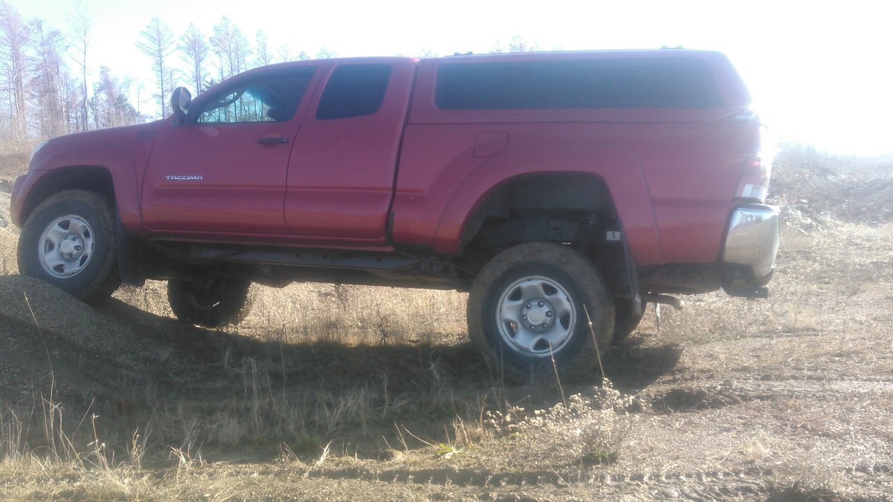

    Okay, backstory. Friday I bought King 2.5 RR front and rear, with this leaf pack, el096r, and timbren ubolt flip bump stop kit. I installed the suspension Friday went off-road Saturday and fully flexed out with rear tires coming off the ground.
    Stock brake lines. My brake lines never get too tight, tighter than factory, but I highly doubt I'll replace them. However the e-brake cable seems pretty stinking tight just sitting on concrete.
    Suggestions?

    I have asked this question before and apparently its just the way it is. Let it ride!
    whitedlite[QUOTED] likes this.
