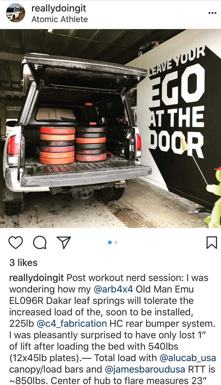

    Super impressed with the EL096R spring pack. Maintaining 2" of lift with 850lb load. Rear suspension was installed about just over six weeks ago and has been loaded with 4-500lb daily load since then, so it has 'settled'.

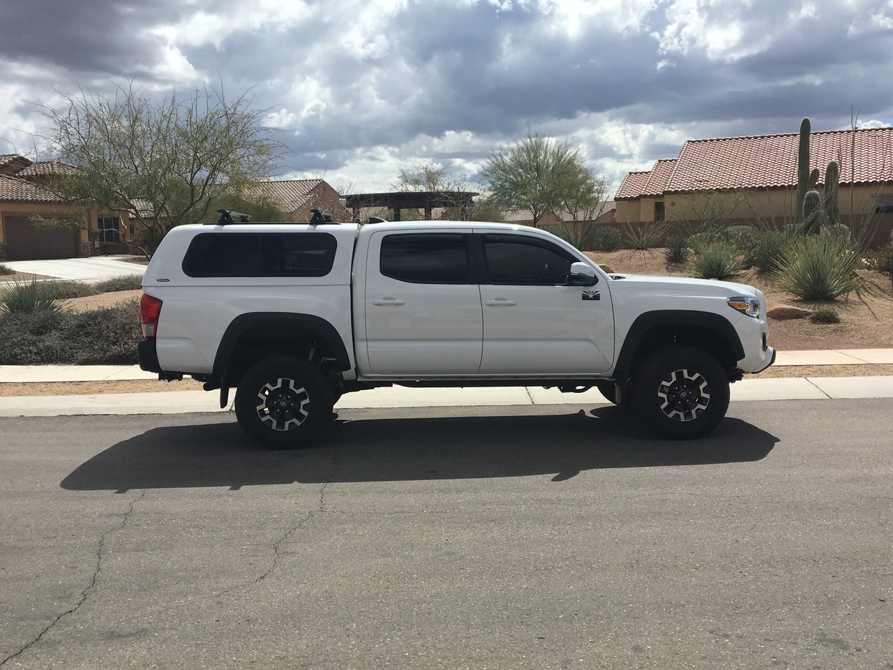

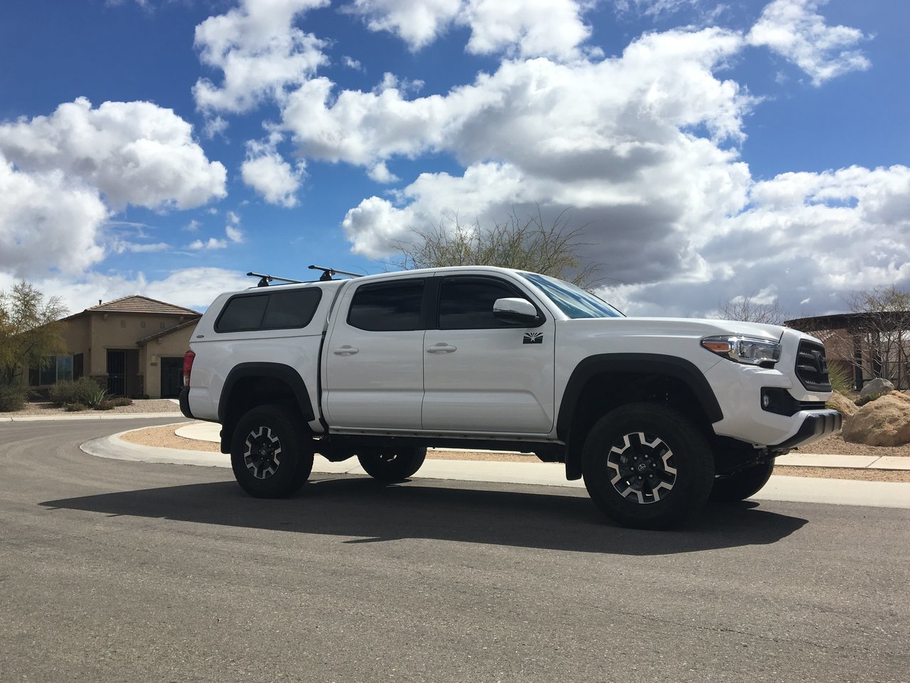

    Well, it’s been 4 weeks since I installed the 5160s in the back with the Dakar 96 pack. Finally got the 6112s installed yesterday. I am very impressed with the Dakar 96 pack. Final level for the rear is 24.5 from center hub to fender with a constant load of 320lbs. 0601FB41-97B1-4E28-91A0-2ADC49271C05.jpg EF236505-F4EB-432E-AEA9-3439D8F8E08A.jpg
