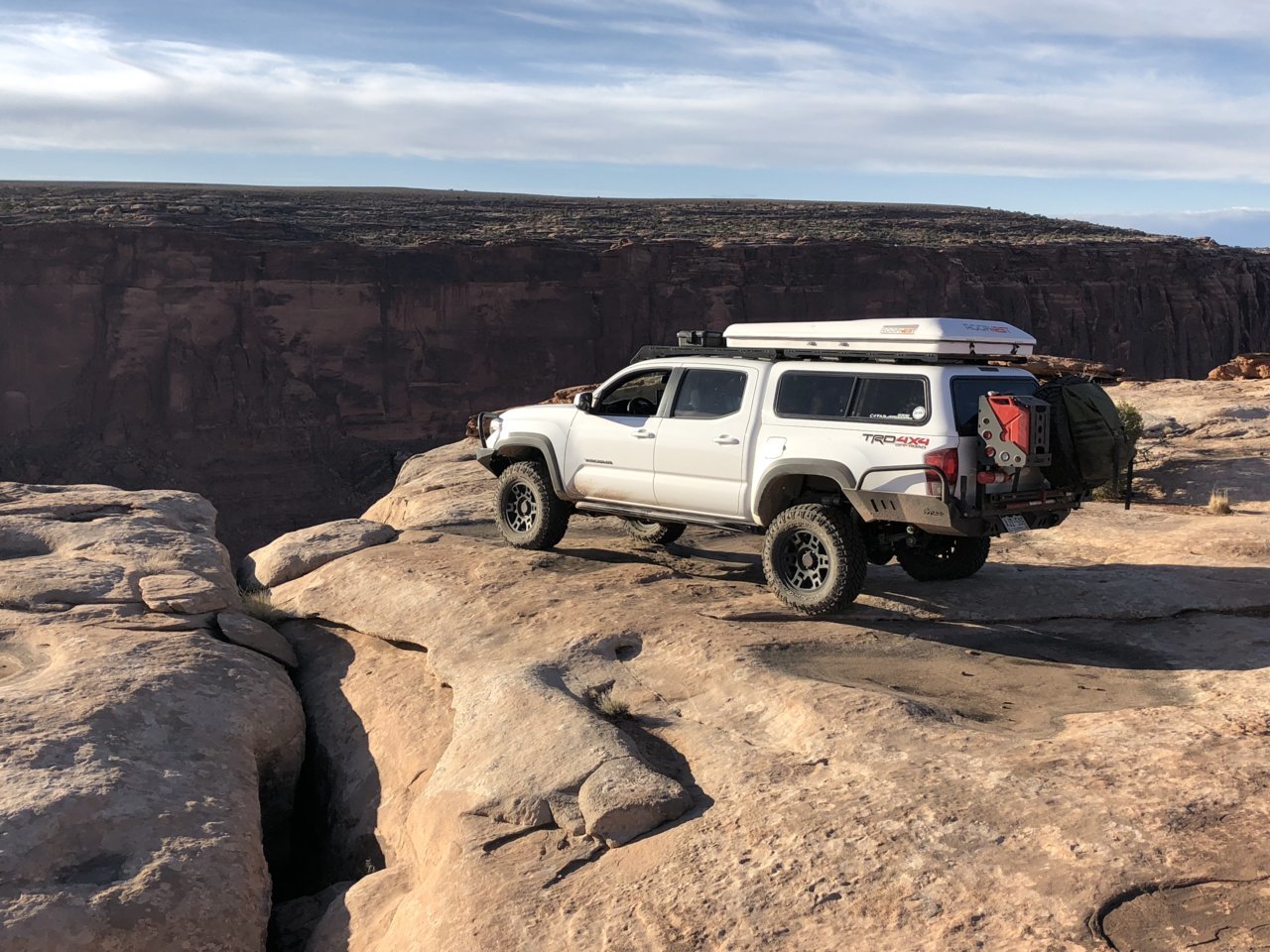

    For those running heavy as crap loads in your bed, here is how I’m sitting. I’m running the heavy duty pack plus an extra leaf. So super duty. Lol.
    I have a hc rear bumper with swing out, topper, roof top tent, and a heavy storage system in the bed. It’s a lot of weight. And the heavy duty pack plus aal holds her nicely.

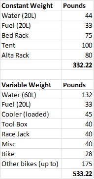

    My EL095R pack has 3500 miles on it and I added the EL46XL AAL to it 150 miles ago. Measurements from flat ground today has it sitting at 25” on both sides with about 150lbs worth of crap and half a tank of gas. That’s about a .5”-1” increase from just the EL095R. It is stiffer but not bad and holds weight from a trailer a bit better. Towed an 8.5x14 flat deck with three ATVs (about 2800lbs) without much change in ride height. I haven’t loaded the truck with gear yet so no comments on ride or height maintained from that.

    How much weight do you have back there @Patch92 ? I'm looking at ordering now but am double checking everything. What springs are you running up front? With shipping to AK, I wanna get everything I need the first time. Thanks for any wisdom you can share!

    I’d say...
    - Bumper with tire and full jerry cans: 365
    - topper : 175
    - tent : 135
    - storage system full of gear plus cooler and water: 250 lbs
    I’d say around 900 lbs.
    Dakar Heavy Duty pack is rated to 660 lbs. I had a little too much sag in the back with all my gear and the heavy duty pack, so I added the extra leaf. Sits good now. And doesn’t ride super stiff, even when gear is unloaded.
    I have the OME bp51 kit. So I can adjust compression and rebound as well, which helps with the ride. And I have the standard bp51 springs, pre loaded to the winch and bumper setting.
  8. Apr 13, 2018 at 12:56 PM
    #468
    CO_0321er
    CO_0321er Well-Known Member
    Jun 27, 2015
    #158286
    1,850
    It’s about 2”. I have the BP51 kit, set at the winch and bumper setting. It looks a little low in that picture, it’s slightly compressed by the way it’s sitting.
