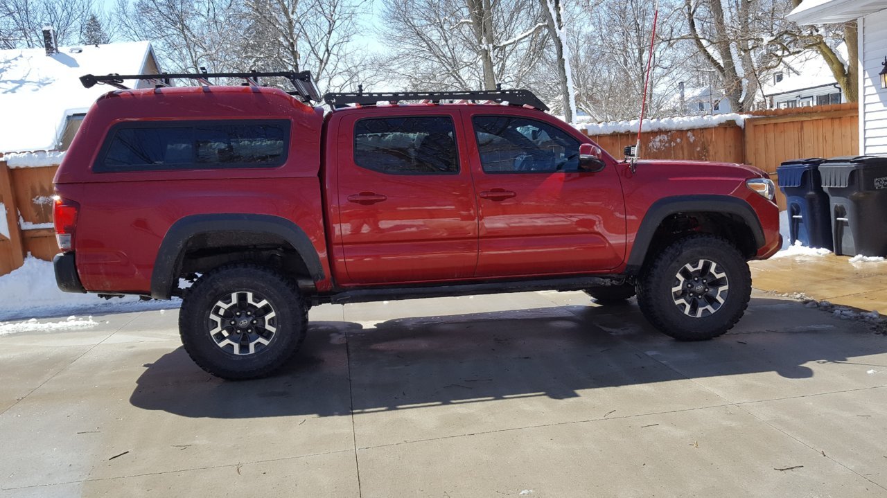

    Here is 96R leaf pack with shell + 100lbs of tools in the bed. There is some rake but not bad.

    With 0-1.5 the shocks will be your limiter for droop. You would want extended shocks with the EL96R's.
