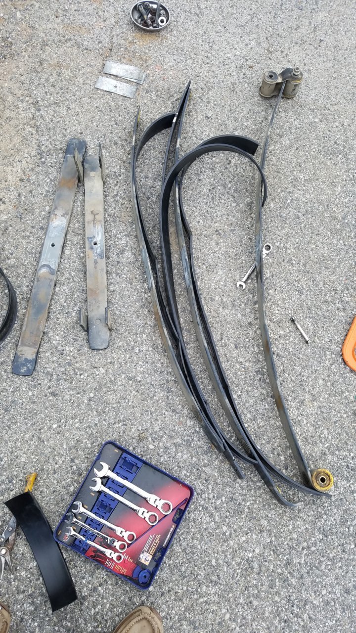

    I had the complete leaf packs off my truck. I clamped the leaf packs and unbolt the centerpins. Then you separate each leaf and make sure the leaf liners are cut to length. I placed my liners over every individual leaf including the overload. There will be several metal plates, just make sure you put them back, I had them on top of the liners. You will have to drill a hole through the liner for the center pin to go through after you lay them out.

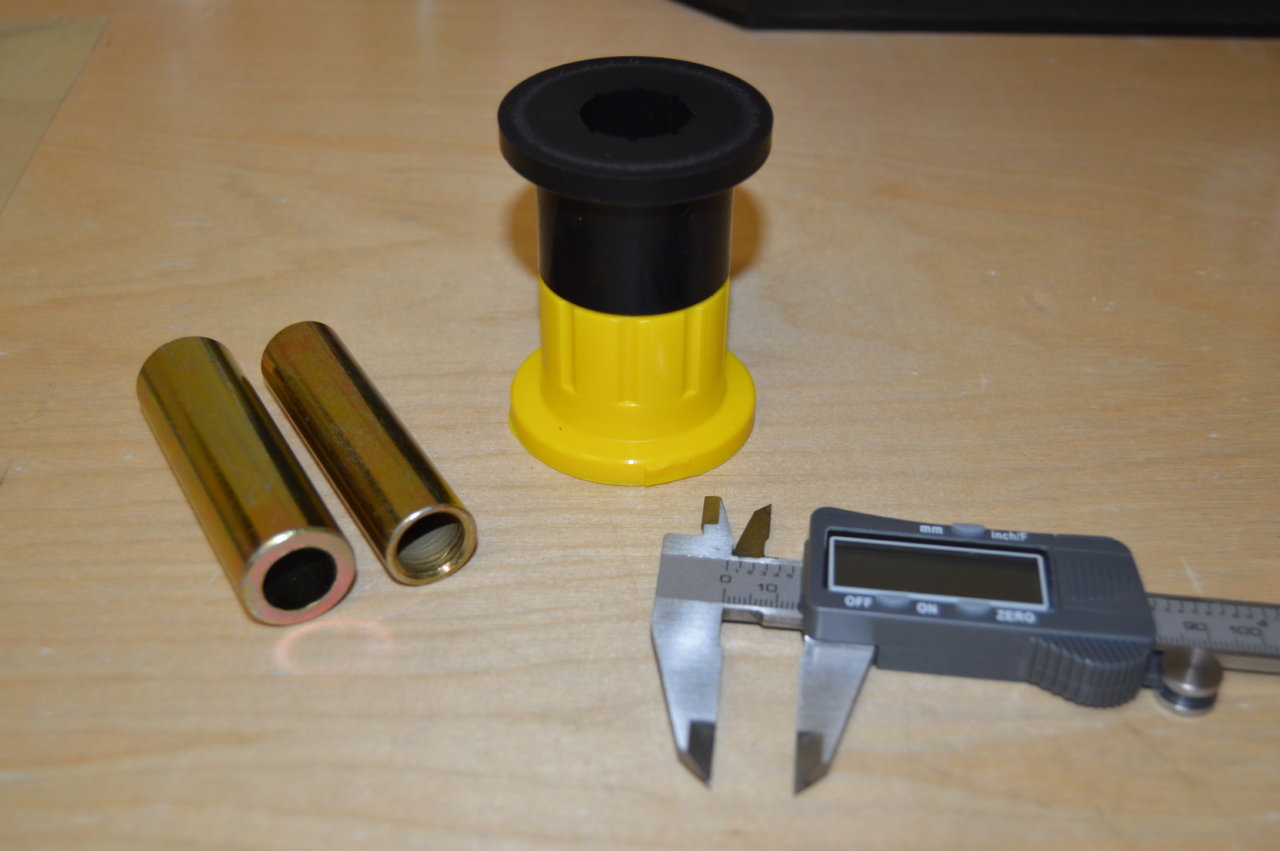

    Not sure of the size, but you’re set if they look like this: https://www.headstrongoffroad.com/store/p513/Full_leaf_pack_bushing_kit.html
    Energy Suspension’s website will probably have the dimensions listed.

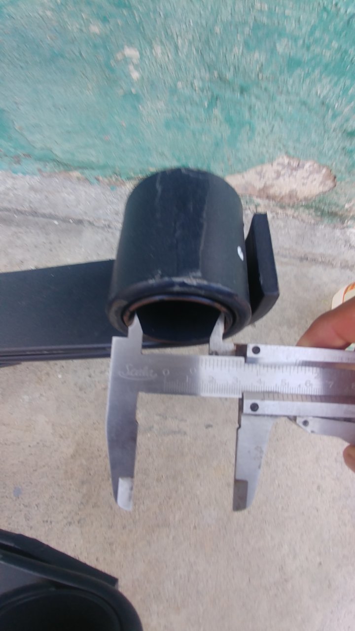

    hmm, Can someone who has the new dakars take the ID measurement and width measurement of the eye?

    3/4 bit blurry 0802180846.jpg

    wow 3/4 of an inch is all both front and rear?

    Yes sir. Front and rear .

    Looks wider than 3/4”.

    Like 1 inch and 9/16th.

    I measured mine that are not on the truck yet and I'm getting 40mm, so just over 1.5 inches.

    Dakars EL095 and EL096 are supposed to use 40mm bushings in forward and rear eyes, such as the Energy Suspension 8.2116 kit.

    40mm looks about right, and actually what is specd in the ARB OME pdf catalog.

    The energy bushings we carry measure the same as the OME bushings (OD for eye of OME packs) and so they work perfectly with the OME Dakars. We prefer to include these in our bundled kits as they include the grease packs, thicker sleeves, and the shackle bushings in case you want those replaced as well (NOTE: not an easy task). Both bushing kits cost about the same and so we prefer to include the Energy bushings in our kits.
