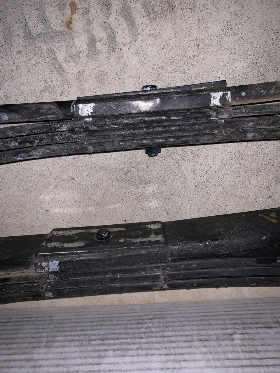

    Hey guys, I noticed on my stock leafs that there are little shims. Installer put Dakars on without them. What has everyone been doing if they have the stock shims? I know some third gens have the shims and some don’t.

    Has anyone taken the leafs apart and reassembled and know the torque specs for the center pin bolt? Good'n tight? Also has anyone installed shims with Dakars? I got the slotted toytec 3 degree shims and wondering if there are any special things that need to be done. I'm assuming you put the new supplied center bolt through the shim, then tighten it all back up again. Kit didn't come with instructions!
