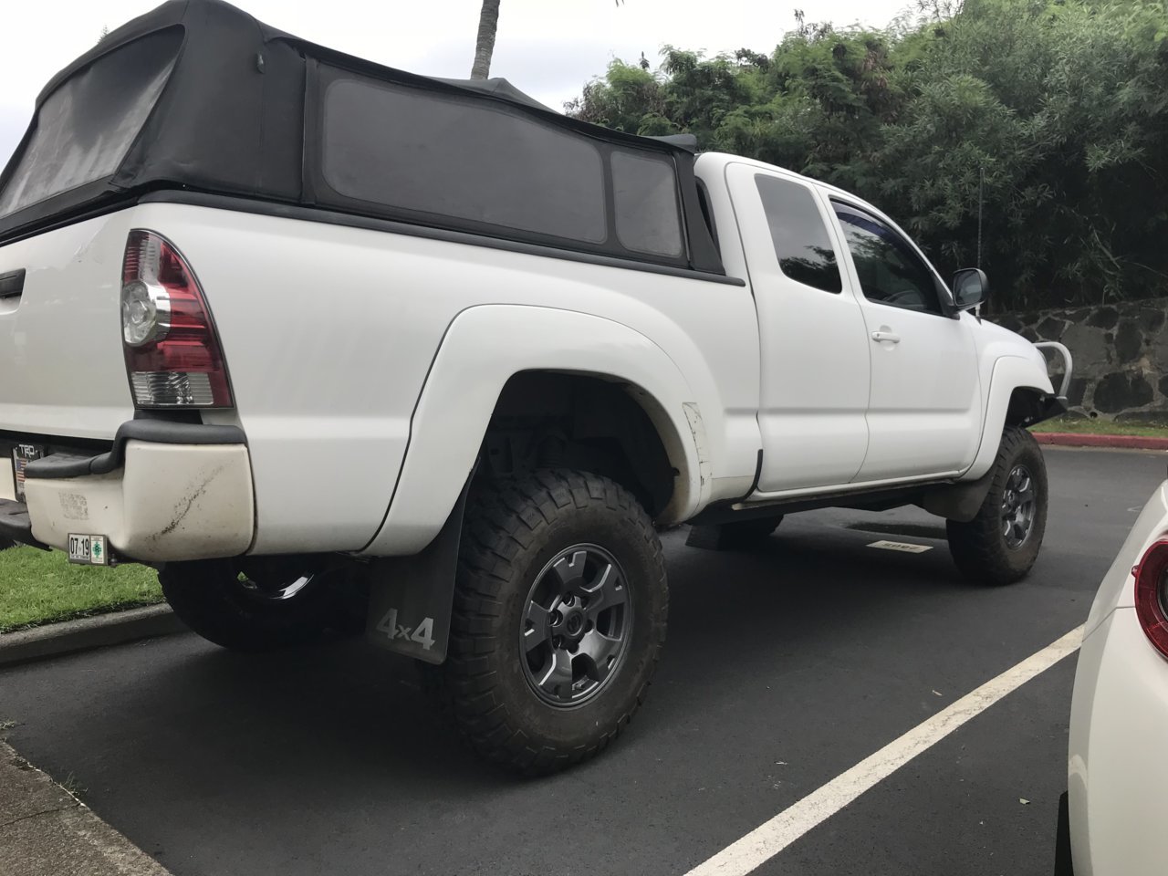

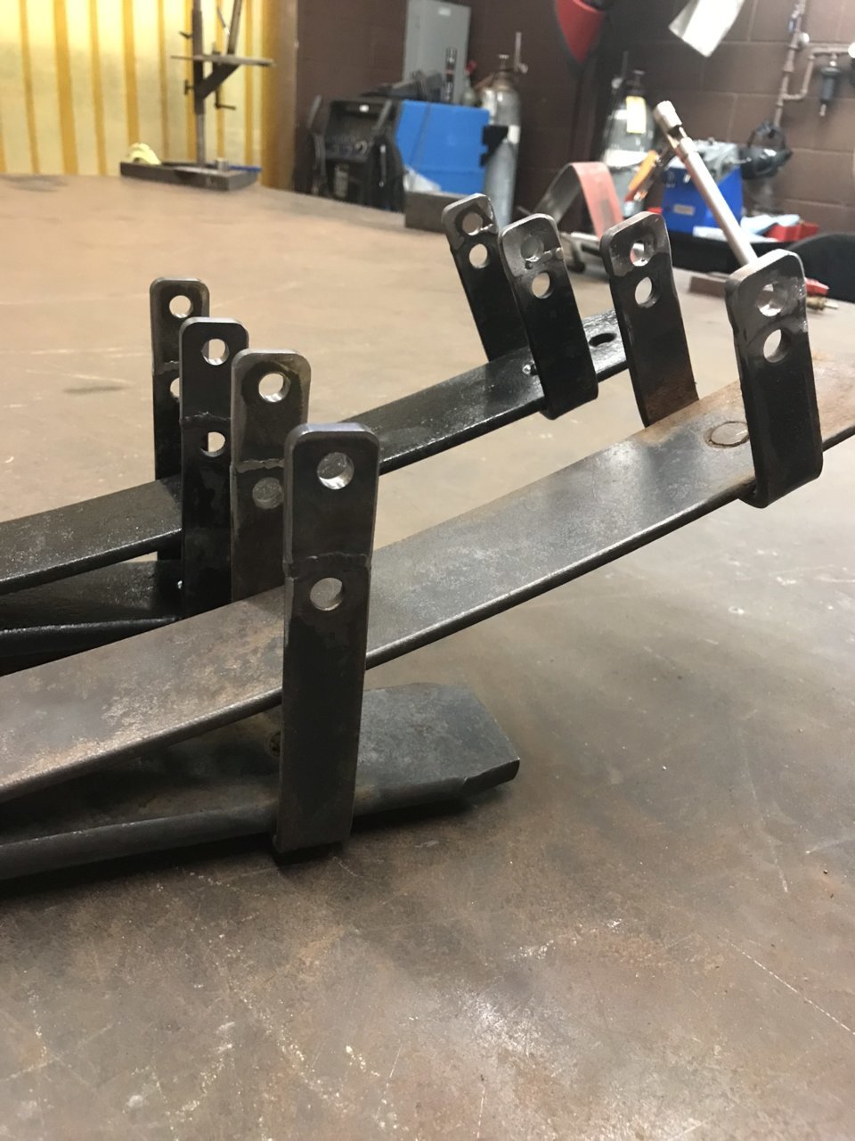

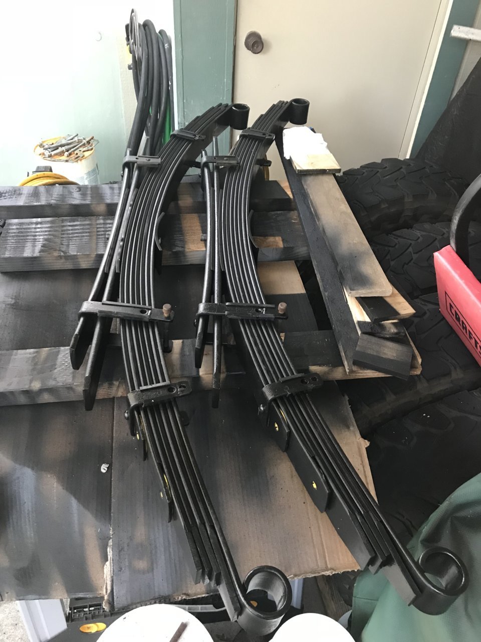

    so I pulled my old dakar pack apart, cleaned, painted, reassembled, added a second AAL, and added liners
    had to add some extensions to the retainer brackets, good thing i’m a welder.
    overall i’m happy, probably more of a true 4” rear lift unloaded. i’ll need to throw my bumper and swing-out along with my un-mounted sliders and full spare to see where it’ll sit.
    took about a week of a few hours each afternoon to prep and paint. used 500F rated engine enamal paint.
    bottom line, got my load capacity back and no sqeaks!
    just waiting for the 4* shims to work out the 8mph take-off vibs
