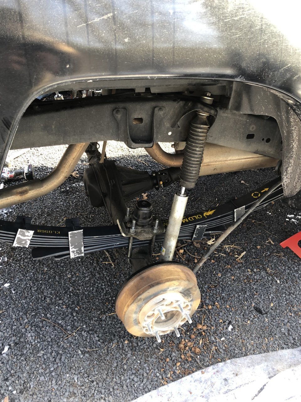

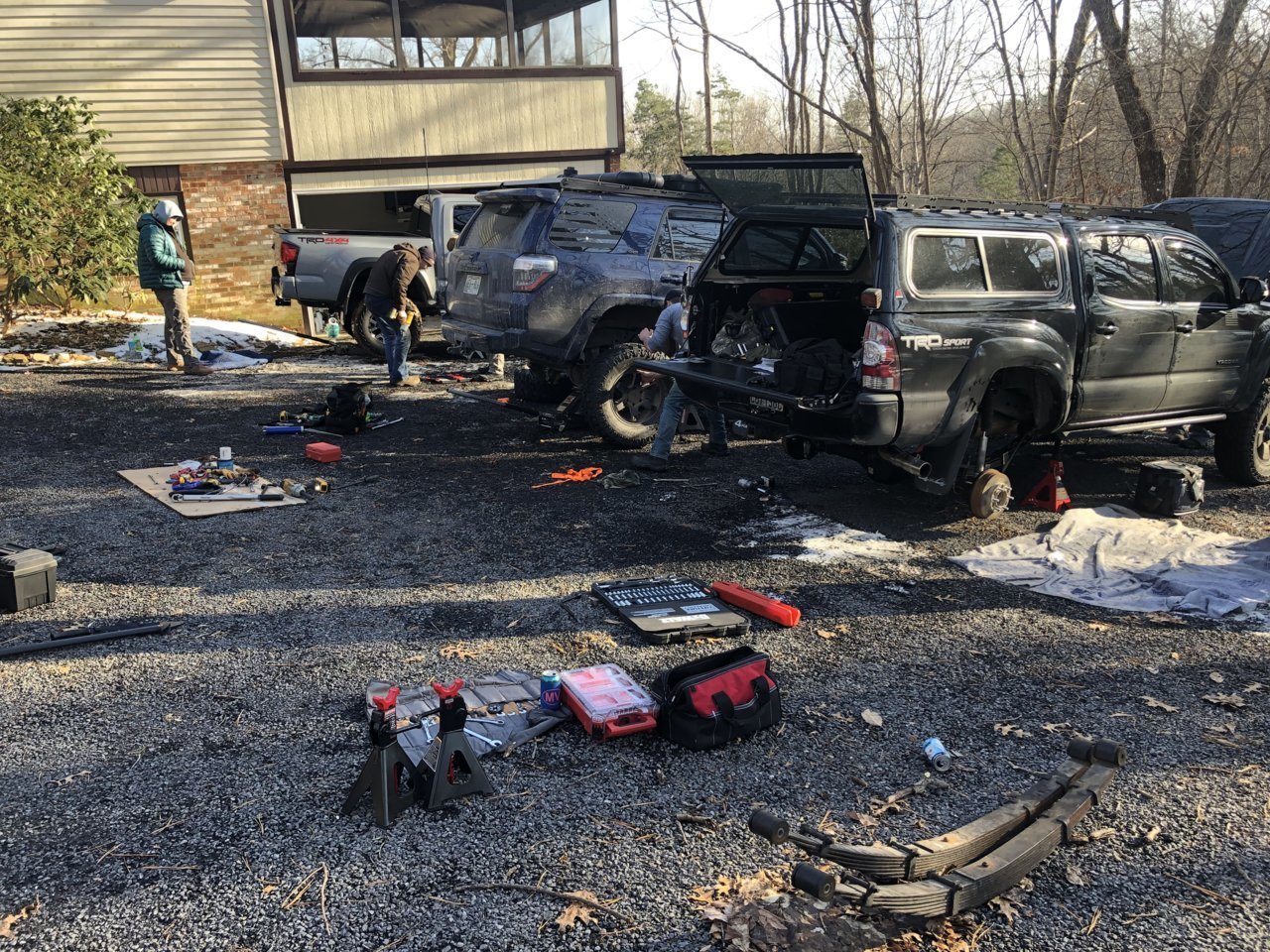

    Thanks @HeadStrong Off-Road for the hookup on the OME EL096R HD packs with energy bushings. Finally got them installed at the NOVA mod day! Ride great and no squeaks.

    Nice video man. Funny stuff. Just an fyi make sure you torque the front and rear leafs bolts once they are resting with full weight of vehicle on them.

    Just loosen and retorque everything after 100 miles or so and it will be fine.
