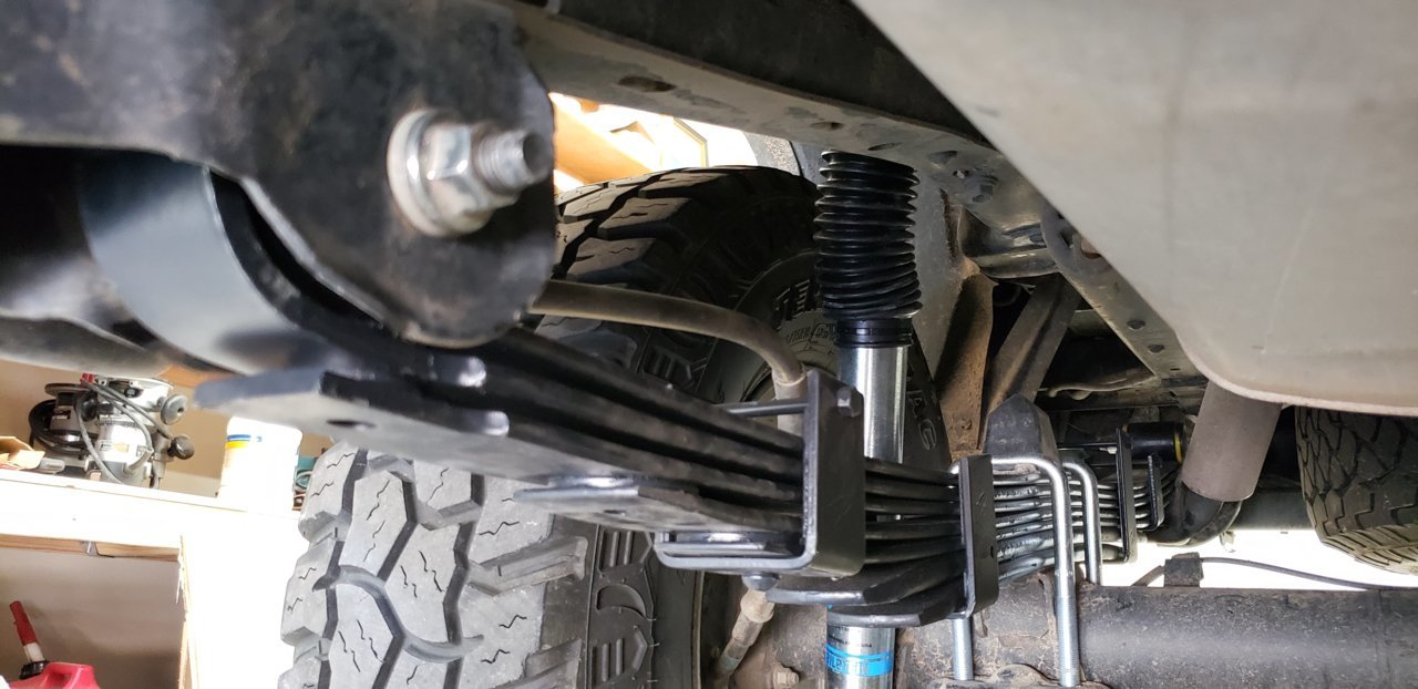

    I'm curious what you'll think of this. I just installed Bilstein 6112 in the front on the 3rd clip and OME Dakar heavy duty springs with Bilstein 5100 in the rear. The ride quality seems good, however when I loaded the bed with 650 pounds it didn't hold the weight well and had a "W" in the springs. Even 350 pounds there's a slight "W". It maintained height, but my understanding is the springs need an arc to work properly, right? I'm working with Wheelers Offroad on a warranty claim. Is this a common problem? What do you guys think?
    I'm getting a Vagabond Drifter 8ish months and after doing a bit of research it's seems those guys run Deaver Stage 3 or Alcan.

    Extremely common with dakars. That’s just one of their “quirks”. If it maintains advertised height, then don’t worry about it.

    Yikes! I have the same EL096R and haven’t experienced that.
