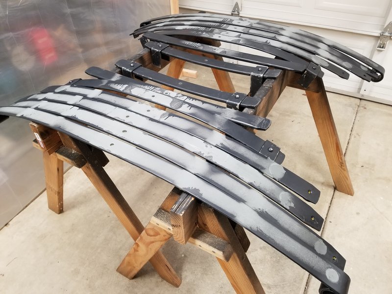

    Got my set of 096R's on Monday and they look beefy but I'm glad I planned to pull the pack apart and clean up the paint from the start. The paint was already dinged up pretty good from shipping and after I split the pack open I found that they do the top coat after the assembled it so in between leafs it is only a thin coat of primer, most of which came off with a light rub down of scotchbrite.
    Not mad about it because I kind of knew the paint wasn't the best going in and I'm getting the best set of leafs for the price but I'm surprised that it's only light primer in between. Just a note for anyone else that gets them, it might be worth a little extra work on the front end to make them last.

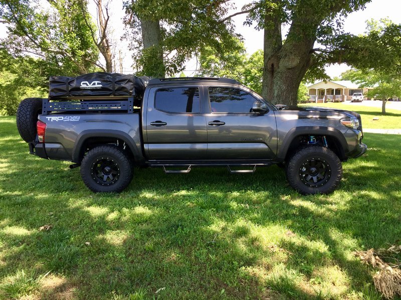

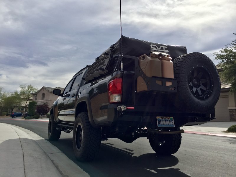

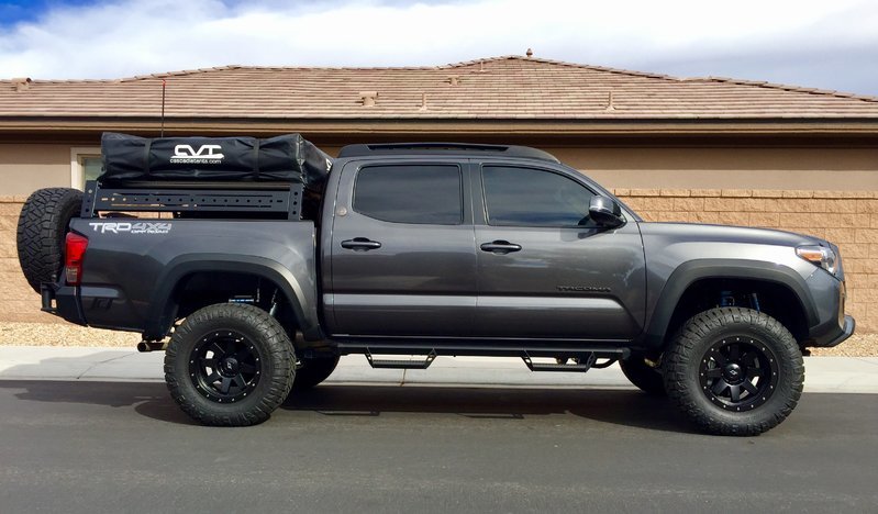

    Before (using Icon AAL)
    After (Dakar 096R)

    I'm very happy with how these turned out! The ride is perfect as well!
    Bottom of fender to center hub measurements:
    23in- Front
    24in- Rear
    I will be adding 1" longer shock strut mounts to my rear king shocks to get the full droop back. Also will need to add extended brake lines as well.

    Are the round grey things the "new" isolator pads between the leaves?
  13. Jun 13, 2017 at 11:01 PM
    #73
    JeffRoyJenkins
    JeffRoyJenkins Essentially Non-Essential
    Dec 18, 2013
    #118807
    2,104
    Jeff
    Lake Stevens, WA
    2024 F-150 XLT PowerBoost
    That's where they were resting on the bottom side of the spring, the isolators are little yellow disks on the top side of springs that appear to be made of Teflon impregnated plastic of some kind. The grey circles are just primer where the top coat didn't get to because the isolator was resting against it when the springs were painted after being fully assembled.
