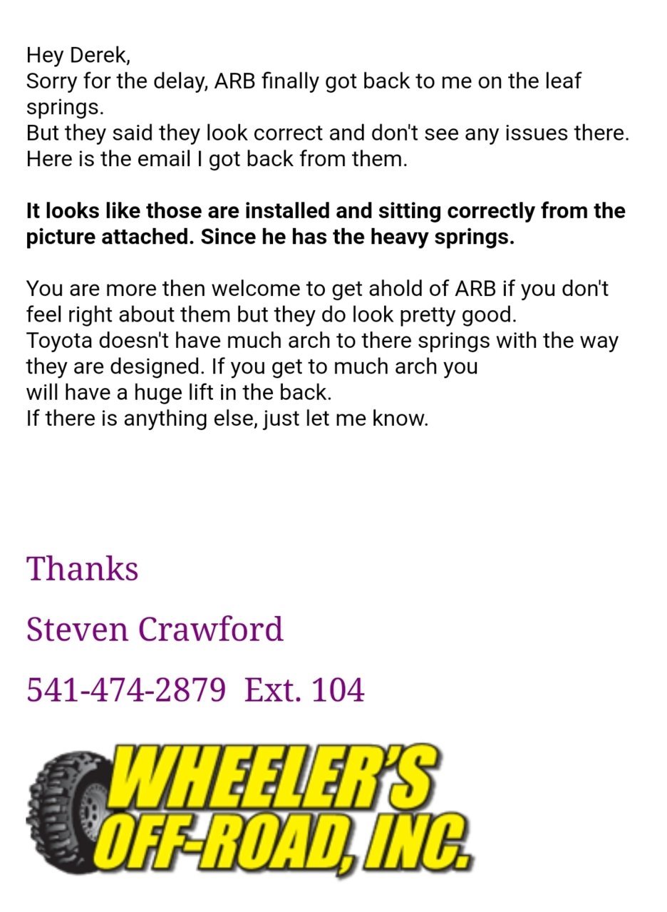

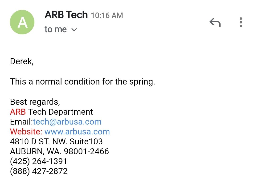

    Here's what I got from Wheelers Offroad who talked to ARB and here's what I got from ARB direct. They both said it's good.Screenshot_20190711-135303_Gmail.jpg Screenshot_20190711-135234_Gmail.jpg

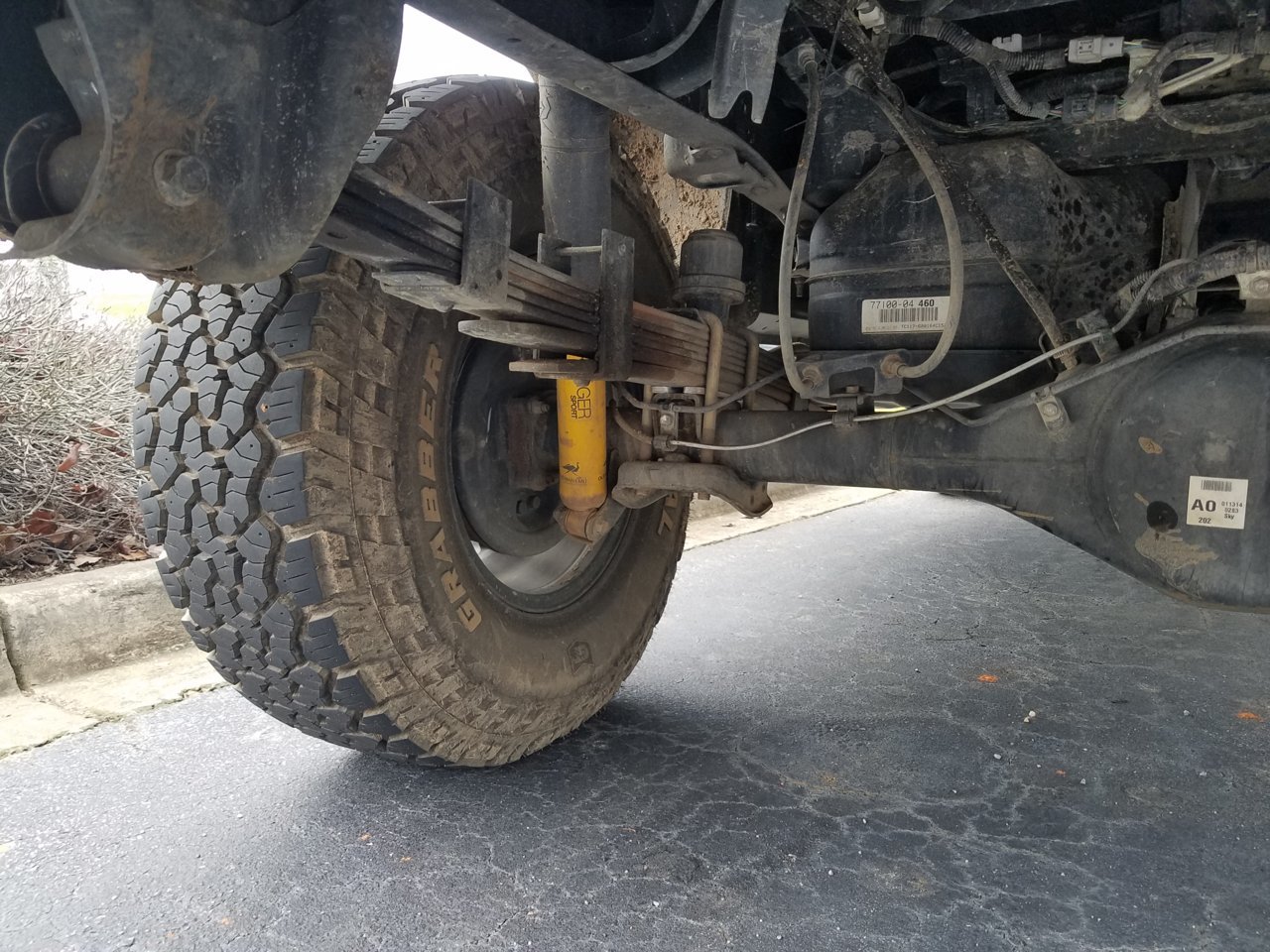

    I have the W look to my Dakars as well, seems to work fine even if it looks weird. 20181207_083251.jpg

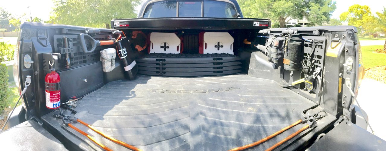

    All my recovery gear and RotoPax (2 fuel and 2 potable water) cans keep the HD comfy.

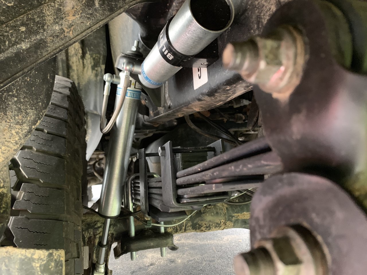

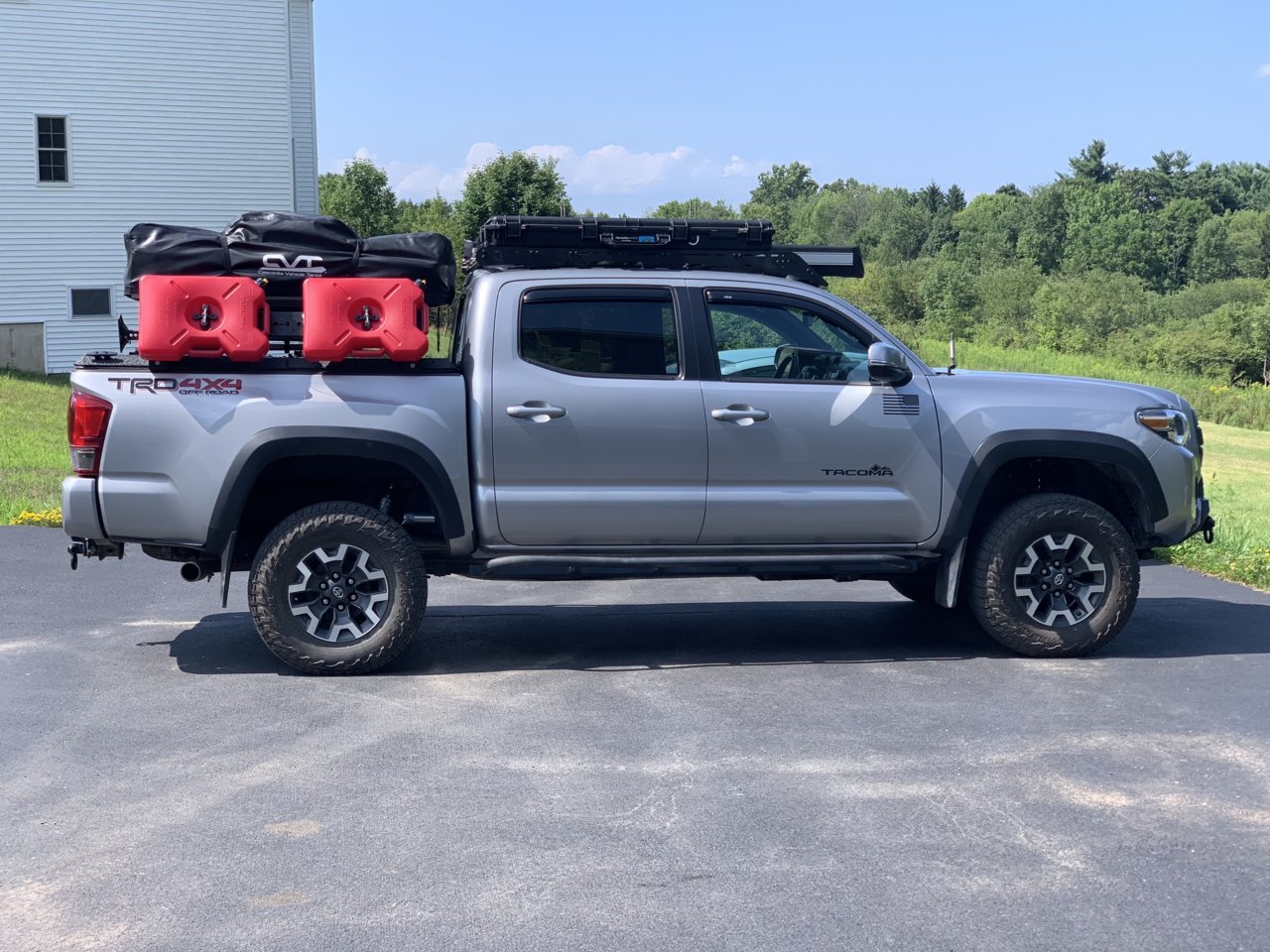

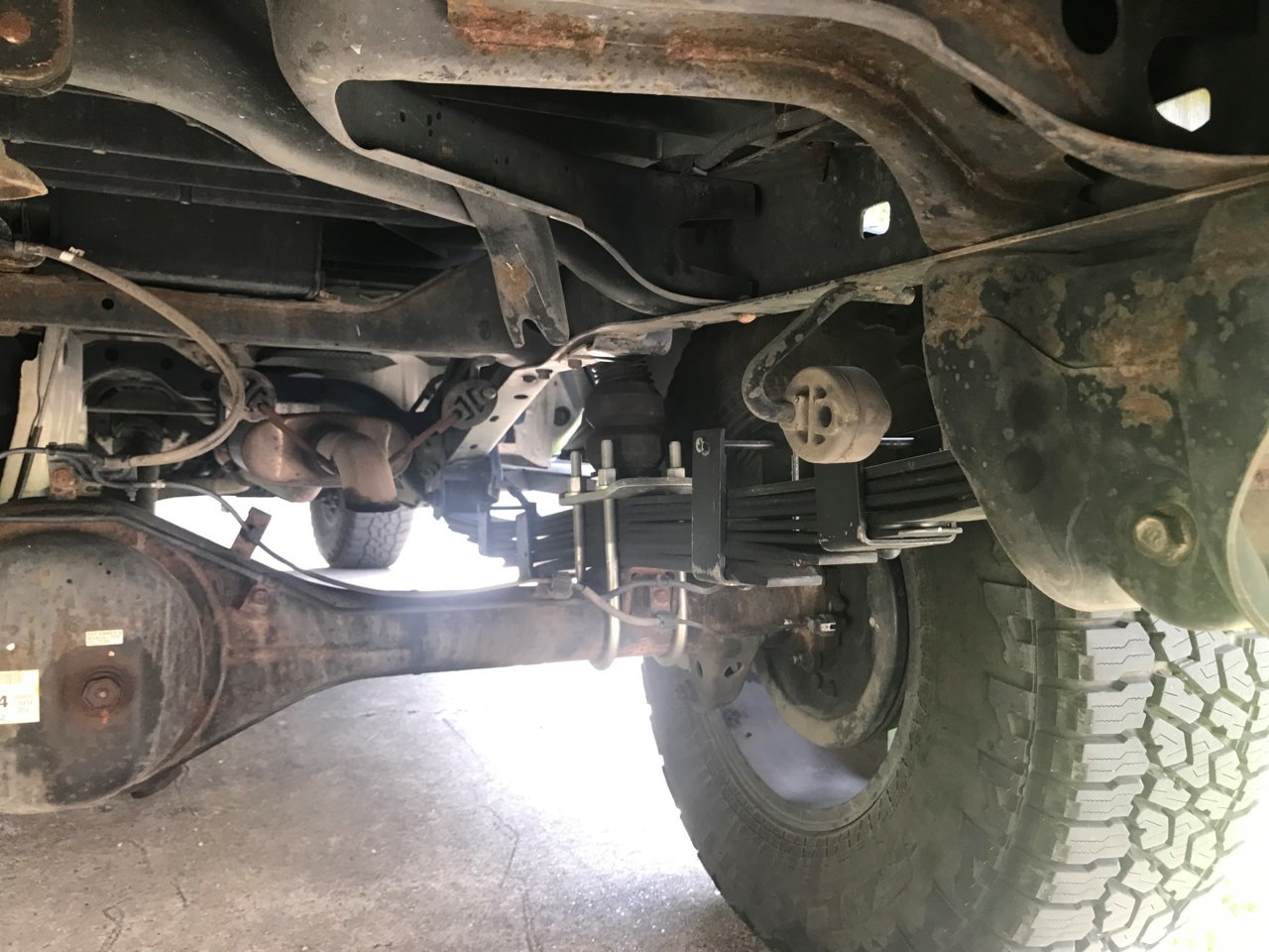

    So I have the medium duty Dakars paired with 5160s in the rear. I have a bed rack (61 pounds), a RTT (128 pounds), and sliders which I'm sure some of the weight (140 pounds) gets distributed to the rear axle. Right now I measure 22.5" on the left rear wheel, and 23.25" on the right rear wheel. I did not add any shims and the truck has zero vibrations, something I would very much like to keep. Does that amount of lift seem acceptable or too low? I guess I should look at the 23.25" number as the normal and the 22.5" from the lean as the variance in which case I gained 1.25" over stock height. I had read though that the medium duty Dakar could support ~300 pounds before the lift height of the claimed 2" was impacted. I could add the El46XL add a leaf, but I fear if I do that I will get driveline vibrations, especially when I take off the bed rack and tent, and I'll need to go down that rabbit hole trying to fix that with trial and error to find the right shim.
    Also, I got under the truck and noticed the leaf pack has a distinct 'W' shape to it. I got really nervous but after reading here this seems normal? Can anyone confirm that my leaf packs look the way they're supposed to?
    Side shot of my truck (the good side):

    From what I have read on this thread and heard from others with the HD Dakars, your leafs look good. Yours actually look slightly better than mine.
    Great looking rig btw :thumbsup:
