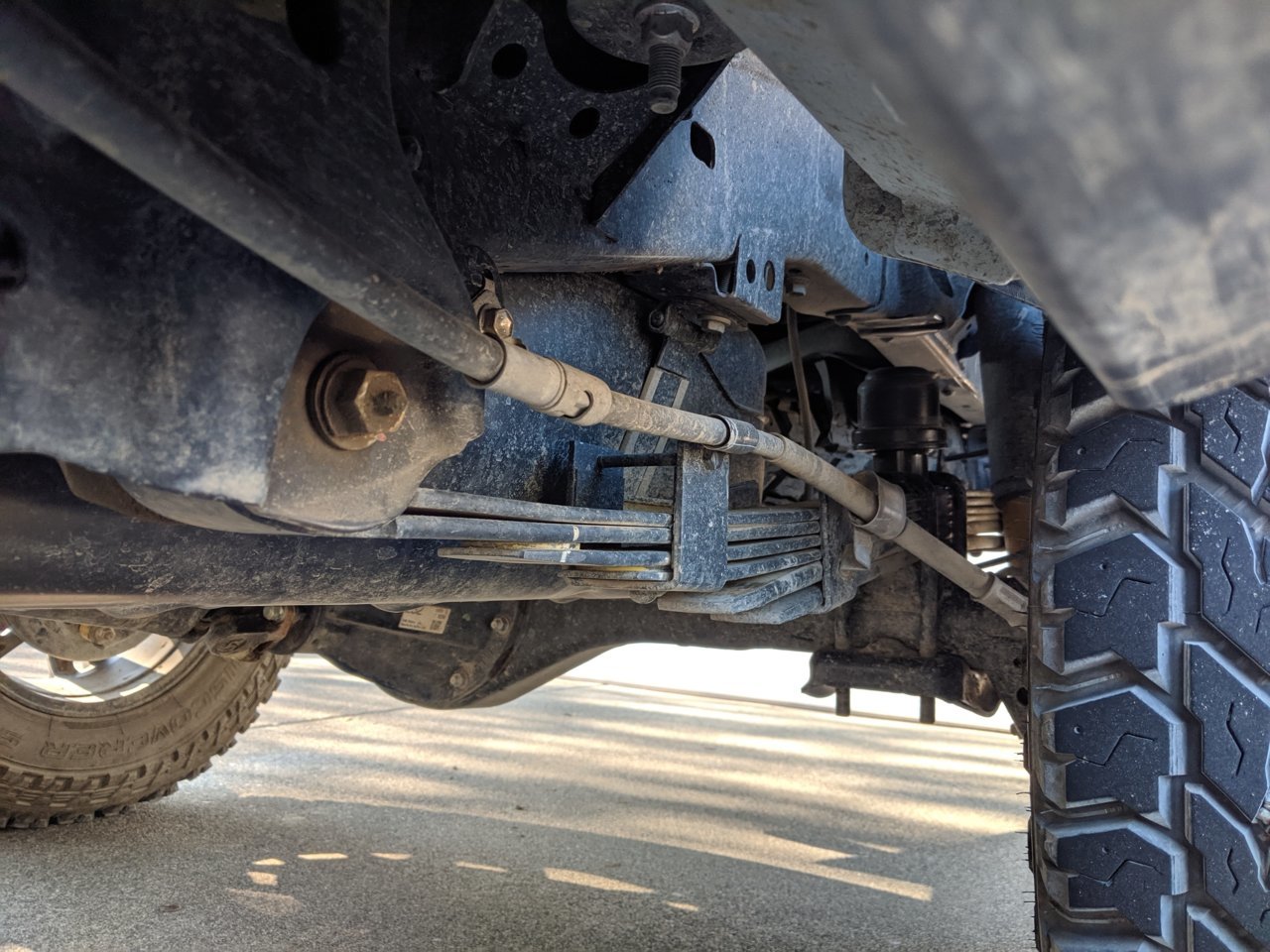

    Just wanted to say don't forget to lube up your leafs every now again. Mine were getting squeaky so I jacked up the rear and put it on jack stands then removed the tires to make it easier to get in there. For some reason I thought they might already have grease from the factory but I was wrong. Good thing they've only been on for a month or so. Also my friend that is a master tech at Toyota didn't even know these are greasable. I sent him a pick of mine with no grease and his exact words were 'you can grease those things? I never do it when I install them!' There is a video some where that shows how to do it but I couldn't find it. You need 2 pry bars and a flat head screw driver. You can only do a few of them with out having to pry the leafs apart but it's easier since you have to do this to get them all. You just pry the one you want to add grease to and leave a pry bar in between the leaves then take the flat head with some grease on it and smear it on the puck. Just remember Do Not put your finger in there to grease it because the pry bar could slip and you will be left in serious pain and possibly without part of your finger. Continue the process for the rest of the pucks and your done. This is also a great time to check the torque on your ubolts and leaf ends since your right there and the tire is off.
