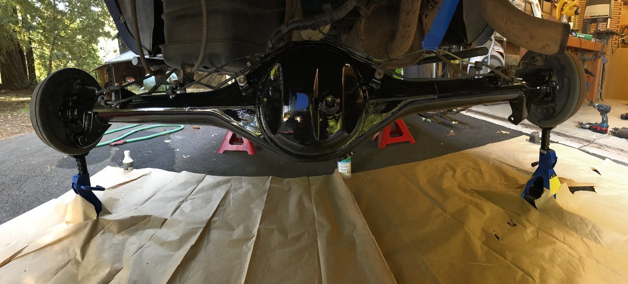

    How does the POR-15 hold up? Looks great!

    So far so good! Goes on pretty easy too. I’ll be under there a bunch in a couple weeks getting the new bumper on so I’ll clean it up and inspect.

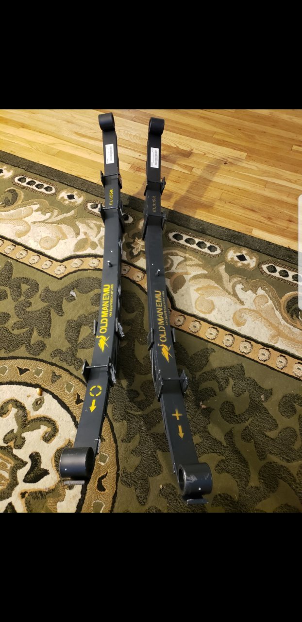

    Should medium duty dakars have a plus sign on the leaf or an O?

    The driver side of Tacoma is heavier by nature. My Dakar mediums came one as + one as 0. Put the + on the driver side. I posted this below in a different thread.
    + = over spec
    - = under spec
    0 = at spec
    ready6delta likes this.

    Awesome, thanks for the info Dave. Guess I got lucky then because I did not know this and put the plus on the drivers side.
    Side note, my drivers side is now 3/4 taller than the passenger side in the rear. Was dead even before. Is this pretty common? Hoping it will settle some. I'll measure again after I go for a ride.

    My medium duty’s both came with - signs.

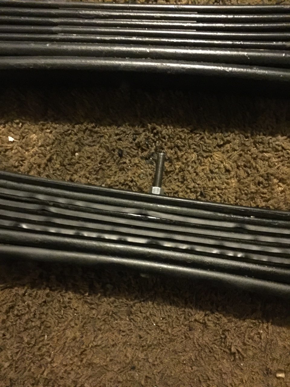

    did one of the two EL096R's tonight. sand, prime, paint and removed the 4 thin metal spacers in place of leaf liners that go end to end. Also added the extra leaf given the weigh I carry. So it's basically an 8 pack versus some of the other players 9-10 leaf packs. Thickness on the EL096R as received was 2 5/8 inches and after installing the extra leaf and leaf liners it's 3 1/4 inches thick. Should be good. Could only source a 5 inch centre pin so I'll need to trim that.

    This is the leaf liner I used. Got it at Speedway motors. it's the perfect width and has a bit of a side wall. I'm sure it will rip off over time but I've heard good things about toning down the squeak using this stuff.
