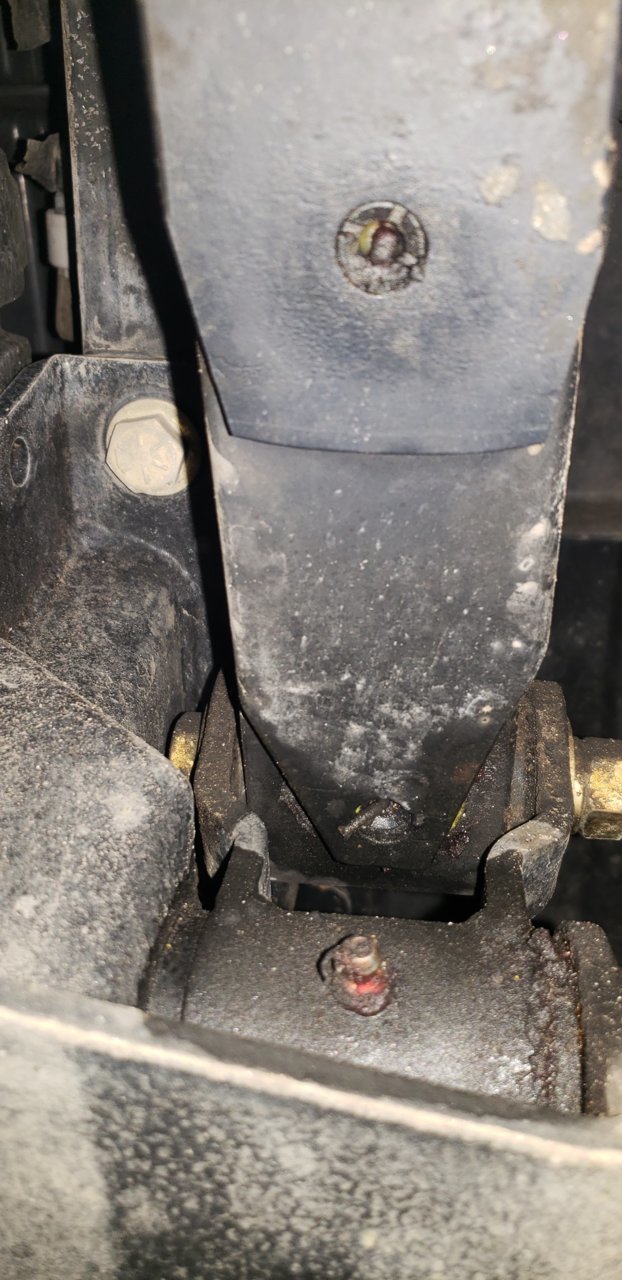

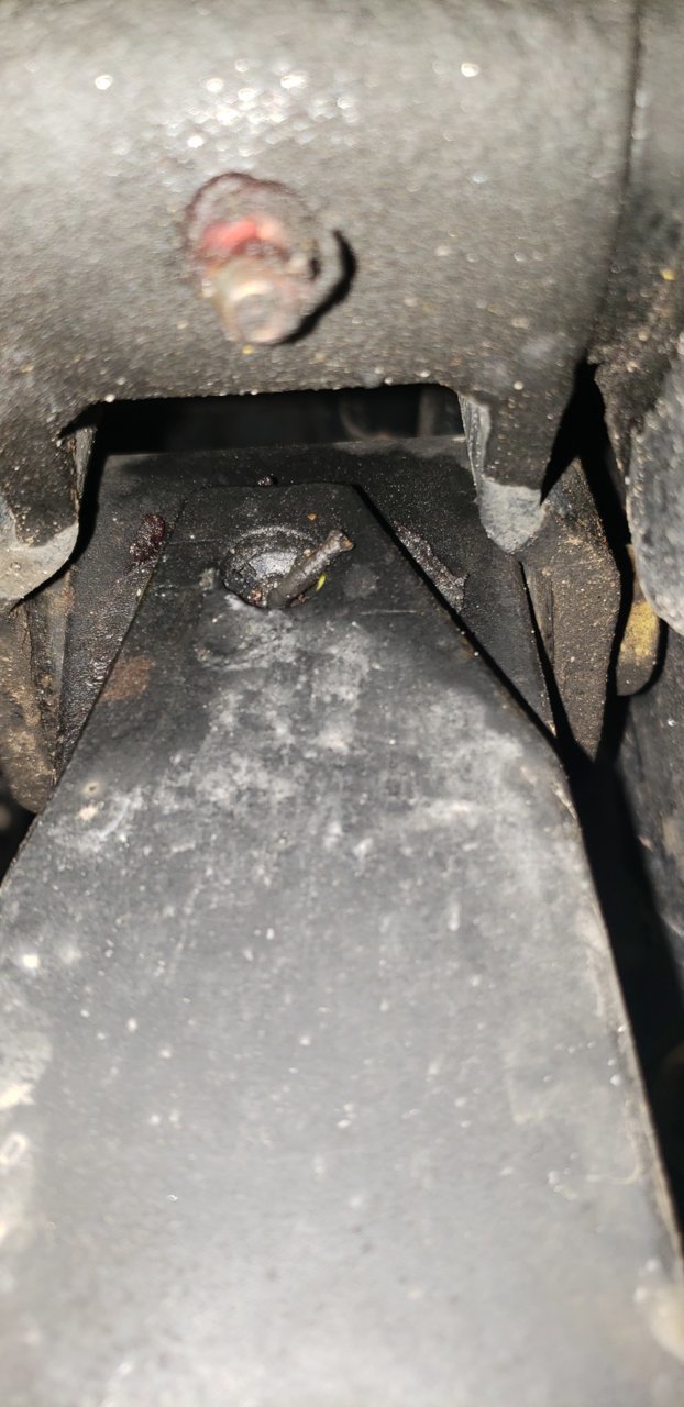

    2nd. refer to page #42 there is a pic of the cut leaf. after hearing some random noise from rear end while wheeling I took a look and had some grooves notched into shackle. I will be cutting the leaf as well. anyone have experience doing this with leaf's installed? lift truck and let rear suspension droop, cut with zip cut to shape of 3rd leaf? does the shackle get in the way?

    You can I would lift it off the ground to take weight off the springs then separate the leafs and put a block of wood under the one you want to cut. This will give you some room and you won't cut into the leaf below it. I trimmed mine down to the anti friction pad because I didn't want to lose it and haven't had any rubbing since. Oh yeah I have BAMF hangars and shackles if that matters. 20200422_110926.jpg 20200422_110837.jpg

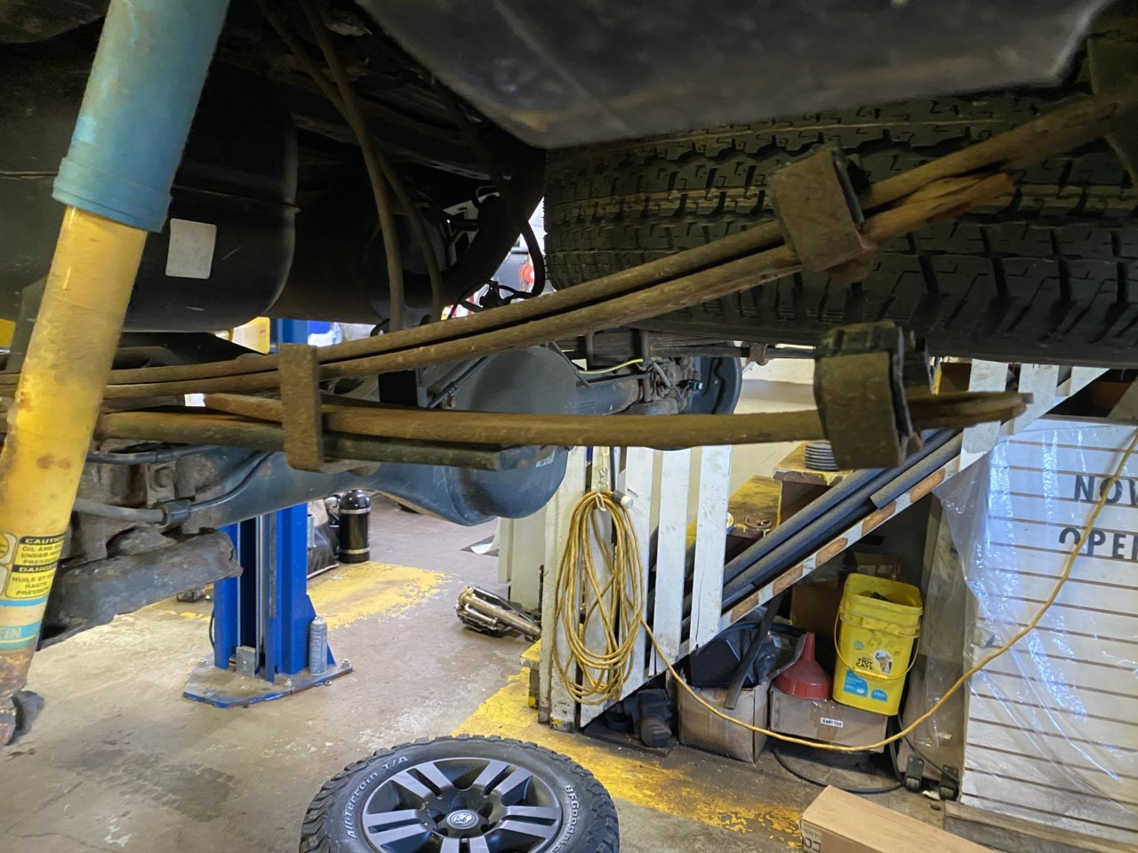

    hey all, getting my eibach pro lift kit installed right now on my 2012. was originally going with icon 1.5 aal in the rear but now finding out that i have a broken spring :( so returning the icon aal and I'm replacing the pack with the EL095R. wondering if the eibach rear shock will be ok or if there is anything i have to worry about.IMG_1139-preview.jpg

    I trimmed mine yesterday like your picture when I was installing, but somehow still got one side 2nd leaf to get stuck below the hanger and jammed all up and under pressure while hooking the front eye up. How did you cut the passenger side while on? There was no way I could get a grinder in there with the exhaust. They need to fix that damn design. I would probably not recommend them just for that reason. I knew I would be trimming and still ended up pissed about it.

    Any extended length shock (+2-3" above oem) should be fine. There's no clearance issues or anything

    I fully removed mine to make it easier to chop the hangar off so that made it easier.
