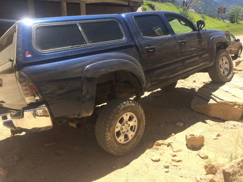

    I went from the TSB pack with ToyTec add a leaf, spacers, and axle shims. Sitting @ 24.5 hub to fender.
    This weekend I installed the EL096R's with Bilstein 5100's. NO MORE SPACERS!!! Sitting @ 25.5 hub to fender. 4" lift over stock. IMG_1151.jpg I am very happy with the ride as well as the flex!

    That's flex with just the Dakar? Pretty impressive, I haven't flexed mine

    Ya buddy! The rear was just about to come up when I stopped there for a pic.

    What shocks are you running in the rear?

    Extended travel Bilstein 5100's.

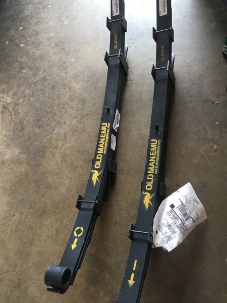

    I was thinking the same 60# each for a delivery person to carry x2
    I'm in the same boat, planning to paint but have never taken them apart... IMG_5320.jpg
    anyone know what the "O" and "-" indicators are for?

    My understanding is that the '0' means they are right on spec, and the '-' means slightly under spec (so just a bit softer). A '+' would mean they are slightly over spec. When I got my CS047R's from Wheelers a couple years ago they were both over spec ('+') so it didn't matter which side they went on, but since you have the choice, I'd put the slightly stiffer '0' on the drivers side to combat taco lean.
    But I'm not an expert, so people better in the know please correct me if Im wrong about this.
