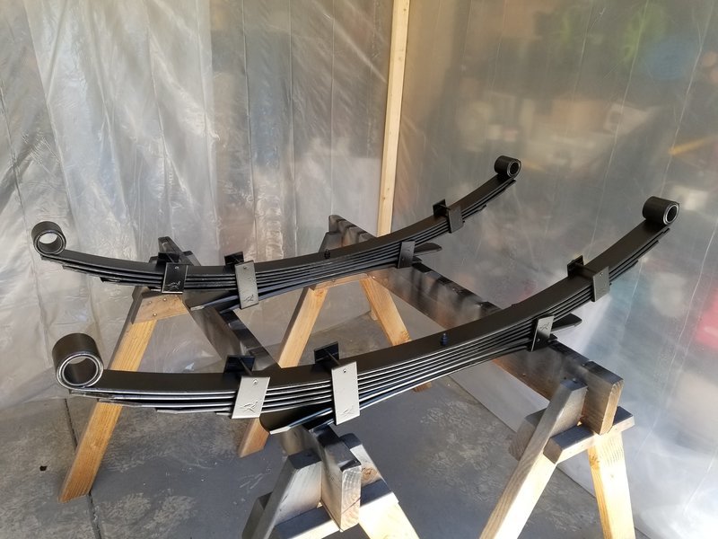

    It's mostly that and I wanted them to at least look new when I installed them even if I know it won't last long. I wasn't going to do it at first but when the factory paint was peeling off with the shipping labels I pulled off I figured it wouldn't be a bad idea to give it an extra coat for protection.
    Besides that I'm not able to install them quite yet and had just built a makeshift paint booth for my bumpers and figured I might as well put it to use doing something in the mean time.

    Springs are just springs but compared to how they shipped I think they turned out looking pretty good.

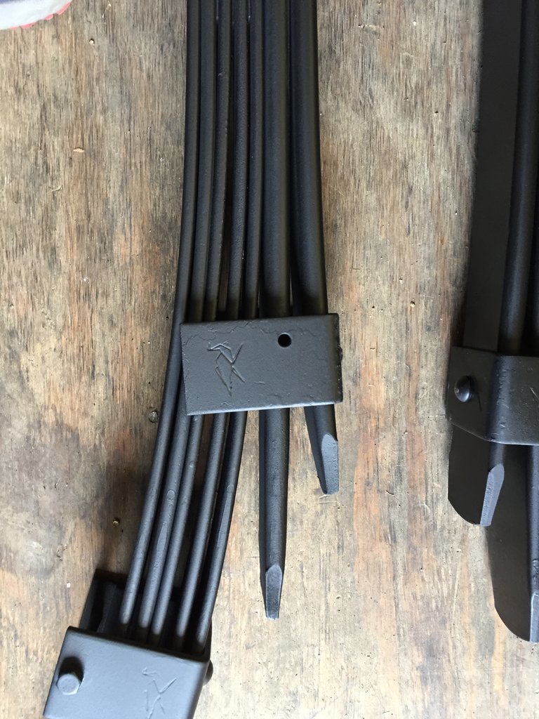

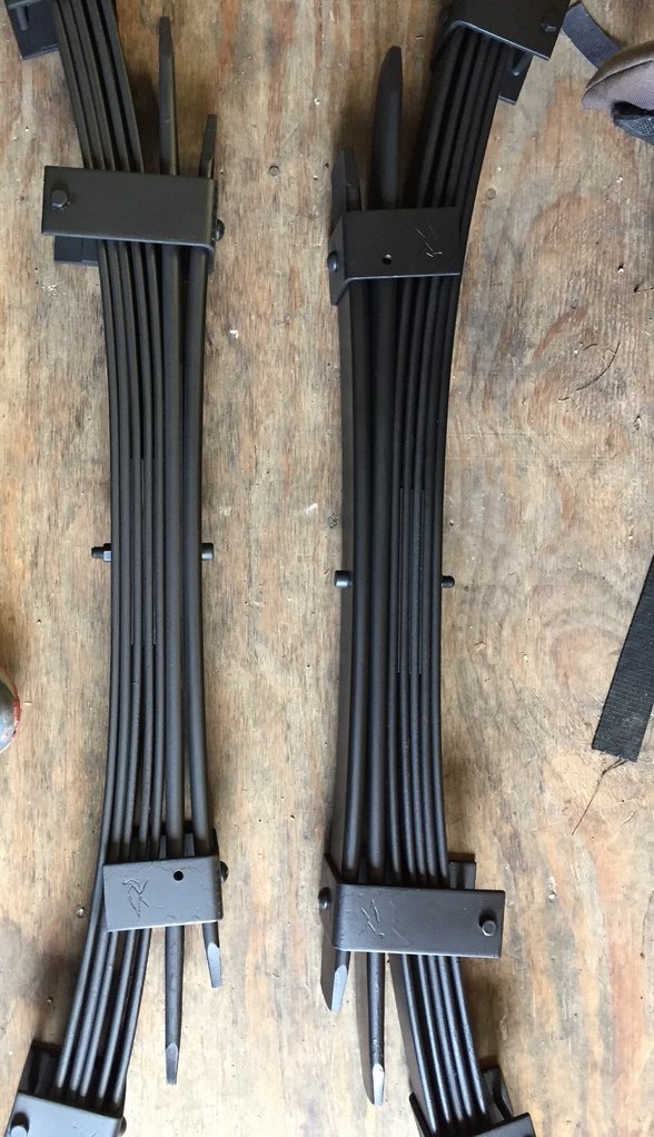

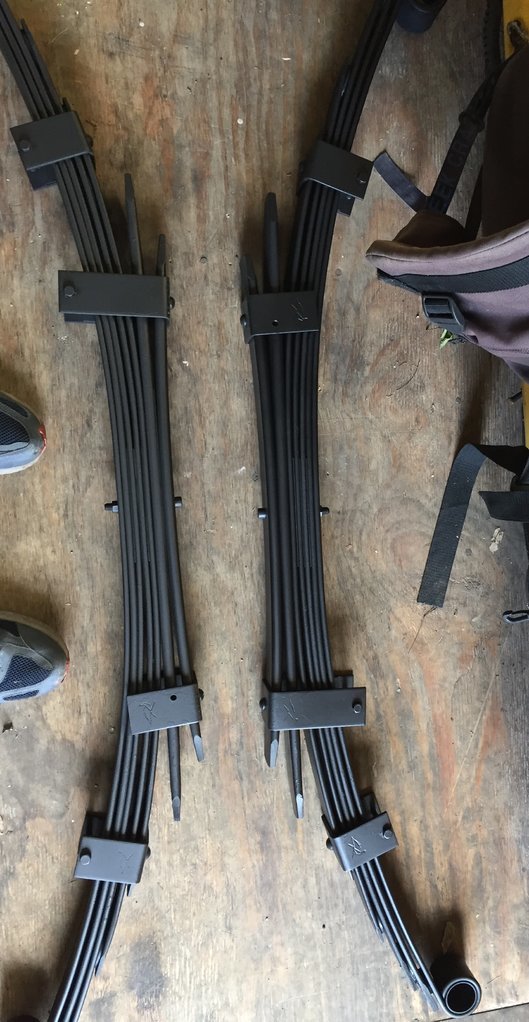

    Took mine apart and painted them. When I put them back together something tells me that the top overload leaf (the one up from the very bottom) is on wrong. That top overload leaf looks fairly flat but I think that has a slight arch. Is it supposed to go with the arch facing up or down ? I put it with the arch upwards, like the rest of the leafs. I'll attach some pics. Let me know if this looks right or wrong ? TIA

    Yeah It looks like you have them in upside down, the overloads should arch down. When I painted mine I tried to be very meticulous to make sure I laid them out in order and didn't flip them over or spin them around at all unless I did all of them... and I still somehow got one of the overloads flipped upside when I went to put them back together, luckily I noticed it before I bolted them together.

    Thanks , good thing I don't have them installed. Just have to pull the center pin and clamp bolts flip and done !

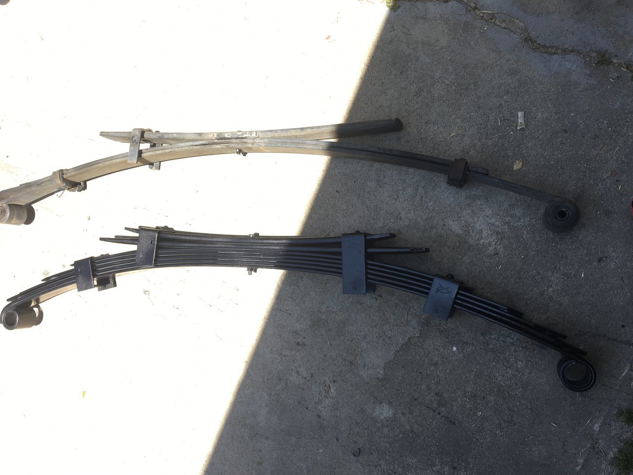

    Finally got around to installing the hd pack yesterday thanks again @HeadStrong Off-Road pleased with the ride even with no load... top stock, bottom with Dakars4A5D20D1-D081-47FA-90AE-F01B25AC07A8.jpg
