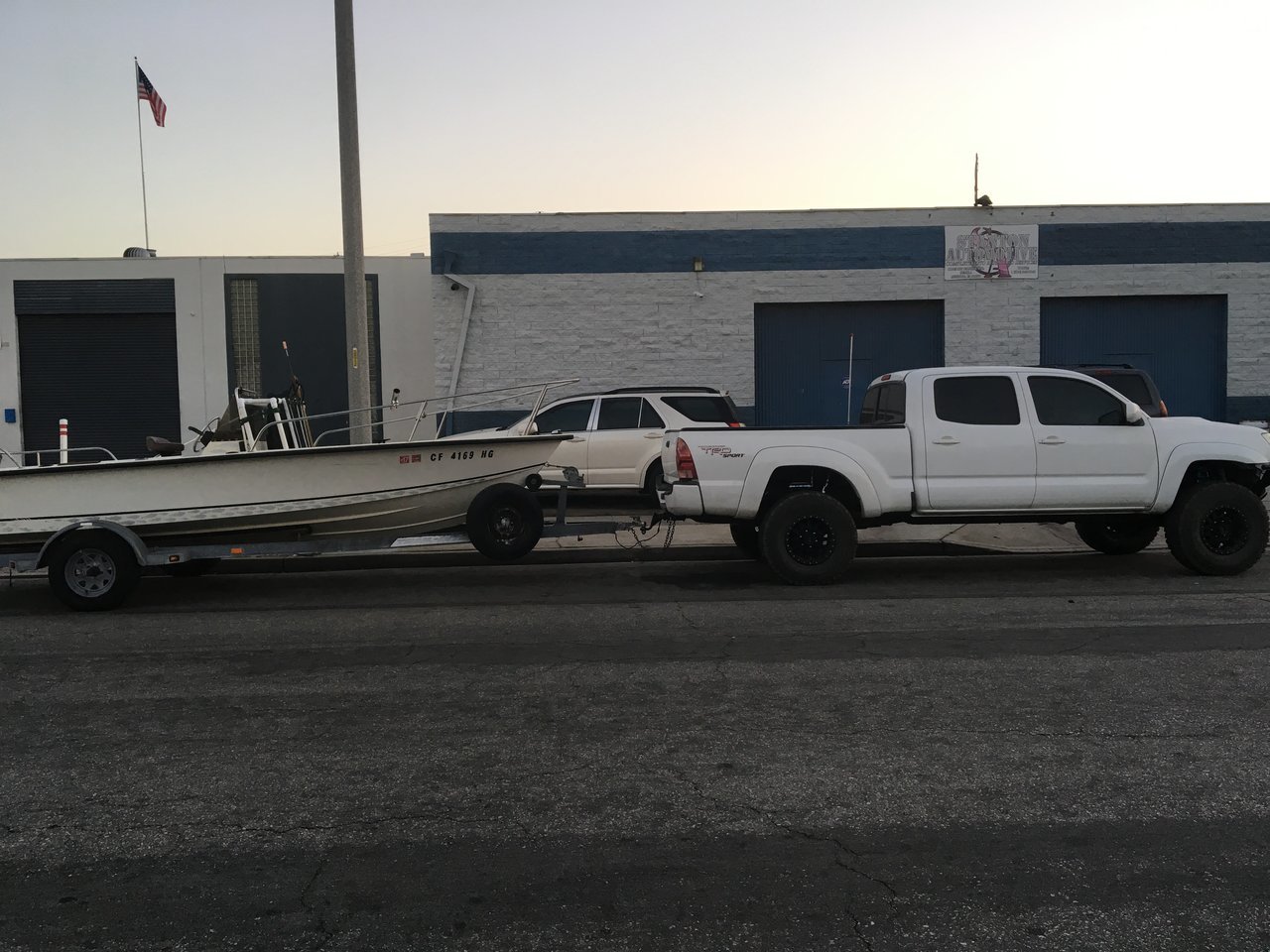

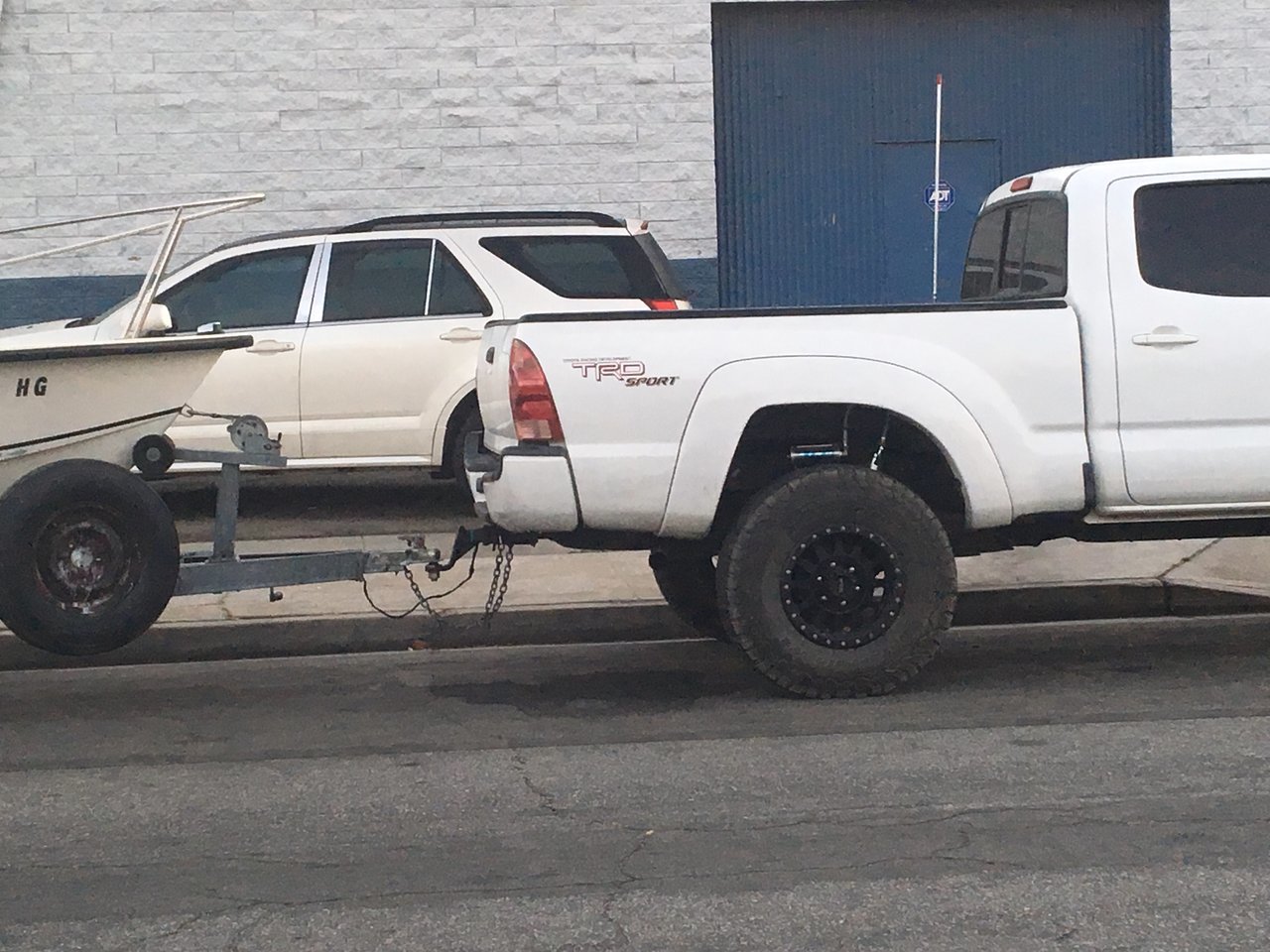

    Towed a little yesterday... small 18ft still felt fine
