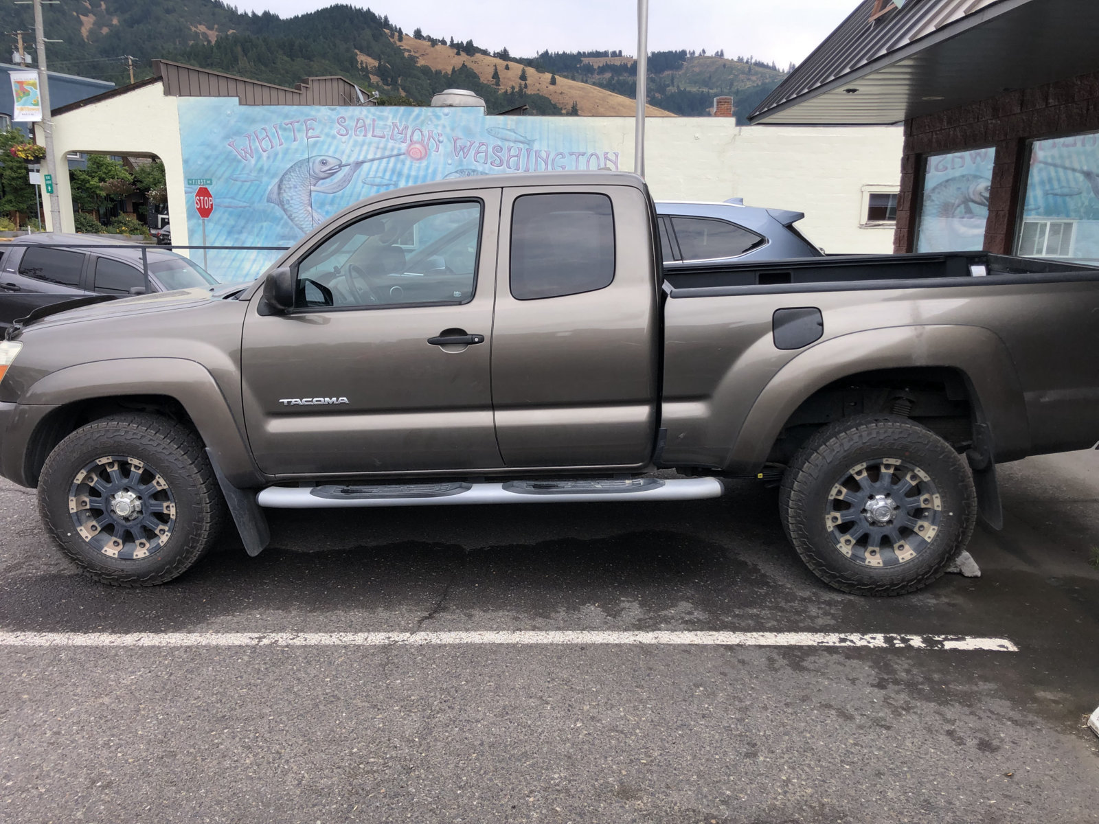

    Was in a bit of a rush to get my suspension upgraded before a camping trip and I did not do my due diligence and just trusted the shop owner that a medium duty OME leaf pack would not raise the rear end of my truck. When I picked up the truck he said, 'sorry, but it raised your truck 2 inches". (actually 3-4"). So, it works great when my camper is loaded, but not loaded it feels weird to drive (a bit unsafe?) and the front wheels graze the wheel wells when turning sharp in reverse. I drive the truck a lot w/o the camper so it is going to be a problem. Suggestions? I'm still working with the shop. I think it was an honest error and they are taking responsibility, but I need some 3rd party edu. TIA

    The camper is loaded for the summer so I won't be able to get a picture until October.

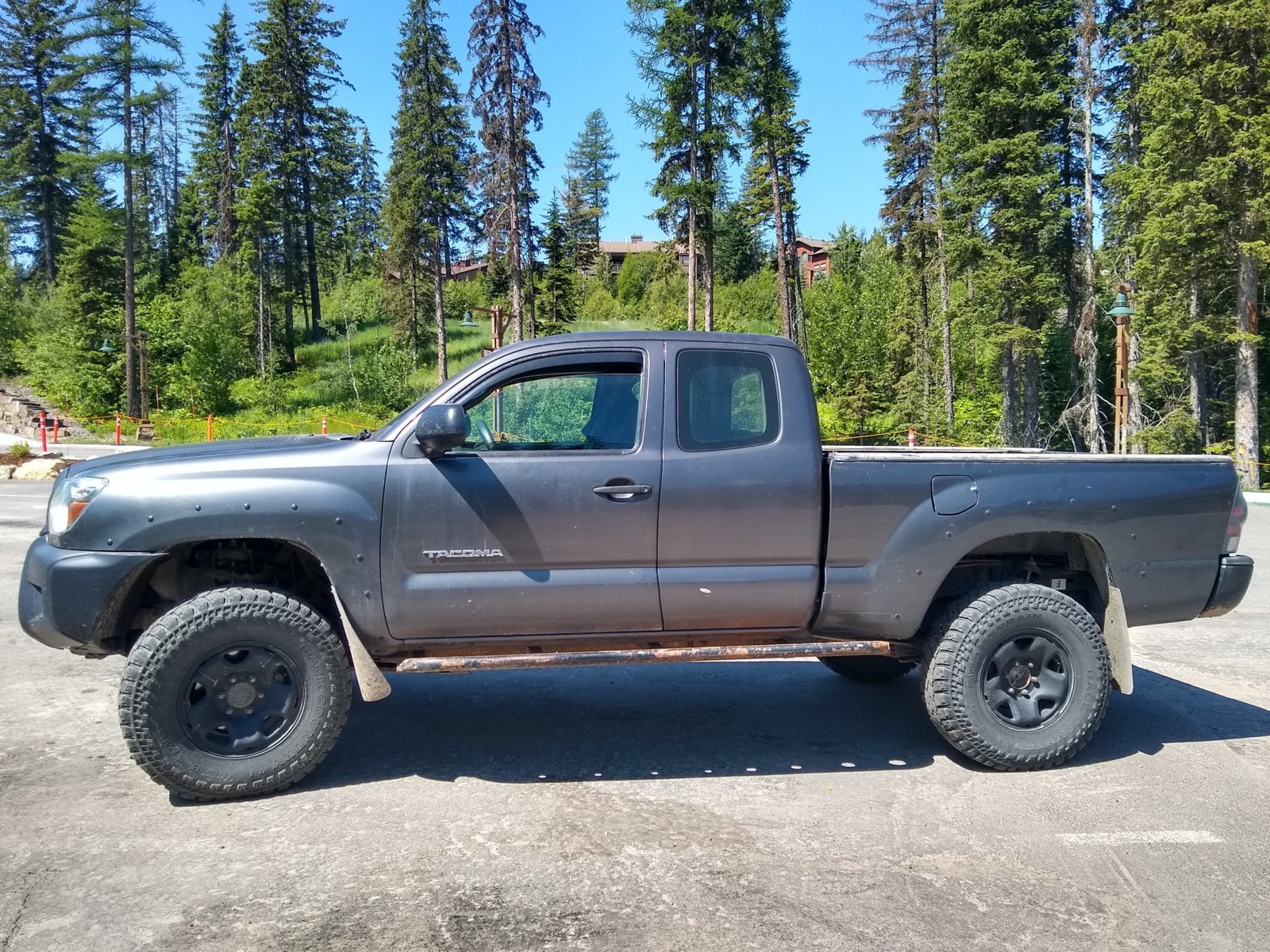

    I have the HD leaf pack too. If you pull the leaf packs off, you can remove the second leaf from the bottom to lose a bit of height. Or just give the front a bit more lift. I have 3" up front plus 1/2" body lift. The rear springs still give me 2"+ of rake. I drive with a loaded bed (topper and tools) most of the time. When the topper is off, she rides high in the rear.IMG_20210706_115829037_HDR.jpg
    Tires are 255/85/16

  15. Aug 20, 2024 at 10:11 AM
    paulgrim
    paulgrim [OP] Member
    Mar 31, 2024
    #447000
    23
    Paul
    2010 Tacoma 4x4 6 speed.
    I might, but my concern is that that will put me right back where I started with the rear end below the front when the camper is loaded. Plus I'm guessing it is expensive.
