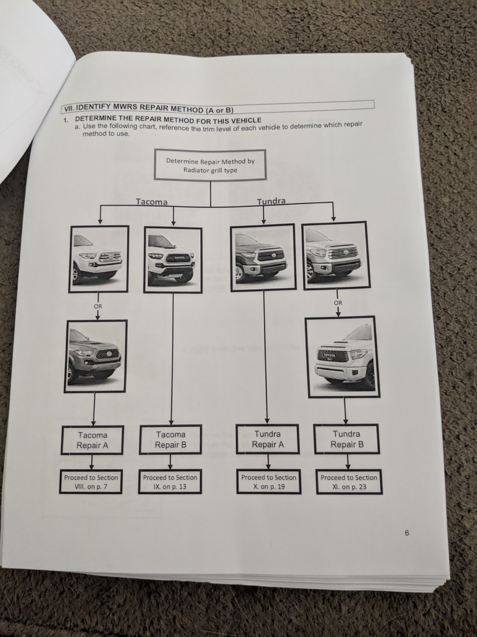

    It's like 12 pages. I think you could go to your dealer and get it easier. They're are multiple grills that you do differently.

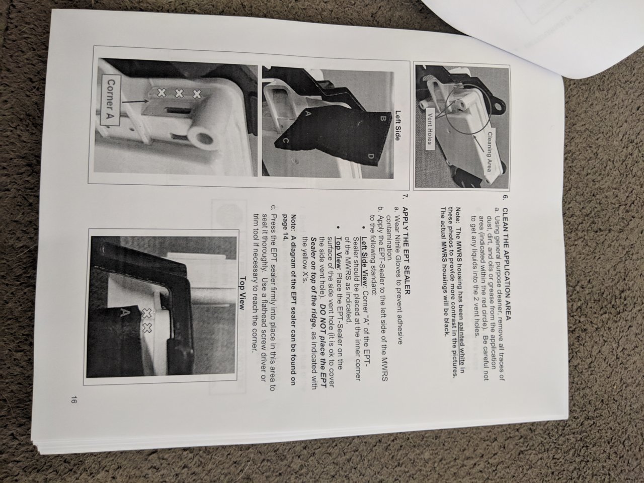

    Correction. It's s 36 page novel

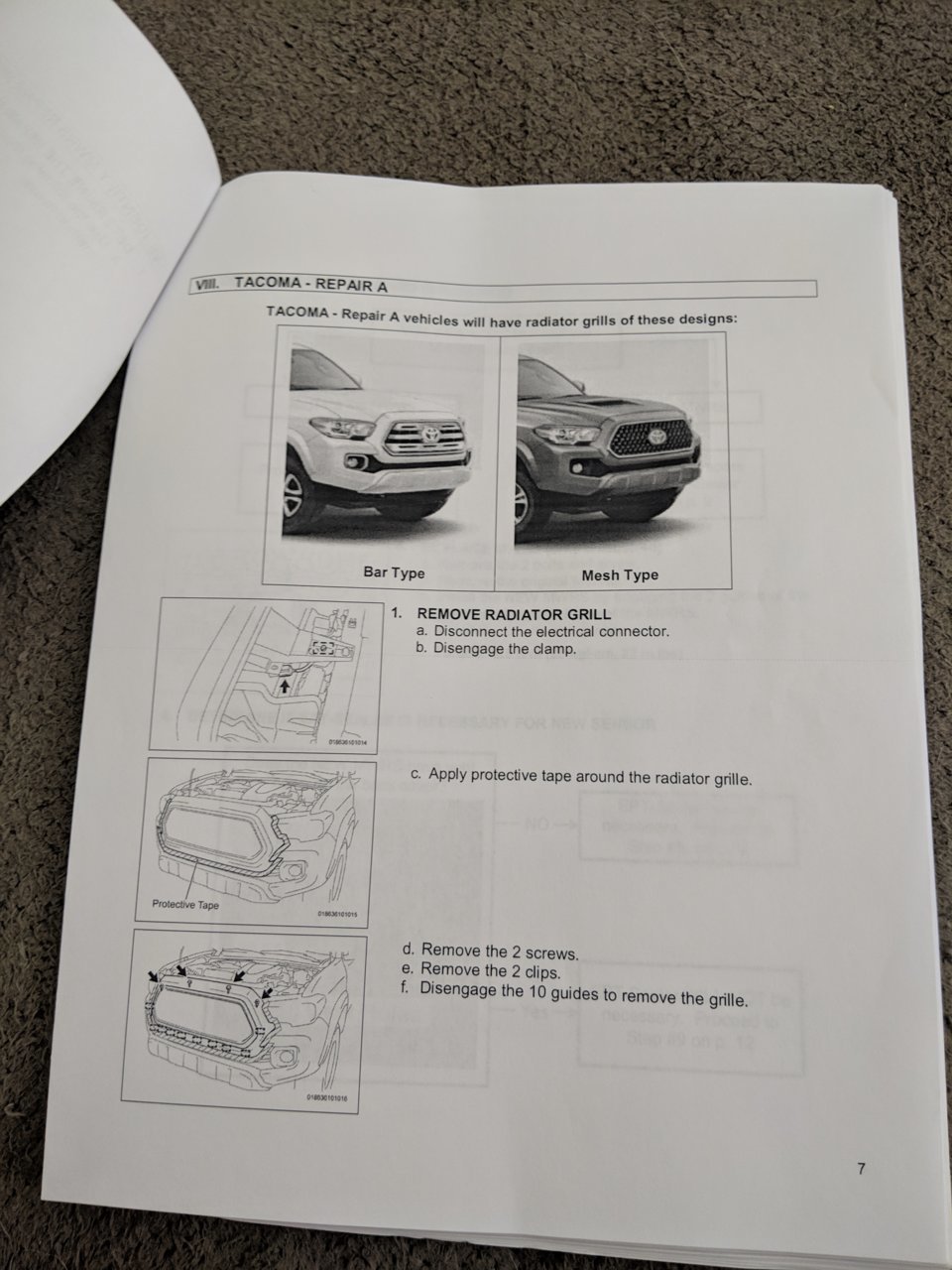

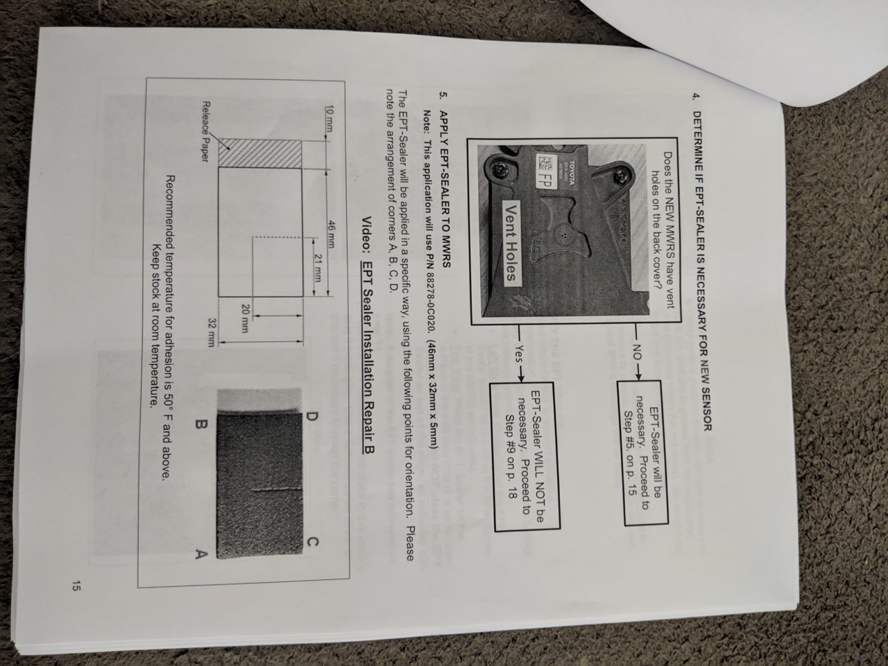

    Here's some. IMG_20190410_161234.jpg IMG_20190410_161234.jpg IMG_20190410_161248.jpg

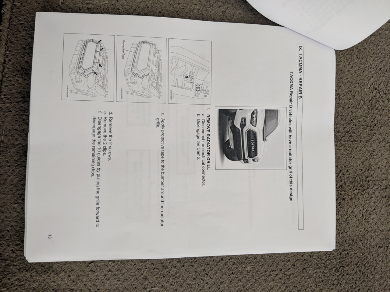

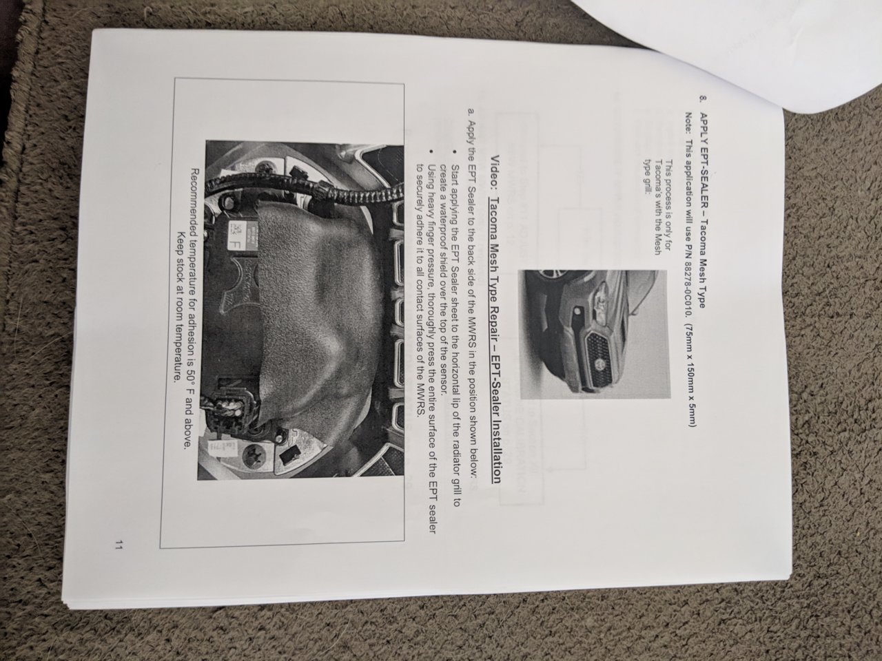

    Any specific info you guys need off this , let me know. You guys are welcome.

    Thank you @Tacosrus it looks like they got mine pretty close to right, but not 100 percent. I may go see if I can make it look like the pictures in the document, or I may have to just buy the cushion and re do it myself.

    Reading thru the instructions it looks like if your sensor is vented you don't need the foam sealant. My SR5 sensor was not vented so I put the sealant on like a regular grill has even though I have the Pro Grill.
