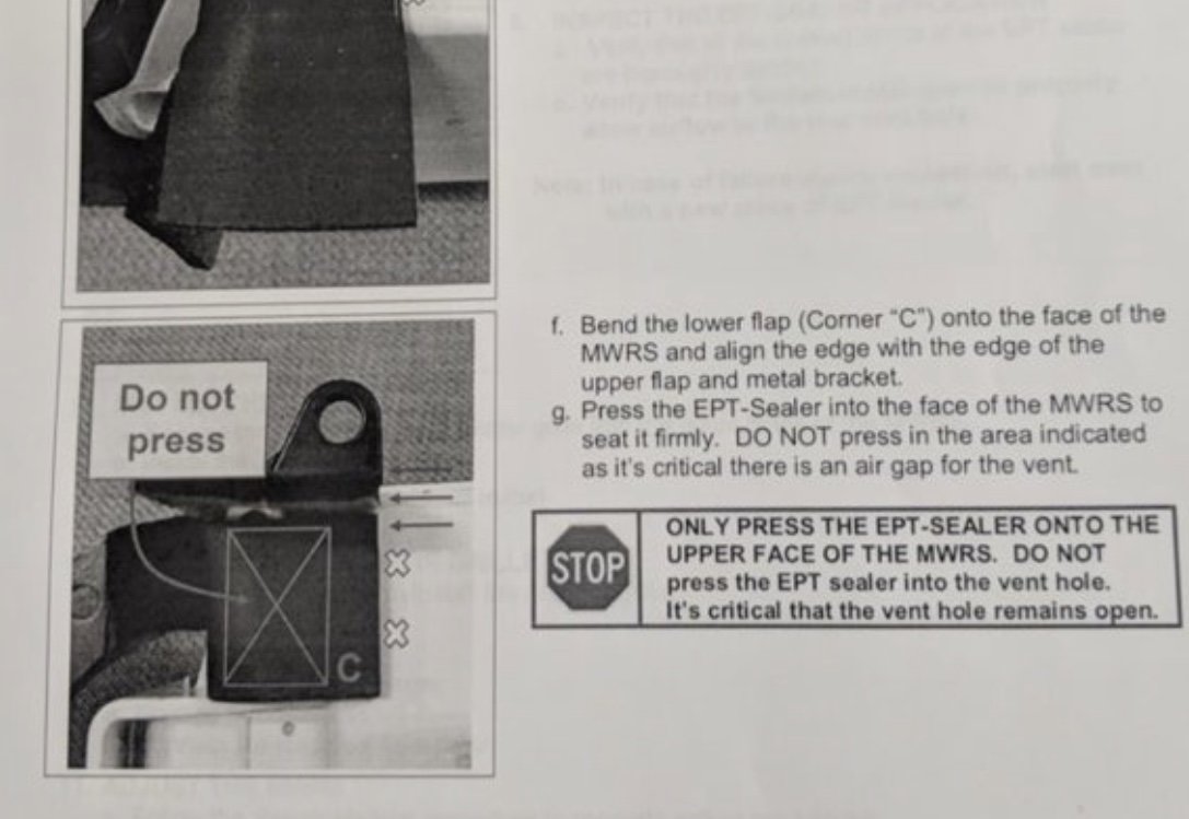

    Sticks about like Wrigley's Too .
    Pretty high tech right.

    Exactly......it is kinda more like a bandaid.

    I’m not surprised. Like what are the chances that slapping on a square of folded gummy tape with some random gap for ventilation is actually going to work long term? Like your life depends on a wad of tape? Is the Toyota tech applying the tape wad now responsible for your life? Doesn’t sound very “Toyota” to me.

    So I took mine in 40 minutes ago and just got a call that it is ready.
    Conversation with service manager:
    SM- "we can't do all of the recall on a truck that has been lifted or modified with bigger tires."
    Me- "why not? It was just putting a seal on the radar to keep water out, right?"
    SM- "well we couldn't do the calibration because the truck being taller throws it out of the parameters"
    Me- "but did you put the seal on the radar?"
    SM- "Yes."
    Me- "so should my truck be safe from just slamming on its breaks randomly driving down the road?"
    SM- "Yes."
    I have a 1.1" level in the front on 265/75/16s. I'm not sure why it would be so difficult to calibrate the radar for the adjusted height, but it is what it is. I am happy with the seal and will just dial down the range on the radar to compensate.

    I wonder why you didn’t get the cushion.

    My instructions day that if you have a Sensor that is vented , 3 little holes in the back that you can see you don't need it.

    If Toyota won't do the the recall they will turn off the system at owners expense. That came from the service manager.

    They actually didn’t do anything. They said Toyota told them that they can’t touch this recall on “modified” vehicles..
