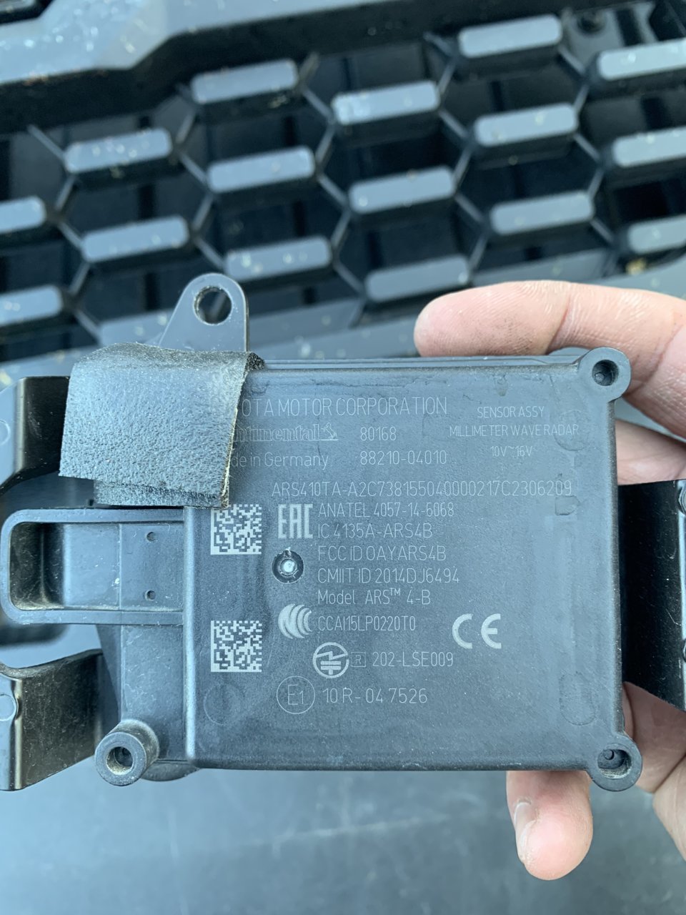

    ricepicker89
    ricepicker89 Member
    Nov 17, 2018
    #273002
    9
    2018 Tacoma TRD off Road
    That’s what they did for my recall, had to reinstall the oem grille for them to do it.
    Update:
    First picture was before I had to reinstall my oem grille which they did a small tape and 2nd was after I installed the oem and toon it back for the recall “Fix”.
    TRDPro916, payrow and jamesfishn09 like this.

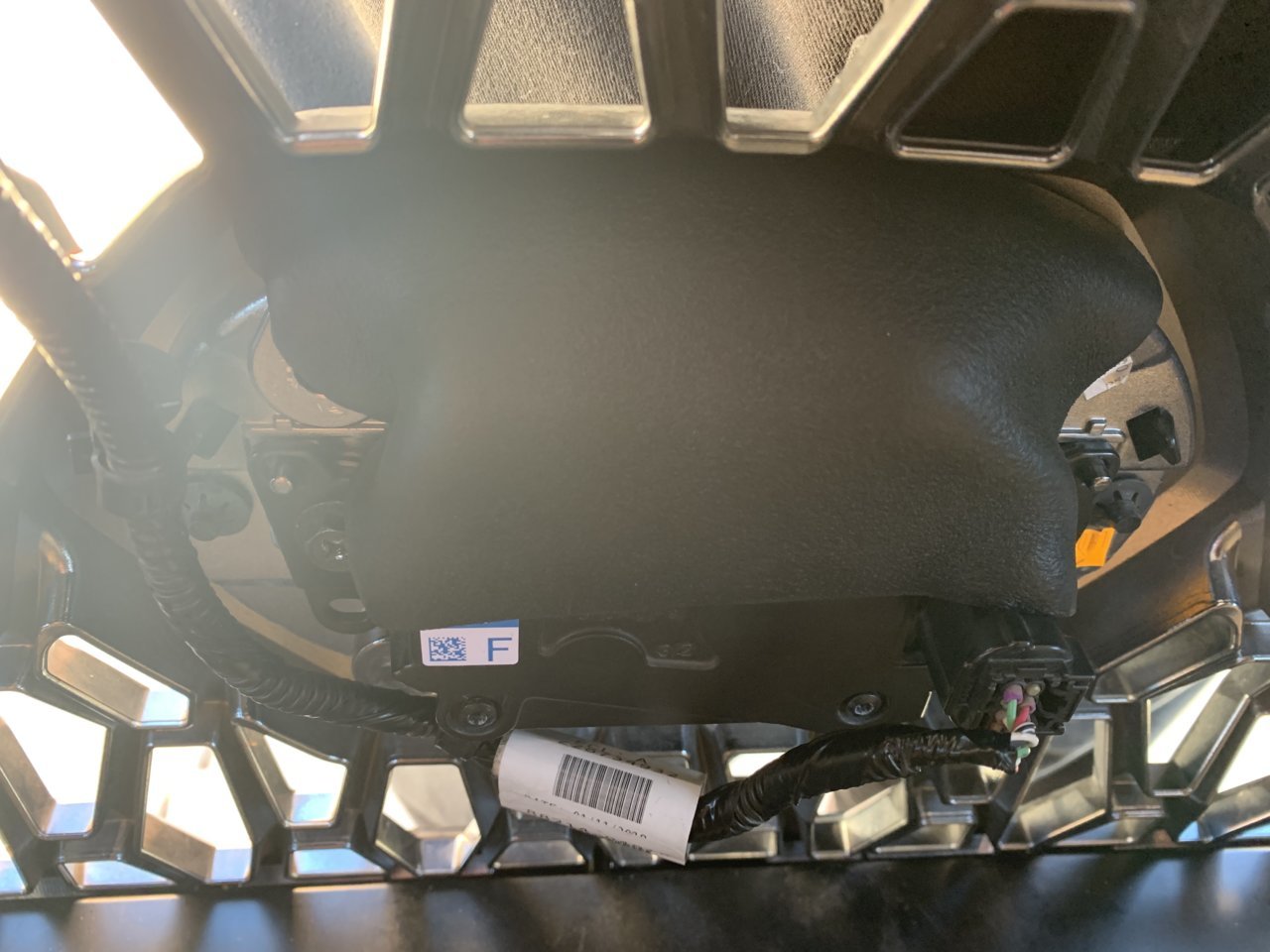

    payrow
    payrow Well-Known Member
    Aug 8, 2009
    #20858
    500
    Los Santos
    '18 DCSB Sport
    Which stock grill do you have? Is it like this one?

    payrow
    Aug 8, 2009
    #20858
    500
    Los Santos
    '18 DCSB Sport
    We have the same grill, but different 'fixes'. They put the cushion along the back side of my radar unit.
    Also noticed that in the fix instructions there is a picture of a radar unit with the letters FP on it. Mine only has the F - what's on yours?
