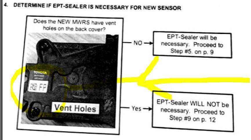

    I noticed that in the fix paperwork the radar unit has an FP on the sticker in the back. So far all the radar units in this post have had only the F on the back - I wonder if that is a picture of the new updated radar unit...can someone with a 2019 that is in the clear post a picture of the back side of their unit please...wondering if it will have the FP on it instead of just the F.
    Seems to me like the NEW version of the radar unit comes WITH 3 small vent holes...too small for water intrusion...:notsure:

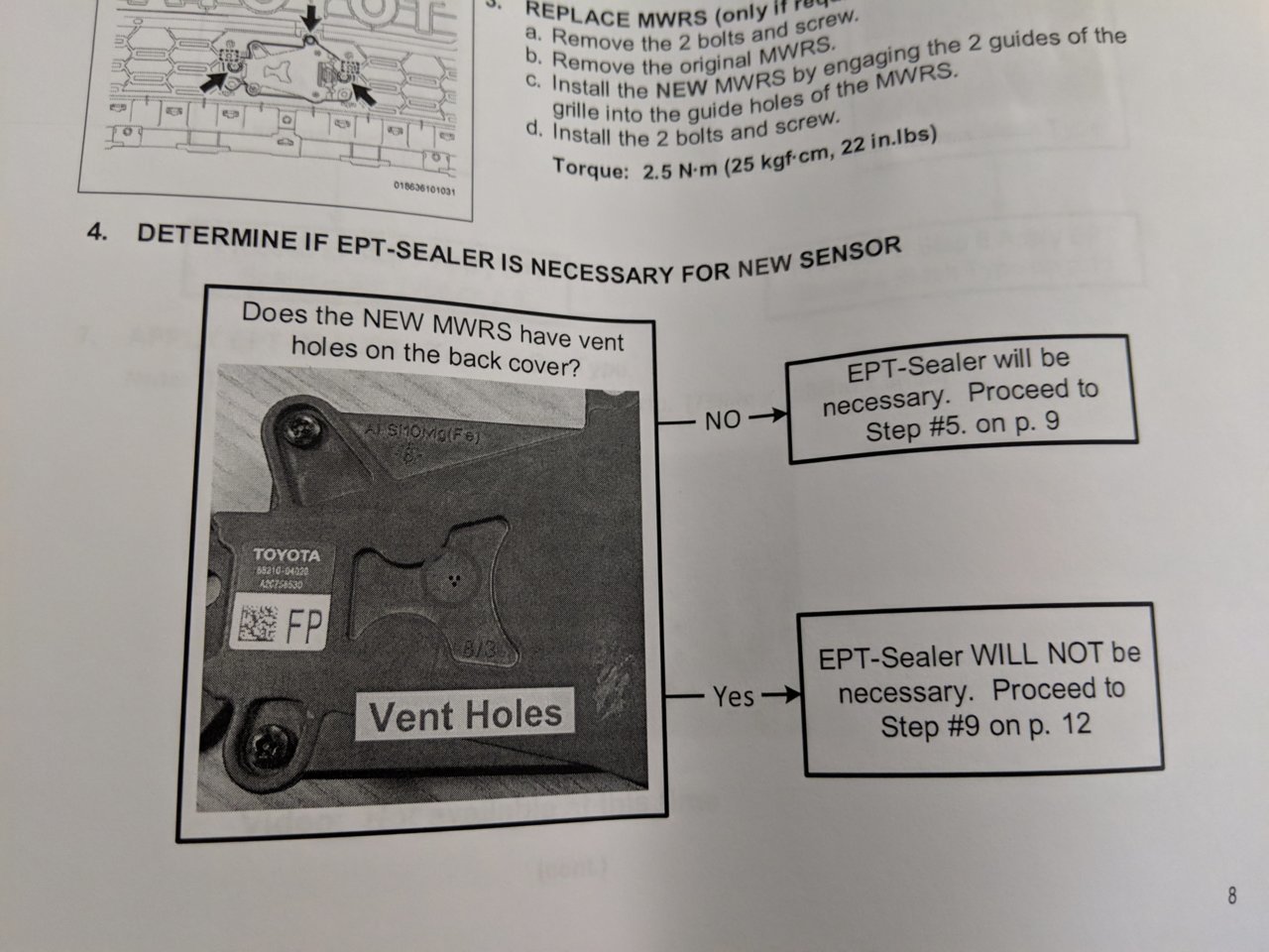

    I have a 2019 (10/18 build date) with an "F" only. I am on the recall.

    Thank you, but I have that page. What I am asking for is anyone with a 2019 with TSS and NOT ON THE RECALL could you please take a picture of the back of your radar unit and post it. I want to know if the FP radar unit in the picture is the NEW IMPROVED version. If you have only an F on the back, it is more than likely your truck IS part of the recall....
