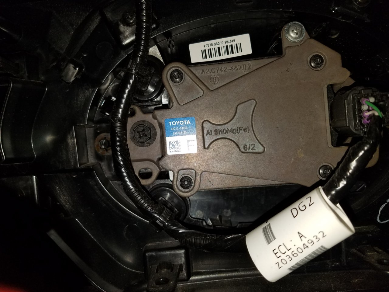

    I Have a 2019 SR........ let me run down and snap a pic
    Mine has the "F" but when I entered my Vin # on their page, came up clean

    Well, so much for that theory...Thanks for posting a picture of it. Only difference I notice is it seems to be a different color than mine. And I do not see any VENT holes like the one depicted in the repair instructions. It does however have the same part number 88210-04010 :notsure:
