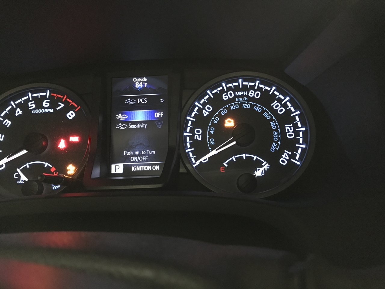

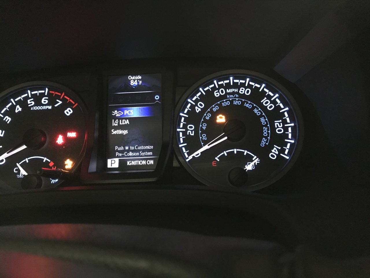

    963630B2-3D5D-42AC-82C2-CB50F9A6ABF3.jpg 47C360FA-9324-4235-BE57-BCEA13BC3DC9.jpg
    Go to SETTINGS (the gear) on far right, then go to PCS and you can toggle on or off with the center button on steering wheel. Hope this helps!
    It does NOT cycle back on with every start! It’s off permanently, you will just have the little PCS OFF light to the right of the temp gauge on all the time.

    It does reset back to on on my 2019 after shutting the truck off and restarting it. So maybe something changed with either the 2019 model or the software update they did

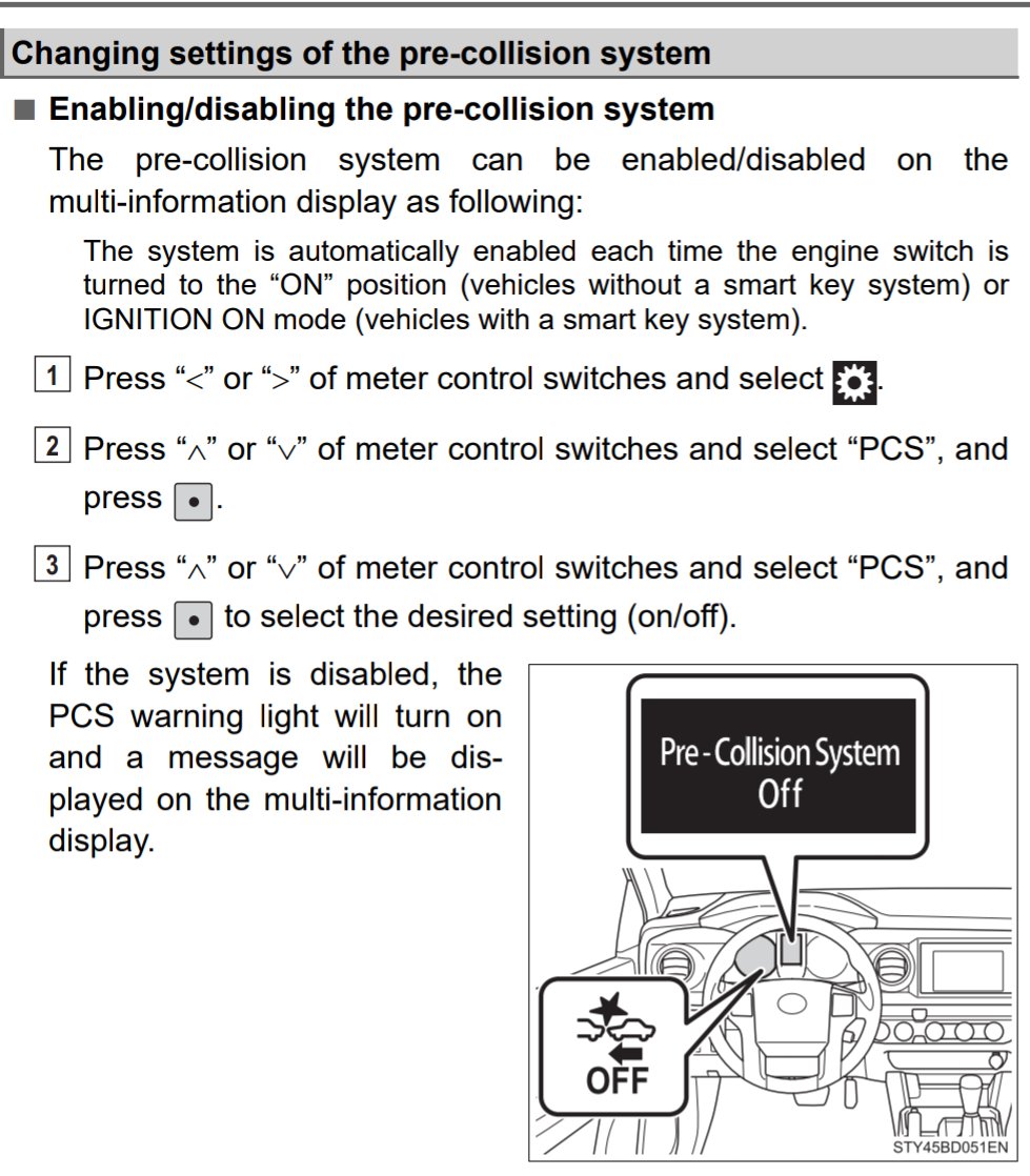

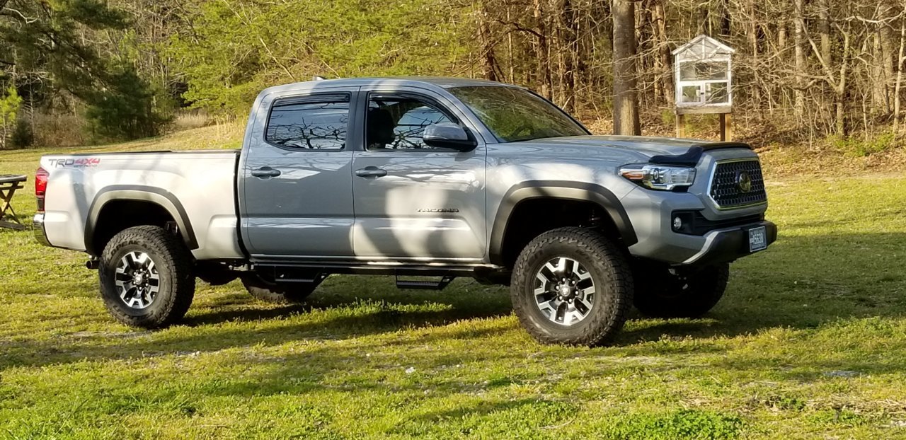

    I was pretty sure when I turned it off once, it came back on the next time I started the truck. I'm going to check this out today. In the meantime, it actually says in the manual that it enables when the vehicle is restarted.
    You got a Unicorn maybe.
    Edit: I just tested this and when I stopped at the store, got back in and started the truck up again, the PCS was back to enabled, no off light.
