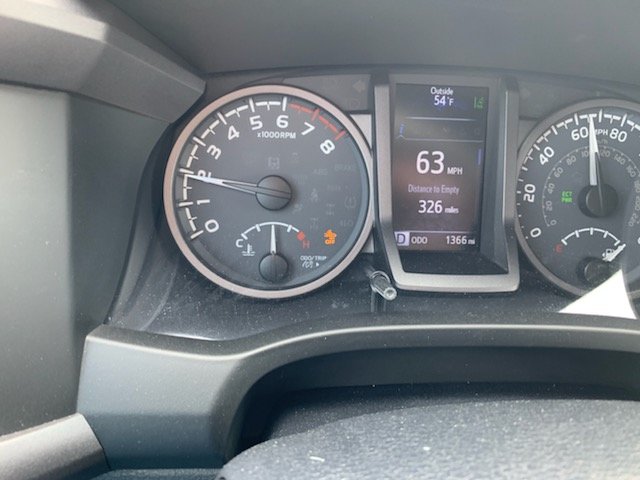

    So, my wife took my 2018 OR over to the dealership for the 15K mile service last week, and they also performed this new recall for the pre-collision sensor and software update.
    I have a PRO grille on there, which the same dealer installed. And they calibrated a pro sensor on it last year. It worked fine as far as I could tell. Until now. Now, after this "update," there is a constant warning message on my center multi-function display indicating a pre-collision system malfunction. Wife noticed immediately when getting in the truck last week, and mentioned the new problem before she drove off but didn't have time to stick around for them to diagnose any further. So I brought it back today and pow-wowed with the service manager there to try to get this resolved. We thought they could just turn off the system (which I don't rely on anyway), and I could sign the bullshit paperwork yada yada. So after an hour of sitting in the waiting room there, while service manager was on the phone with his Toyota rep and trying to have his most senior technician try to turn off all these warnings, I left disappointed with a series of apologies from him and him being ashamed and frustrated that they had no options left it seemed. I have a PRO sensor behind the grill, but the issue seems to be that the software update to the "module" of the computer system tightened the tolerances for the sensor so that it just will not work, setting off these error messages. They were able to turn the PCS to "off," but I am now, it seems, stuck for the rest of my owning this 15K mile truck with the warning between the gauges that can't be shut off, and a flashing "PCS off" indicator on the Tach, and a solid warning light on the speedometer. I feel really discouraged and disappointed, but I'm not going back to the stock grille. I think it looks shitty and I also already spent $700 on this pro grill and install last year. The only other potential fix this service manager is going to look into further for me is to see if we can swap out this module for a PRO spec module, to interface properly with the PRO front sensor which I have. But he didn't seem too optimistic after talking with his rep from Toyota today. And it doesn't sound like the OR model's sensor will work with this grille because it's in a different location, a few inches higher or lower or something.
    So, am I missing anything here as to how to remedy this situation, or am I stuck with looking at this (see below pic) for the rest of my time driving this truck?
    Frustrated and pissed off and annoyed. Wish I could rewind and never have let them do this recall bullshit.
    I've read through this entire thread now and it's even more frustrating that no one else seems to have the same issue I'm dealing with now.
