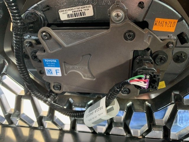

    I brought mine in and told me "your truck is a special case..." but they performed the recall anyway. Then when I looked at the sensor it was still covered in dust, never removed, no foam cover. I opened a case with Toyota corporate to address it. The kicker is in my paperwork and on the customer portal my VIN lists as the recall performed, but the service adviser couldn't tell me exactly what was done. I don't care if it was done or not, I just want clarification and not to be lied to that it was done when it wasn't.

    So it looks like for those dealerships that will do the recall with grille swaps, it's the "Repair B." Every model but the Pro gets the full 6" x 6" sheet covering the back of the sensor, because so much of it is exposed. Because the Pro grille locates the sensor in a pocket, they can get away with a small strip over one of the top corners where the vent is. That's why it looks like it was never touched. I can get into the technician vs front of house dynamic later for those that don't understand it. Because the service writer didn't know how the repair was done or was willing to provide a a shred assistance finding out, I immediately jumped to the worst case scenario and assumed the recall wasn't performed. Their lack of help answering my question was what set me off. Koons in Westminster, MD is still the worst dealer I've had to deal with. Nothing can change that.
    Now all that left is to go into the dealer tomorrow and meet with the service manager and eat a huge bowl of crow.
