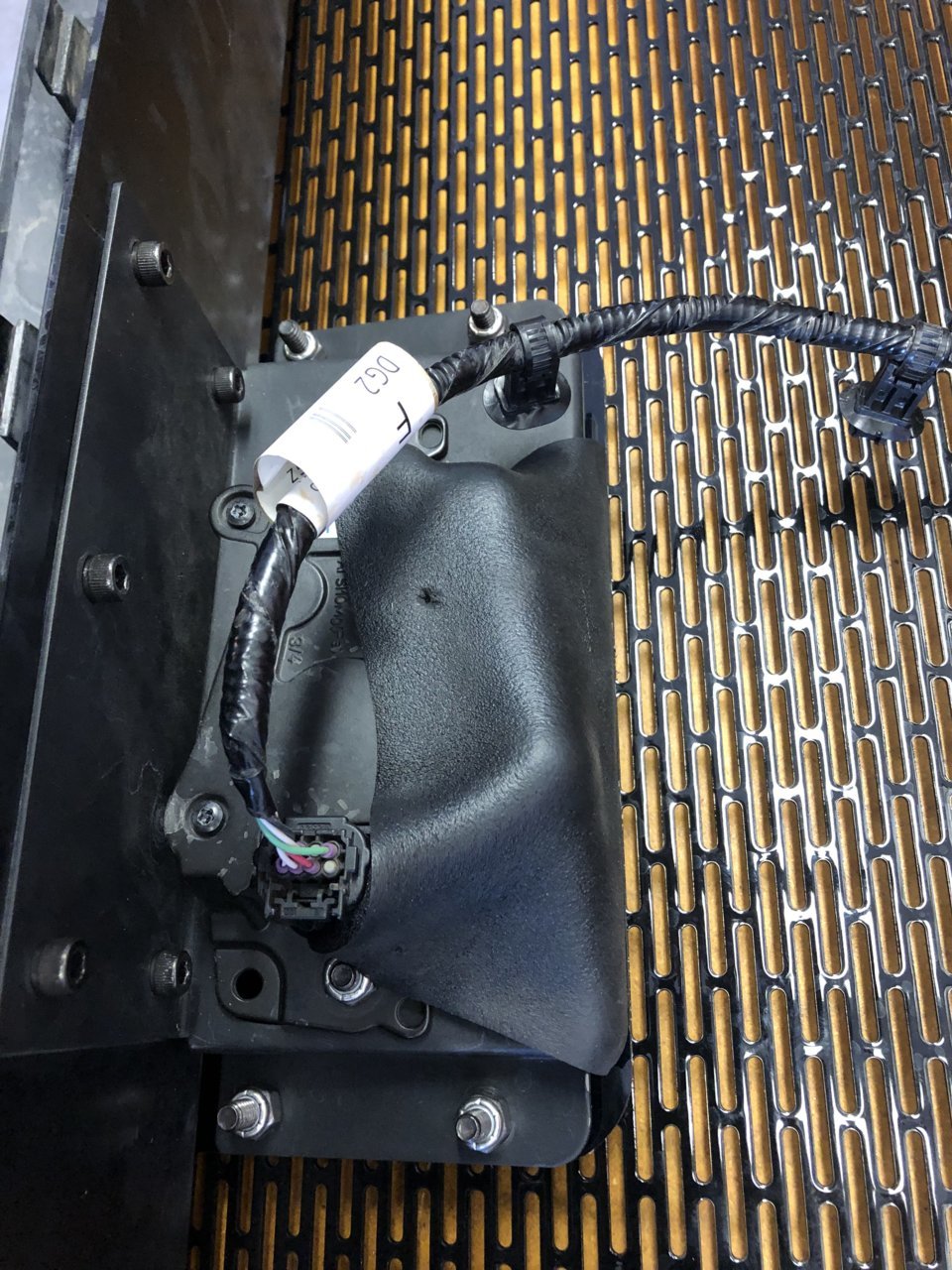

    That isn't even installed correctly. The repair instructions speecifically have it covering the sensor and not the wiring harness like that. The instructions have lots of pictures and they messed that up. As the other person commented that just allows water under the foam defeating the purpose.

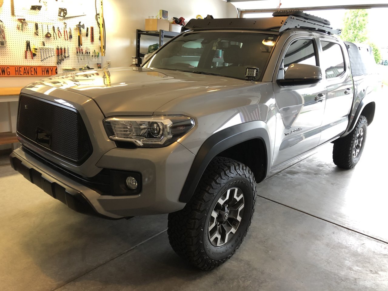

    So I went in for the dreaded recall. Took off my custom car grill back to stock. But I do have a lift. And I do have bigger tires. They made me sign the waiver and offered to turn off The pre collision system but said you will see a yellow emblem on the dash telling you it is off. But in the settings of the software they can have the truck remember the setting without turning back on after each start up. Wasn’t crazy about seeing the light so told them to leave it on and if there is an issue I will come back to have them shut it off through the software. I came home right after the recall (cushion fix with software update) I put my custom car grill on immediately while the adhesive was still sticky so I could re use the bubble gum fix. Now it’s on my bracket from custom car grills. Just went for a test ride and all seems to be working fine. Including adaptive cruise control. I turned down the sensitivity of the pre collision just in case but it feels like it was working just like before without issue, except the recall is done, software updated, and cushion on. If it acts up I can always go in and have them turn it off where it won’t come on automatically. Side note this aftermarket grill has to let in less water I would think.1D72D8DB-6AA7-4786-9C01-FC1A60A5D048.jpg 79C575EC-AF81-43DE-8988-EC0CA35F074D.jpg
