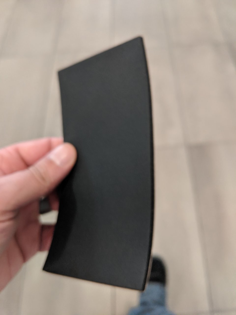

    Post up a picture of it the part... i'm curious to know what it looks like.

    Its this part, its like $10. The dealership wouldnt do the recall because of my tires, and I've only had issues when it rains so I'm just going to do it myself.

    16 dollars out the door for this bad boy

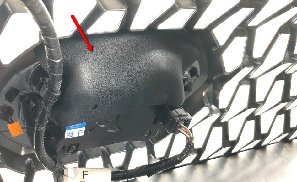

    It is merely a peice of foam tape that covers the inside of the grill emblem and the sensor. I presume it keeps water from getting between the emblem and sensor giving it false readings. I'm doing mine myself.15609672423447106410104911134373.jpg
