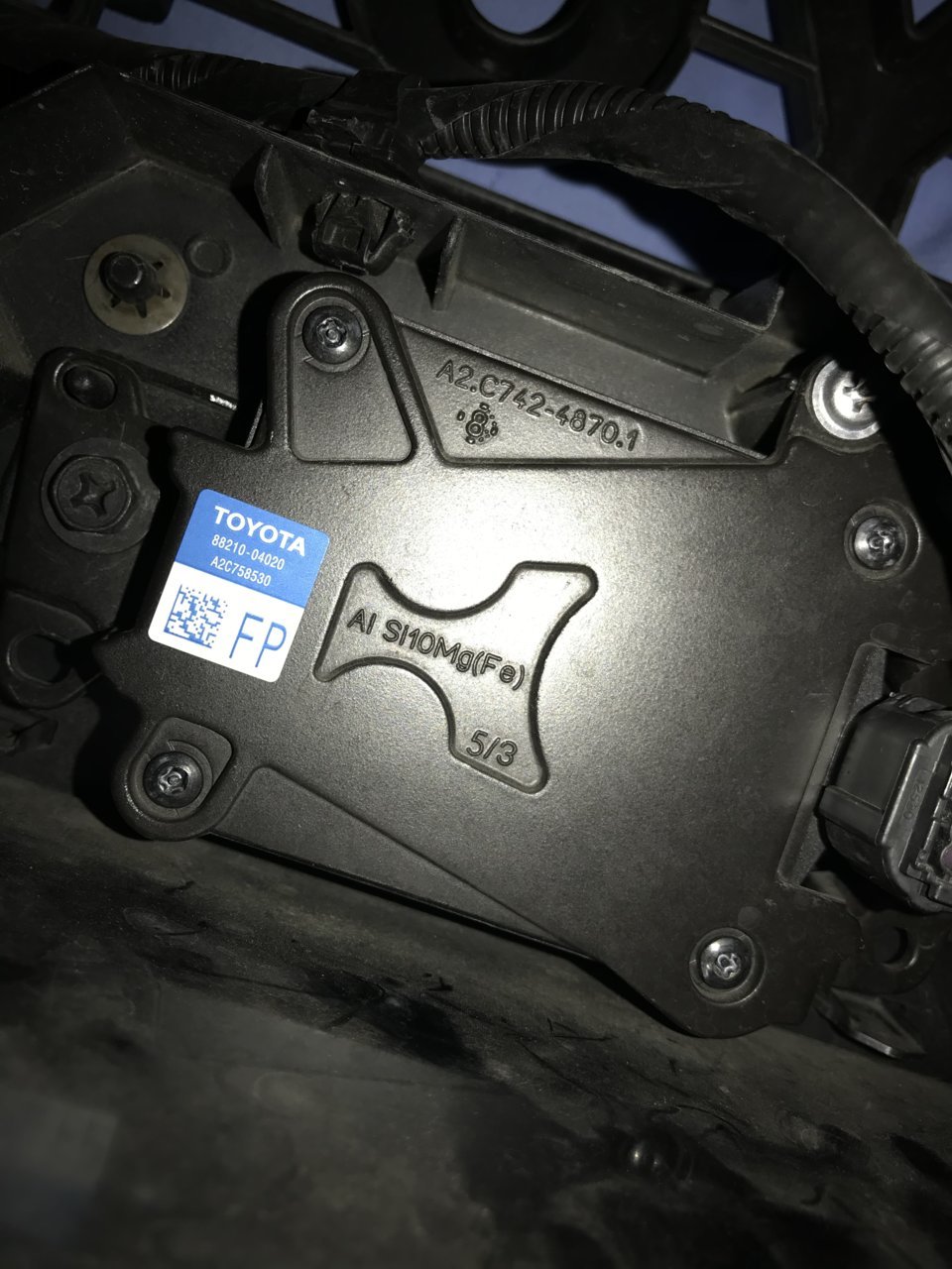

    Just got this done on my ‘19 Pro. Everything is stock. No foam pad is installed on my sensor. It says they performed “Repair B” on the work order. I’m seeing other member’s work order and theirs says “Repair A”. Did they not fully perform this recall?

    '18 DCSB Sport
    Mind posting a picture of the back of your sensor...wondering if it has vent holes on it.

    ‘19 Super White TRD Pro MT
    Here’s a pic after the recall was performed.

    Factory Blackout package, Soft roll up bed cover, Cheap seat covers, Front and rear dash cam, AVS in channel vent visors
    The PRO repair is a bit different. I don't think you can see the foam pad if you have a legit PRO. There is a post in here somewhere where a member posted the repair instructions for each type.
    Starting at post 207 in this thread is the repair instructions.

    '18 DCSB Sport
    No vents. Your patch was applied on the front left side of the sensor. I think I see a little bit of the foam in the picture behind the plug area.
