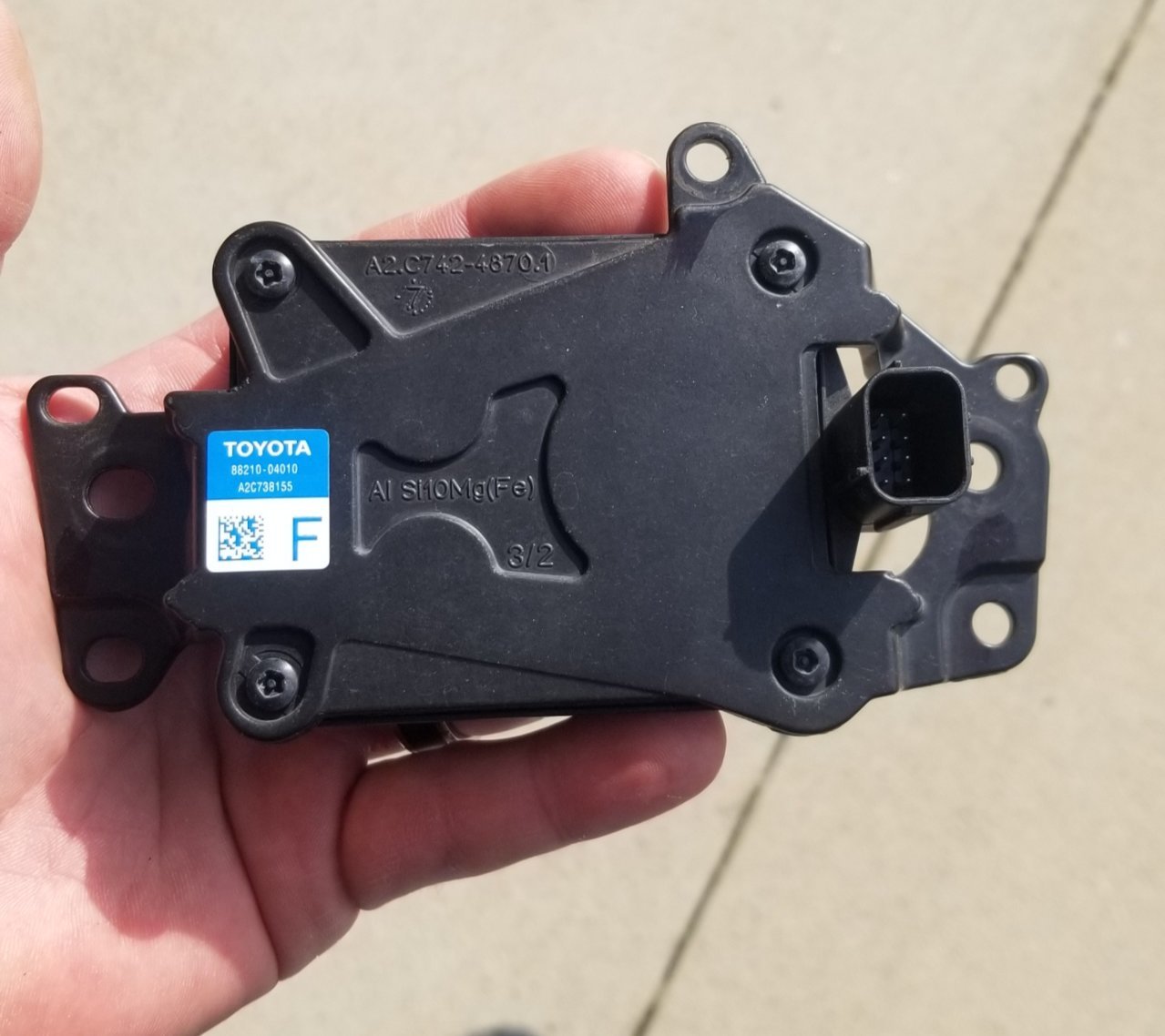

    Hopefully you get the replacement that has the vent holes on the back - it seems to be the improved part which does not need the bogus sticky pad fix done to it. When they do replace it take a look at it, you'll know if it's a updated version if it has 3 small vent holes in the recessed area on the back:

    Thanks for posting that. I had seen that months ago but couldn't remember how the hierarchy thing went for the holes or no holes. Mine doesn't have the holes & I did get the sticky pad umbrella thingy
    Also I think there's different part #'s & someone has posted them but I'm not sure what thread

    Nope. Same part number. I think Toyota Corp is being slick by keeping the same number - my guess is that they never intended on fixing the problem right on vehicles that were susceptible to water intrusion. That's why the repair sheet has the tech look for the vent holes - the radar with the vent holes doesn't risk water intrusion and doesn't get the stupid cushion. Only a reprogram - supposedly. The sheets posted to this forum didn't have the pages listing what else was done in the case the radar unit had the vent holes...
    I think the right thing for them to have done was to REPLACE the problem units - the ones getting this bogus repair. Too bad they took the route they did.

    I don't know for sure but someone posted awhile back that there was 2 part #'s & listed them. Then the troubleshooter shows that the one with holes doesn't get the "cushion" but the ones without do. Doesn't make any sense if they believe that this is the entry point for moisture! Maybe the should put a drain plug in it :rofl:
    Supposed they just flashed new TSB, test drove down the street, called me to say it is working again & to come pick it up. New sensor was supposed to be there but it wasn't & needed to be ordered again. Probably ended up on someone else's truck that had an earlier appt. Oh well :notsure:
