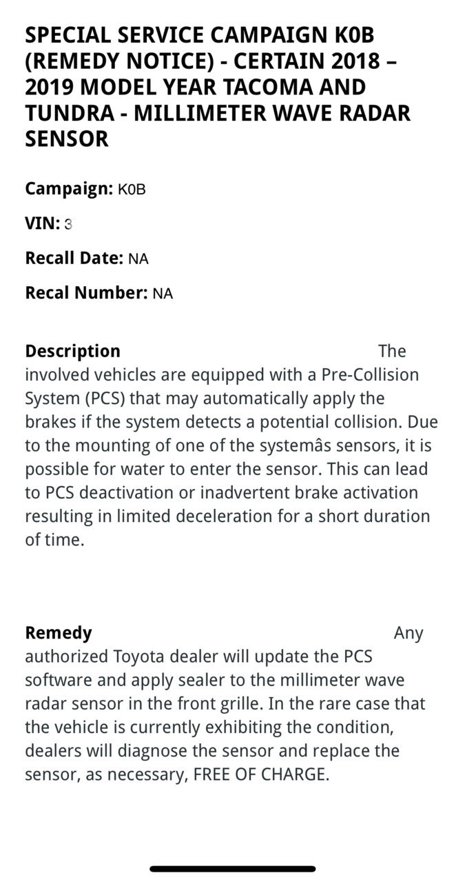

    So to revive this ole thread, got a call from my local toyota, a cold call at that, asking for me to schedule an appointment for an "open recall" to replace the radar sensor. No come in and wed like to look at it. Throughout the message they never refer to is as a service campaign or suggested. Just that it was a recall for the millimeter wave sensor and that it needed to be replaced as soon as possible. Now I have the pro grill and have never had any issues, but has anyone else had this happen? Has the bulletin been upgraded to a full blown recall?
  12. Sep 4, 2019 at 7:38 PM
    #732
    St0rm-Tr00per
    St0rm-Tr00per Well-Known Member
    Sep 7, 2018
    #265560
    1,266
    SoCal
    2018 TRD OR 4X4 DCLB - Super White
    “Semi-Pro”/“PrOff-Road”
    I just checked the Toyota Owners app and it looks the same.

    Yea I couldn't find anything online. Just found it odd that my dealer was cold calling to have me come in to replace the sensor
